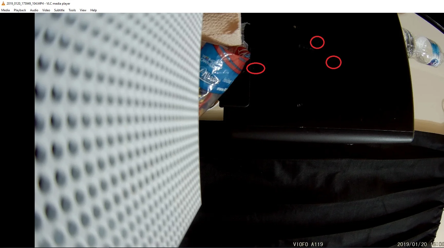

So some testing results of parking mode on my A119:
In my office, pointed at a mixed static scene with lights, the camera connected to a 10000mah QuickCharge 2.0 Powerbank, the camera recorded 99 clips with zero clips in Parking mode 5fps from 4:30pm to 9:45pm.
I verified parking mode with 5fps is selected. I also watched it for awhile and could see it change from the Red record LED to the Green power LED for parking mode, then switch back to Red...Again, there was no movement, no change in lighting, I have black curtains blocking light from the windows as well.
The static scene does have a good amount of black in it and I noticed maybe 3 pixels that were flicking in the video, I'm thinking they are bad photocells on the sensor and the flickering is causing the camera tor pick it up as movement...
I'm sending this to camera to OCD for repair and focus adjustments, I"ll share my experience with them.
Here's a picture of the mixed static scene, I've circled the flicking pixels:
What resolutions do you use? Unfortunately all resolutions which are lower than native 1440p have hot pixels. Sometime a lot, sometime a few.
