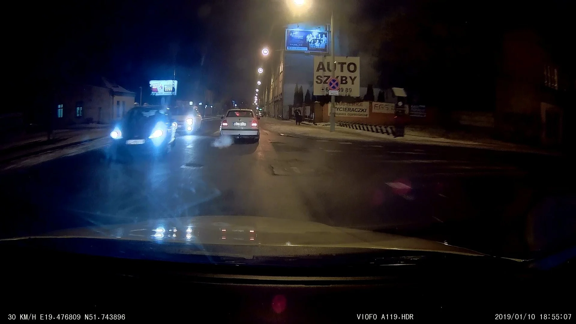

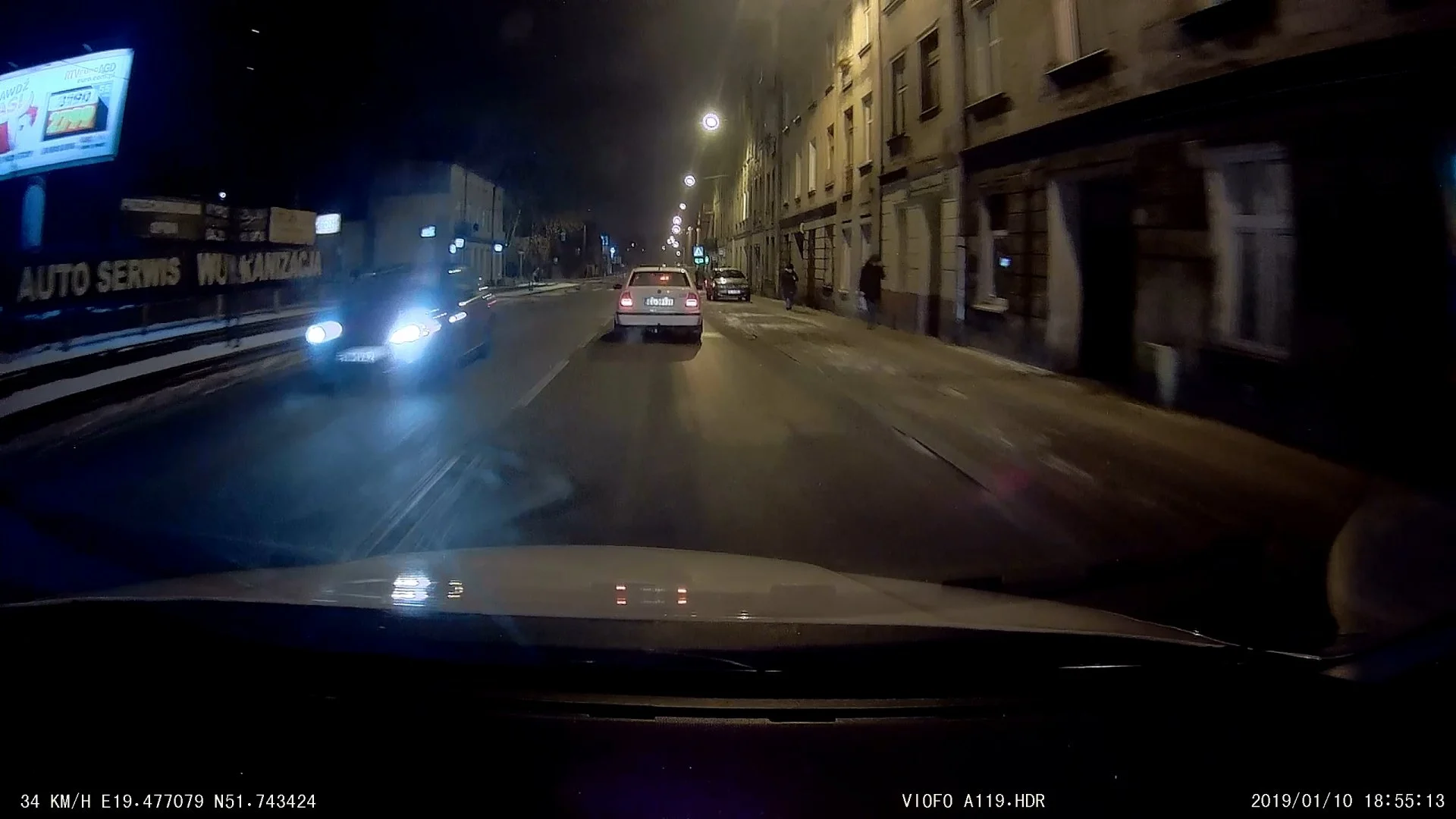

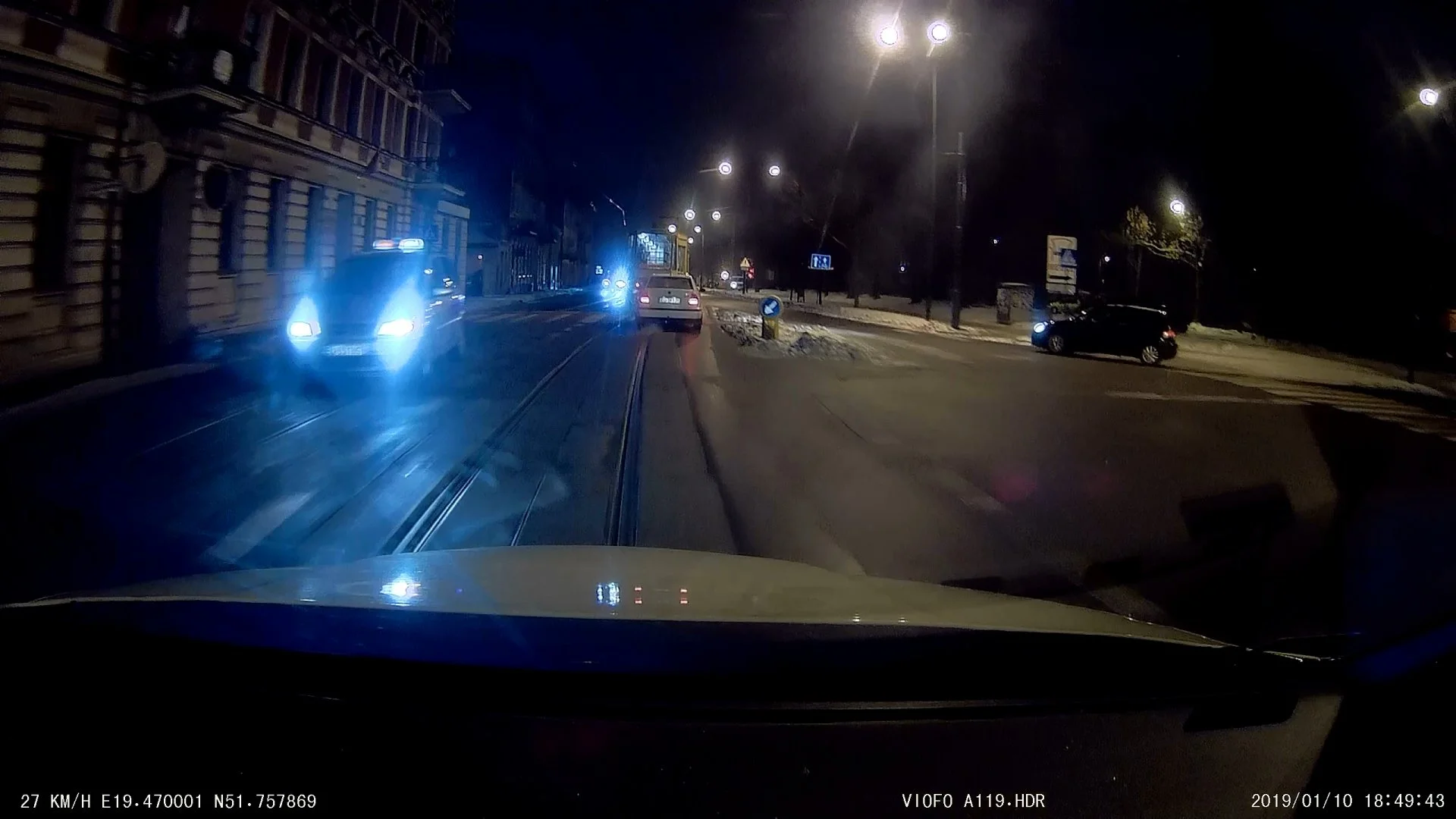

it's all about the plates 🙂 let me ask you something.. 🙂 how are you gonna find a guy that hit your car if you dont capture the plate? 😉

If you want read plates at night ask the on coming driver to turn off his head lights because it is the brightness of the on coming traffic that is the problem. Automatic exposure does it's best. With the darkness and bright headlights it focuses on the head lights (the brightest light) at the loss of detail of the plates. Even with night vision the head lights would burn out the scene. All dashcams have a similar problem. If you try to compensate by changing EV values you get too much motion blur which will blur out the plates. Technology needs to change first.
unfortunately a lot of people obsess over trying to read licence plates of vehicles that are nowhere near enough to ever be in an accident with anyway
I don't know how the Auto Exposure works in dashcams, but I'd think that it could be similar to still cameras & with all the bright lights facing the AE sensor & reflective surfaces, there are an incredible number of influences to achieving correct exposure for all tonal ranges from near black to bright white. Even RAW DSLR HR files cannot always bring back blown highlights & dash cam files are certainly NOT high dynamic range sensors capturing raw data, but rather outputting processed image files. One reason why in difficult or certain lighting conditions, photographers will change to Manual or locked in exposure settings when one is found to be correct, vs. having the AE be influenced by tones, colours & changing lighting, both reflective & incident.
I'd think that while the poster that likes HDR & challenges others to accept the screen captures as proof, my experience with auto exposure in cameras would say that these sample png files could show license plates in HDR mode for a whole variety of reasons & I'd be skeptical that HDR software algorithms would be consistent enough to say it is more effective On vs. Off. There are simply too many variables in lights, ambient light, reflected light & reflected surfaces, colours, tonal ranges & many things that I'm not even thinking of right now. And then there is the blur factor in HDR combining images of different exposures, if that is how it is being done.
I would think that the poster was maybe lucky or HDR works good enough in THAT particular situation. Try 1-5 hours later, on a clear night with no clouds out in the country or on a hightway with no moon light nor buildings or water on the road to reflect or increase ambient light & or with many different types of license plate materials from all over the world, because license plates sure don't look the same world wide. Really stringent testing would need to be done to say that it works or not & to what percentage of the time that it works & at what ambient & reflected light levels vs. HDR Off.
Very hard to say something is Fact without a huge amount of testing data trying to prove & to disprove the effectiveness, with zero bias before during or after the tests, though some politicians & conspiracy theorists have no problem doing so.
So if it works for you great, keep using it & get a feel for how often it works, but as others point out, it hasn't worked for them, so in the end, whose right? 3-4 files don't prove it works everywhere all the time in all situations in all lighting conditions, etc... It's just not enough data to be 100% right. The more tests that you can do & provide results for in various lighting conditions over time of days, weeks, months in all seasons, vs. just one evening, would provide more data. I look forward to seeing all your hundreds or thousands of image test results. Could be a fun project.
That comment wasn't targeted at you in particular, not having a go at you, it's a common thing that people complain about, quite often the expectations are unrealistic
