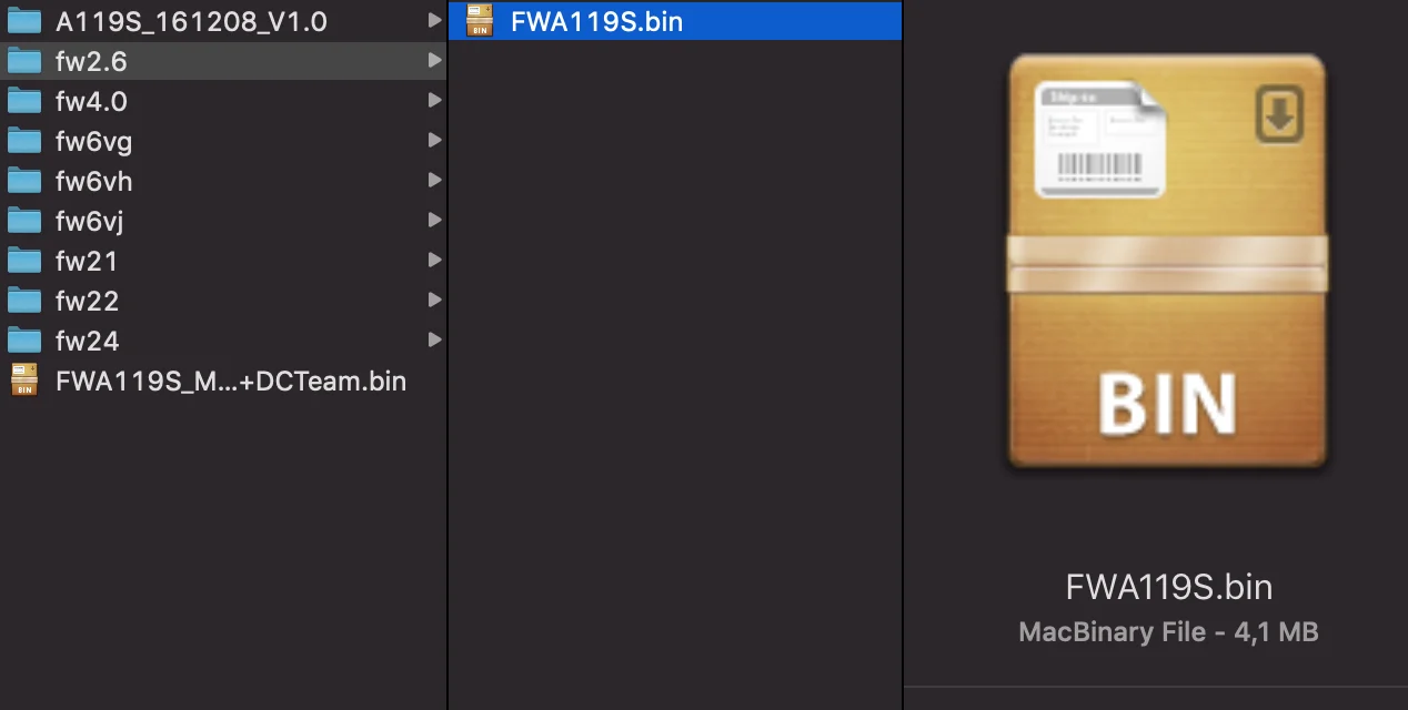

No , still the same
Try FWA119.bin
Try FWA119.bin
Are you using a MAC or PC to copy the file to the card? Are you using a card reader to copy the file or plugging the A119S into your computer?No , still the same
I knowFormat the card with the camera and copy only the fw. The name of the fw must be always FWA119S.bin
Have you ever updated the camera in the past?I know
Have you ever updated the camera in the past? yes
tried thatTry other memory card, it must work
What do you mean by "simply wants to format as soon as cam boots up". Are you saying the camera boots up and immediately asks to format the card?Tried downloading 2.61 / 4.0 and neither update my firmware , inserted ( another 3 ) cards , simply wants to format as soon as cam boots up . thats it !
Current cam firmware is actually 2.4
What size and brand card?Boots up and states you must format the card before use . When formatted within the camera again then file added again , it then just boots as normal and starts recording totally bypassing the update firmware .. simply not reading it I'm guessing and carrying on ..
Understood. I would still use the GUI Format tool and copy the file to the card right after using the GUI tool. There seems to be something odd about the card with the .bin file on it if the camera asks to format when you copy the file to it.Just to clarify... The camera works perfectly with the cards , it simply will not update firmware. Off the top of my head I can't remember the card make bit it's one of the recommended ones.. Samsung 128gb. And several others I've attempted to add the firmware
