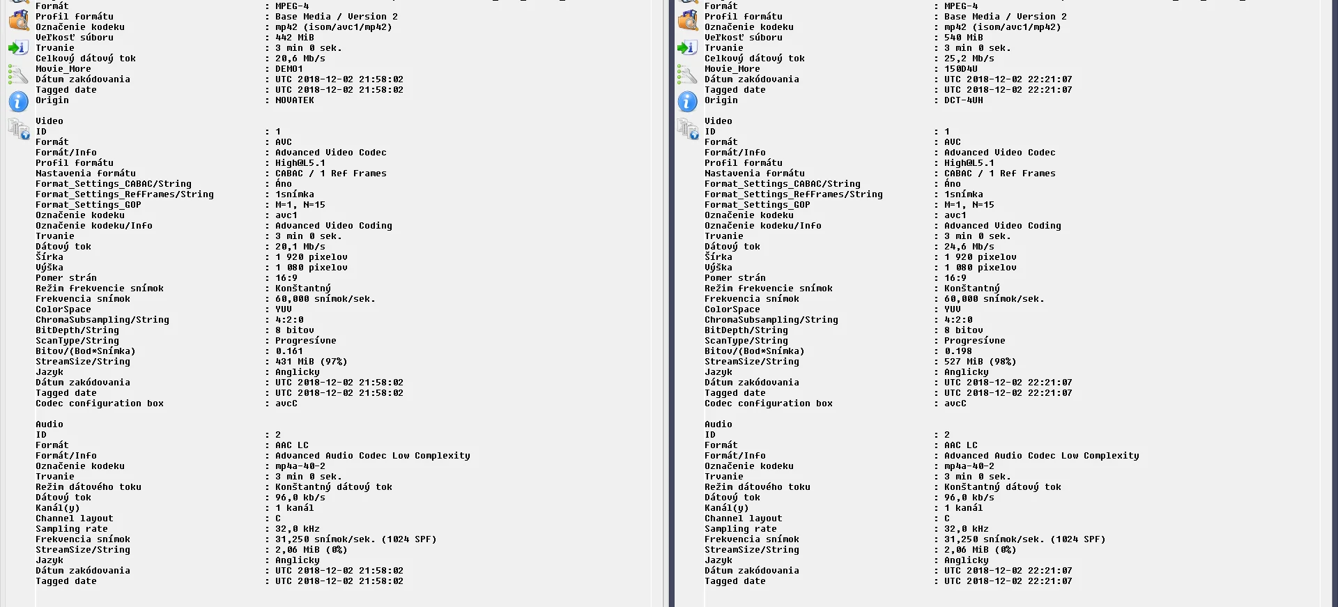

The increase in bitrate for dual cam setup is amazing news! I hope the Samsung EVO card can handle the increased bitrate (L.E. - The SpeedOut application measured 88 MB/sec read and 84 MB/sec write so it should be fine).
Just one question - according to the specs for 4Uj Dual cam, Bit Rate High is lower than Bit Rate Low for front cam. Is that a typo?

There should be a noticeable difference in image quality from 16Mbs Front to 24Mbs driving in Nature Park setting, verify the MP4 video file properties.
