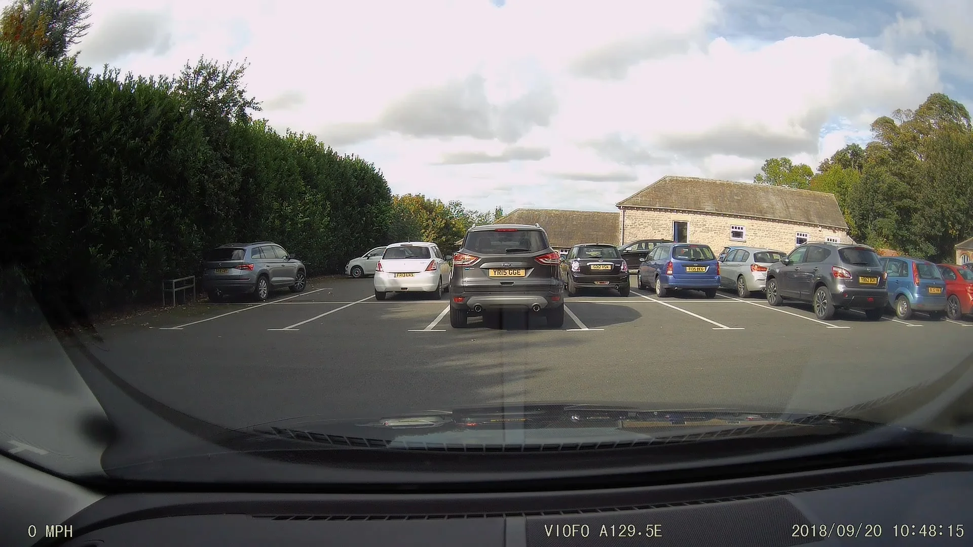

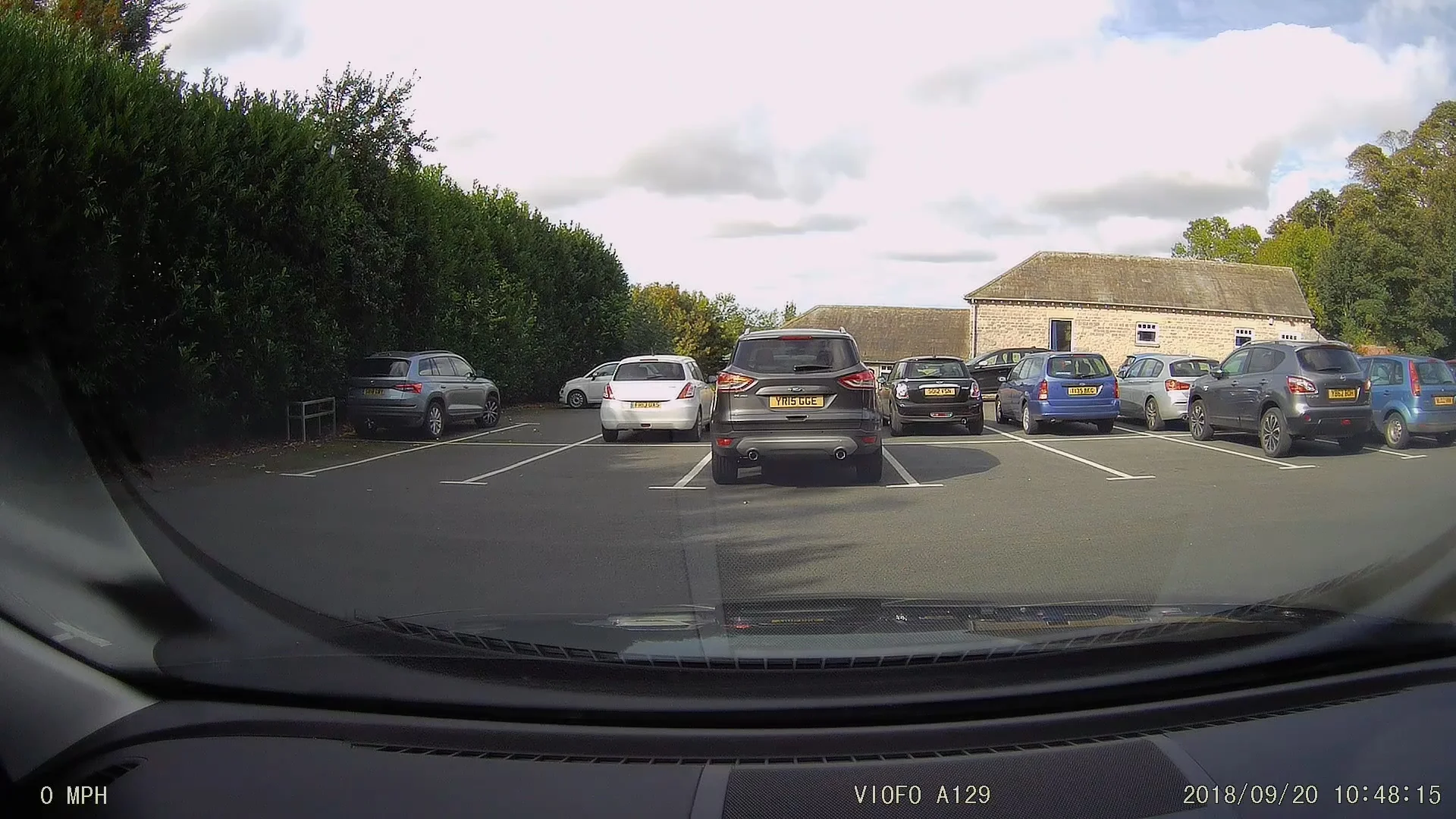

A129 x2 ready for testing:
A129 beta test hardware - running FWA129_MOD-5E_v1.42+25Mbps+Sharp34+Edge178+Satg+DCTEAM
A129 retail hardware - running beta parking mode firmware
y4mO5nqIq9yRR6S5H5pYs9BbSKchrXZflyU8qjdGlqHq9kWWkjSyz9cpyQ-RXsI4Pwi3YEI0KSW9tW2fEfSkksMnyerrQEzgtBR2AbcQ9R7iXvkLcAvGb2E8XFDW9pb9mlEKzwYETV6t-EzTBkLBeZcwo4W__QeKi34sC3Vjxc1-w5OCSGudYl_ht0IVaWlBEJIPaYCUCPdfnVW8-VAUeHtPQ
y4mS_m4lDJkyaWmO3a-RgesOfjwHykviGCTRcoLyCWUx65R4tv6bbOGDbt0PSyFDXEsN_iWje4O1DsB_i8xd5poysjprlxNfjbXLv-mwe6sq5Izs4B5tkFrKkEdMUZGzajdTCFWNPEbZTuN7jKHMgu84PcefZqkuUyYLVqO8ZXclTVsAgcZN70oz9Y0_n5a0iGe8iHzd-6rS76vtHAQiCNEJQ
Initial findings of MOD-5E, compared to current beta parking FW:
- Bitrate still at 16.4Mbps when set to HIGH
- Reduced sharpness is a small improvement. Less halos. Better definition of fine details.
- Camera did not enter timelapse parking mode automatically
Both cameras 1080p30, HIGH bitrate, no CPL, WDR off, EV+0
I forgot to reset defaults before testing. I will do that next time I'm in the car, if it makes any difference. I also need to align the cameras a bit better.
Nice to have 2 units for a side by side comparison 🙂
