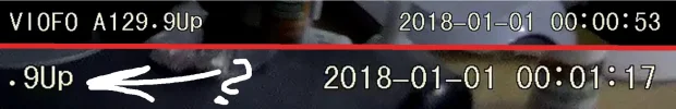

Firmware FWA129_MOD-9Up_v1.50 + 29F + 15RMbs + Enhanced + DCTeam, when the model stamp is off, the tail remains - .9Up
Is it so conceived?
I have corrected! 🙂
Is it so conceived?
I have corrected! 🙂
It'll show up until you turn it off in the menu option...Had same bug...Once you shut it off in menu... Other videos will no longer show it after unit is restarted.
Is it so conceived?
I have corrected! 🙂
The A129 limits the Camera Model Stamp to 10 bytes, my MOD tag exceeds overlay refresh limit.
Workaround is disable Model Stamp then restart dashcam.
Fixed MOD-9Up and will correct remaining Up series tomorrow.
