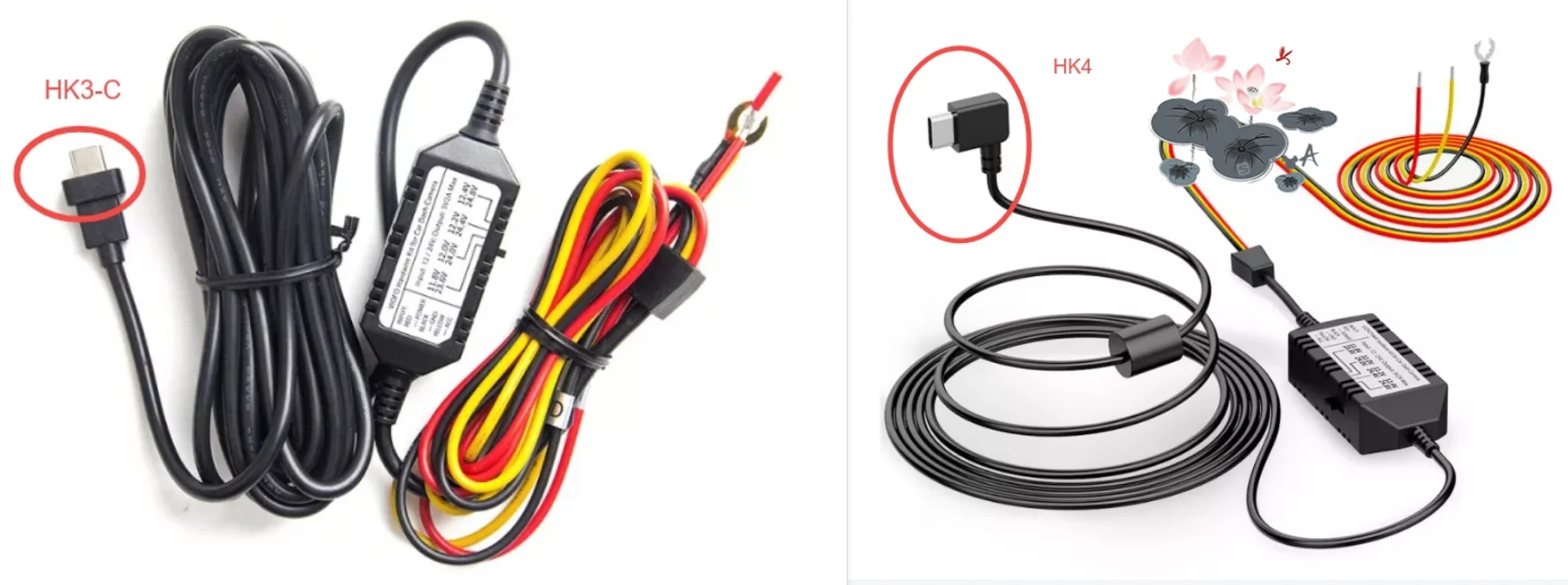

Sorry for the confusion, the "C" in HK3-C actually indicates a type-C port, in order to tell that apart from the previous MINI USB HK3 used in A119v3 and A129 series.
The standard hardwire kit for A139 PRO is HK3-C, the same as A139; you can also use the HK4 on A139/A139PRO, as it is also a type-c port, while its port angle is right, not straight as HK3-C, you can tell by the pics.

Argh. Wish I'd looked into/known that before ordering. The 139 Pro website order page only lists the HK3-C as an option. Would've preferred the right angle connection.

I’m ordering in the next couple of days and have been wondering about going with the straight or 90* cable. Could you give a little detail as to why the right angle would have worked better for you. Thanks

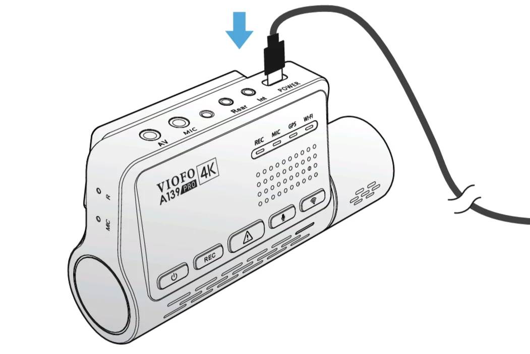

The rear and interior camera cables are straight, and connect to the top of the A139, next to the USB-C power cable. So consider all three when deciding whether to use a straight or right angle hardwire kit.
If you choose the right angle HK4, it really only works on one side, over the lens. The cable will clash with the rear and interior camera cables in the other direction.
The HK4 does have a thinner cable which helps with install but the right angle USB-C would be problematic on the A139 Pro in my opinion.
I just measured the cable thickness (cable between power converter and USB-C connector) on both a HK3-C and a HK4 and both measure 4.21 mm (0.166 inches). Which one to use primarily depends on how you're routing the power cable. I currently have a HK4 powering the A139 Pro in my car. The "optimized" HK3-C may end up being the preferred option since it has a straight USB-C connector which is just like the rear/interior video cables.
During my A139 Pro power consumption testing, I found the 3-channel configuration can approach or slightly exceed the 5-volt / 2 amp max rating for the original HK3-C / HK4. The optimized HK3-C should be addressing that issue, but I'm waiting to see what the power rating is for the "optimized" version.

If you are mounting directly below the car's sensor pod then you may want the 90 degree to save a little space and get the camera a little higher, but you still have the video cables going straight upwards so I don't think there is much advantage. The 90 degree version was designed for the A229, which has the power connector on the side rather than at the top.

Since the rear and interior cables are all straight, so better to go with a straight hardwire kit, which is the general choice of most customers, so you can adjust the 3 cables simultaneously.

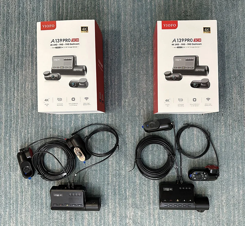

My retail A139 Pro just arrived to go alongside the preproduction unit I've been testing for a while and the retail one looks to resolve some issues with lowlight/nighttime recording that affected the preproduction unit. Woohoo!
Now that I can properly view nighttime video, I ran it alongside the A129 Pro last night and WOW what a difference! Noticeably less noise as well as better dynamic range which means that the new model makes it significantly more likely that you'll catch plates at night.
I'm still seeing an issue with both the A139 Pro and the A129 Pro running newer firmware where I can't play/edit video files in FinalCut Pro so I gotta figure out how to resolve that so I can create some videos. Oddly enough I can use older A129 Pro footage from a few years ago when it was running older firmware, but something must have changed with Viofo's newer firmware. Has anyone else had issues editing footage? I can play back in VLC just fine, but not so much in Quicktime or FinalCut.
Either way, now that I've got two units on hand, it'll be useful for doing things like daytime HDR on/off comparison, having one in the car collecting sample footage while the other is on the bench doing parking mode tests hooked up to some battery packs, etc.
