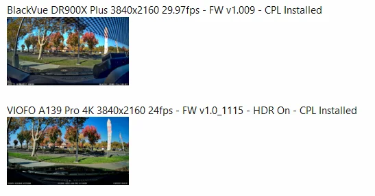

I just created full size screenshots of the two video frames and uploaded them to a Google drive folder.
Do you remember the HDR status? Was on on A139P and off on DR900 ?
Back in post #53 I listed the info for each camera. HDR was on in the A139 Pro.
The BlackVue X Plus series cameras don't allow you to change anything exposure related. The only thing you can select is the "Image Quality" setting for the video bitrate and it was at the "Highest (Extreme)" setting which is the default value.
OK, so BlackVue didn't had HDR enabled. When you have time and if you want, maybe you will post snapshots like on post #53 but with both dashcams having HDR On and then both of them HDR Off.
Small things like this are not important for most of the people, but for people like me are important because when doing side by side comparison the setup must to be very correct to not create some advantage for one of the dashcams. Of course, always will be some very little disadvantage for one of them because cannot be installed at exactly at the same position, but both of them can have exactly the same line of horizon (which is the most important thing when doing side by side comparison).
IMHO, I don't see differences
Looks like "dr900x plus" is little bit overexposed ("for lease" sign at right is white and not visible), but, on the other hand, texture of the tree at left is better visible.
Quite a lot of the bright stuff is over exposed on the DR900, while the dark stuff is just slightly brighter than on the A139 Pro, so the problem for the DR900 is mainly insufficient dynamic range rather than overexposure.
Also noticeable from the size of the above cutouts that the A139 Pro has a bit more magnification, which helps to record a little more detail in everything that hasn't fallen off the sides of the image. Doesn't make a lot of difference and some people will prefer the wider field of view, personally I think the DR900 is a little too wide.
Note that these images do not show any bitrate limitations, because there is no motion, so not much bitrate is needed. The quality of the DR900 images decreases significantly with some movement.
The DR900 image is overexposed also because of different mount situation. In the DR900 image appears a black A139 Pro, some black dots, the black mirror. Also the horizon line of the dashcams is not at the same level, the prefect spot for comparison is the roof of that central house. Difference of brightness can be seen also on the car dashboard. With HDR Off I expect also the A139 Pro image to be more bright and the sky to become overexposed.
The DR900X Plus does not have a HDR on/off setting.
I didn't know that only 900S have HDR, I assumed that also 900X have HDR. Also on your Blackvue custom text the last word was OFF so I assumed that means HDR off.
The DR900S and DR900X dash cameras do have a HDR setting that can be changed by the user (don't have my original DR900S to get a screenshot). The "OFF" in the bottom right of the BlackVue DR900X Plus screenshot is the 2-channel dash camera noting that the rear camera is not connected (operating in 1-channel mode). That section of the BlackVue camera status text notes whether a camera is connected and what general resolution it can operate in.
