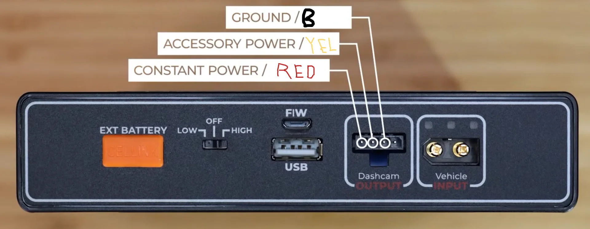

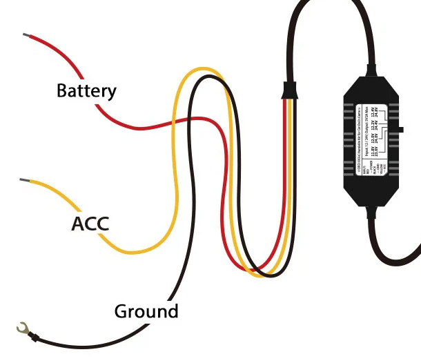

You can insert the 3-wires from the original Viofo Hardwire Kit you were using into the PC8 output connector as shown.
It will be tricky to get the wires to stay put long enough to check if parking mode functions properly.
Use your imagination.
If this works, it means there is something wrong with the “one-piece” spliced cable.
