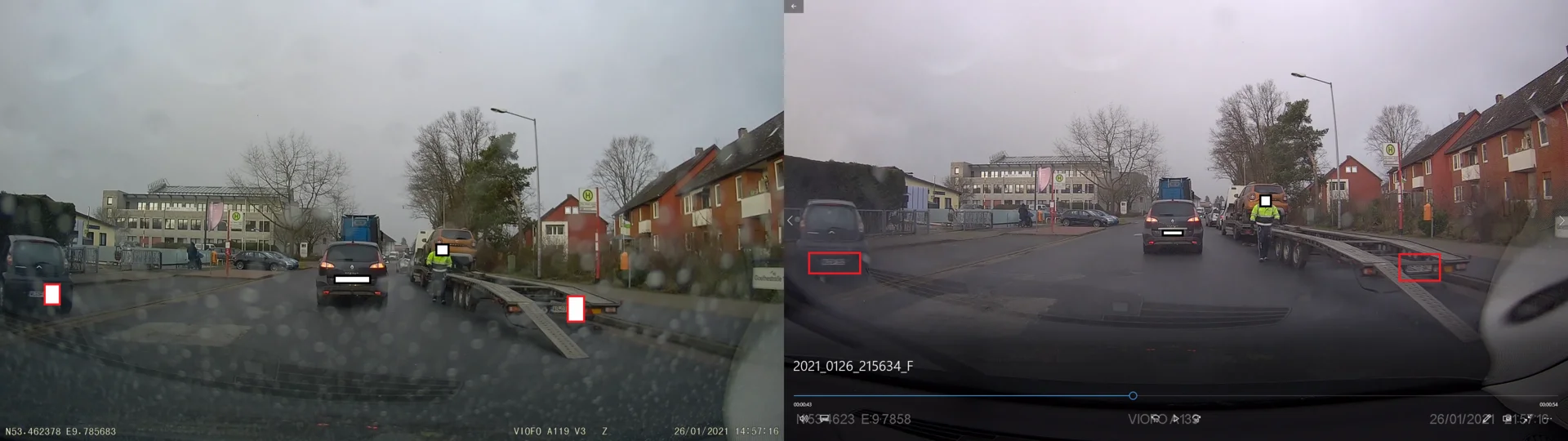

I've had the A139 for a few days now and I'm a bit disappointed with the image quality.
The license plate recognizes the A119 V3 better than the new A139.
Maybe that's because the a139 has a wider viewing angle and therefore does not look as close to the front as the A119.

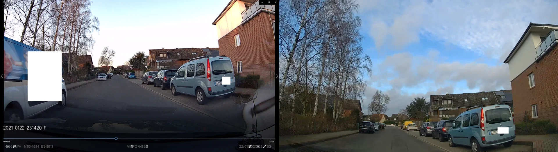

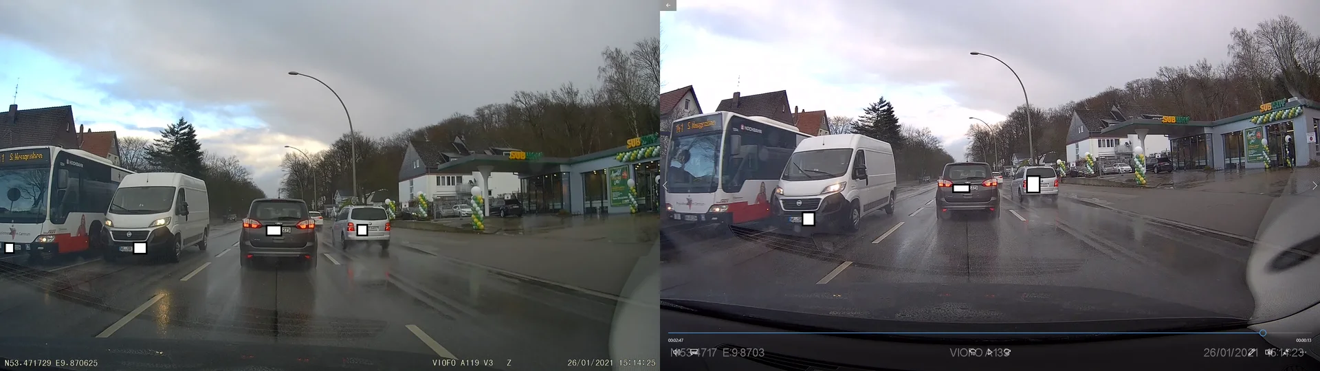

Here you can see the differences.
The A139 has a wider viewing angle
With the A119, the cars, generally the image are closer, as if zoomed in.

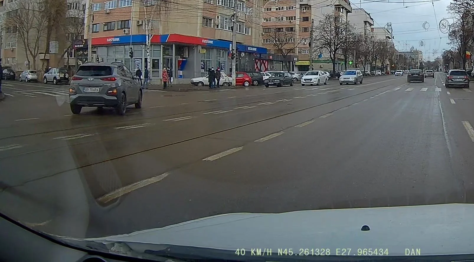

Look a frame from a video from my A129+ (same FOV).
PS: and there is another advantage of these camera: they have better optics, sharper and with more contrast. See here.
