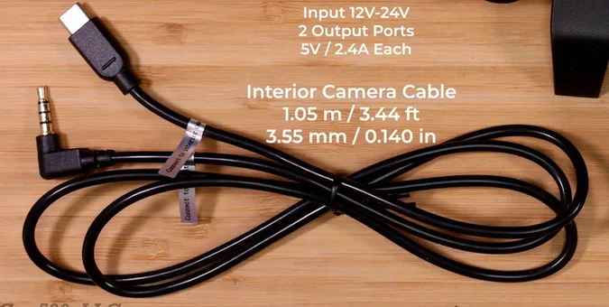

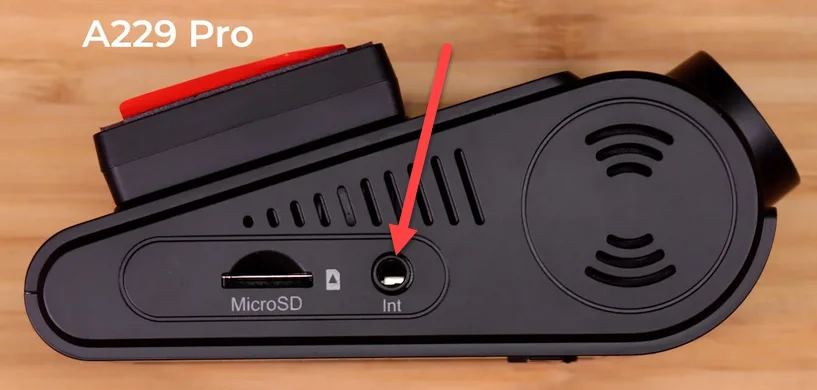

I have the 2 channel A229 Pro also, and I mistakenly ordered the interior camera on eBay thinking I could just add it to this setup (the manual also showed it as an optional add-on) but I now realize that since this is a 2 channel model then I would have to disable the front or rear camera when using the interior camera also ...is that correct? Is disabling the cameras possible through the camera menu (or app) or do I have to just unplug the USB power cable from the camera itself? Or does plugging in the interior camera automatically disable the rear camera?
You should not have to disable anything to add the optional interior camera. The A229 Pro rear camera connects via the USB-C port on the upper left side of the front camera. The interior camera connects via the round connector end of the interior camera cable to the "Int" connector port on the middle right side of the front camera. The USB-C end of the interior camera cable connects to the interior camera.
It's the same camera head used for 1 2 or 3 channels. It was called a 2 channel camera because when you ordered it, the rear camera was included in the box.
Thanks for that info. Just to confirm, if I install the interior camera, I can run 3 channels moving forward? (lufa6977's earlier reply confused me).
Yes you can definitely run 3 channels with the A229 Pro if you install the interior camera
@lufa6977 was saying that if you only run 1 channel (front) the recording message will say "one channel recording" and if you add a second channel it will say "2 channel recording" etc.

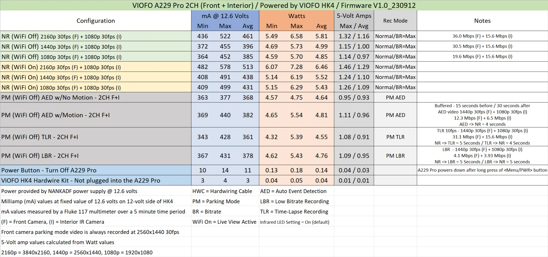

Power Consumption Test Data
3-Channel Front + Rear + Interior
View attachment 68450 View attachment 67783
2-Channel Front + Rear
View attachment 68449 View attachment 67785
2-Channel Front + Interior
View attachment 68448 View attachment 67787
1-Channel Front
View attachment 68447 View attachment 67789

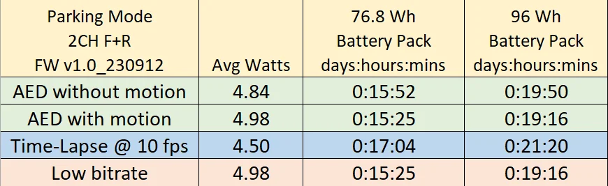

Summary Of Video Bitrate Data
@rcg530 , so it looks like Time-lapse @ 10fps consistently gives the longest recording time during parking mode. Perhaps a silly question (due to my own ignorance), but would Time-Lapse @ 1fps conserve the battery further? However, I'm thinking you didn't include that parameter because maybe 10fps is the most usable of the Time-Lapse subparameters?
I believe the power draw for time-lapse 1fps will be ever so slightly lower than 10fps. If I remember correctly, time-lapse 1fps super night vision [SNV} was added to the A229 Pro. The SNV version of time-lapse 1fps does reduce the power draw a bit more. I haven't gone back and retested the A229 Pro power consumption for SNV, but on other models that added time-lapse 1fps SNV it did reduce the power consumption even further.
