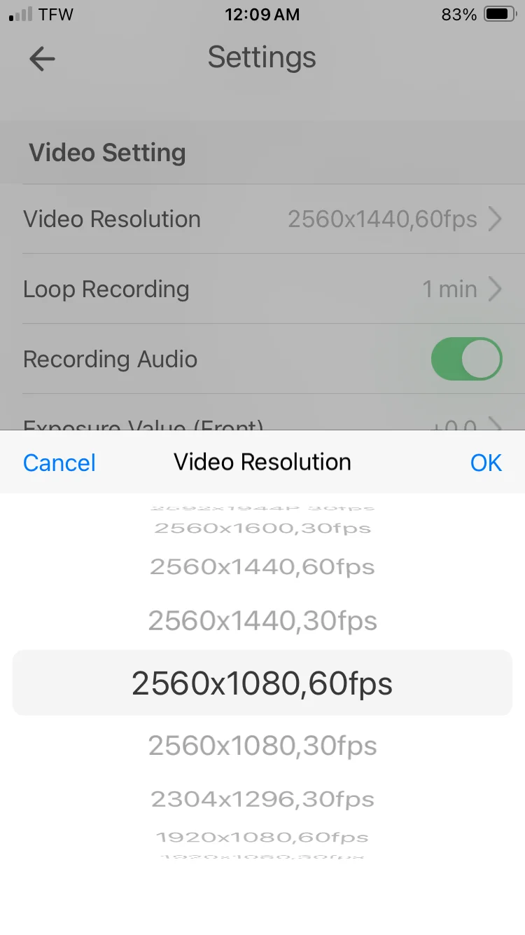

Let me guess.
The 9 different resolution settings for the A119 Mini 2 are 7 too many. LMAO
Just give me 2K30 & 2K60, do we really need the other 7? lol

So this mean lower IQ in parking mode because the front camera will automatically drop to 2K resolution when in parking mode? And also a lower bitrates + downscale image to 2K issue and may be better leave selected in menu resolutions for parking modes?

So many options makes it hard to decide and gives me a headache

Apparently so. The A229 on its public and private FW release is coming up short in several areas. Having 9 rates with most, or perhaps all of them failing is not good, especially if some of those rates are not supported natively by Sony design.

Yes, Cause the manufacture determine there is reason for each?
The max sensor resolution is there, cause that is what it natively outputs. It is 4:3 but it is there.
The others, users want choices. 16:9 since that is what tv and monitors are. Ultrawide to crop out the sky and dash. etc.
Save on file size, cpu useage? could be many reasons. Ask Viofo?

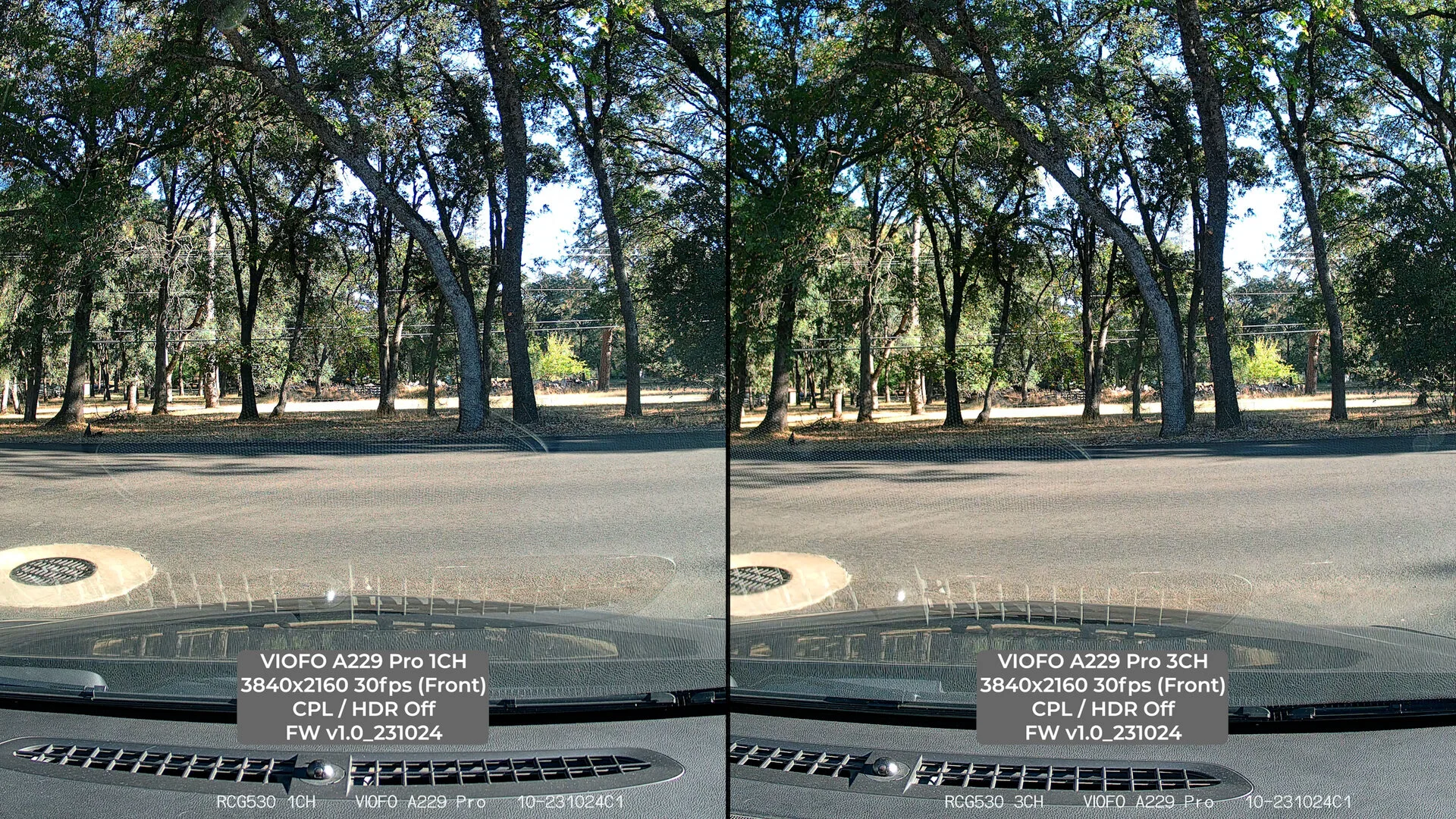

I have two A229 Pro front cameras with v1.0_231024 firmware. One of them is from the early marketing sample batch and the second is from a recent production batch. VIOFO wanted me to see if the production unit worked any better than the early marketing sample unit with regard to the color flashing issue. The production unit doesn't seem to suffer from the same color flashing issue (so far). The location during my Friday drives which was provoking the red color changes/flashes did not cause the issue with either camera. There weren't any vehicles pulling into the parking lot this time and that appears to be a factor in the issue for the specific location / time of day. I did find an example of the early marketing unit video footage causing a road color change, but the production unit did not do that. The production unit is configured as a 1CH dash camera and the early marketing unit is configured as a 3CH dash camera. I'll have to gather more footage over the next couple of weeks to see if there is a true and lasting difference between the two units.
The A229 Pro (left) is the production unit and the A229 Pro on the right is the early marketing sample unit. You can see the road surface color change in the footage from the early marketing unit.

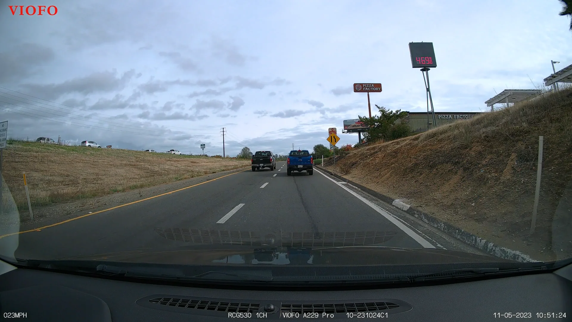

Today, I was on a short drive through my local town. I found some A229 Pro front camera footage (production unit, maximum bitrate, CPL installed, HDR off, firmware v1.0_231024) where I observed the "blue flash" issue again. I sending these frame grabs and raw video footage to VIOFO.
Normal / Blue Flash / Normal
