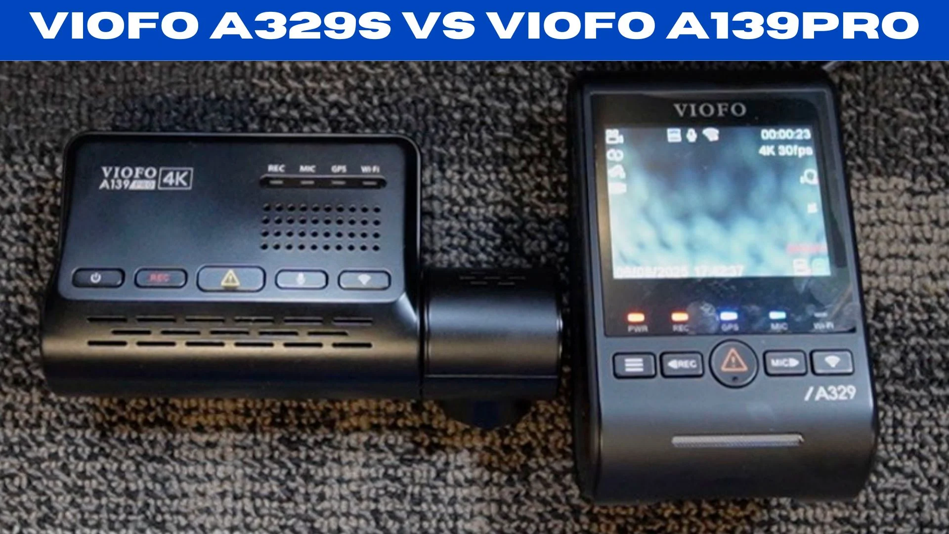

Viofo A329S Review
Thanks for the hands-on comparison!
There's a cool trick to reuse the A139 Pro's front/rear cable with the A329 series. It just requires an adapter for the different sized connectors. Check this out:
Going to look into this and then reupload an updated video

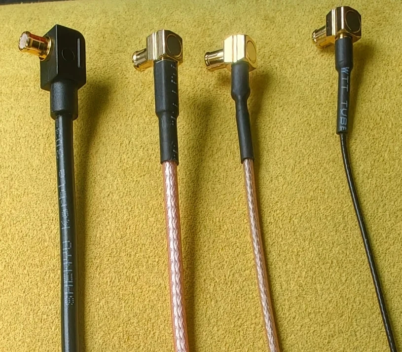

The question belies does their old cable and new cable carry the same amount of data via the coax? As I believe they are different widths.
I'd be curious to see if this works reliably or ends up causing issues with the 3 channels sending data utilizing the A139 cabling vs the A329 Cabling.
The both use RG174 coax cable, it's just the end connectors that are different - so should be no difference.
Another alternative is to re-cap the ends but that would require crimping, soldering and heat shrinking (replacing the end connectors) - but that isn't going to be feasible by most users and would be easier just to swap out the cables.
A female MMCX to male MCX adapter would be the quickest option. Either an all in one end connector adapter, or one with a small cable, where you could tuck away the extra length so the cable left on show would just look like a normal cable that's not been extended.
But also looking at @indigo thread, they have tried various coax cable thickness and all work the same.
My A139 cable is actually a little thinner than the A229 cable, but they are both RG174 specification, possibly a different manufacturer, shouldn't make any difference.
