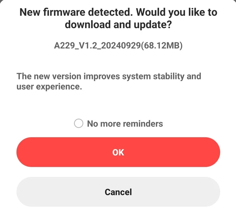

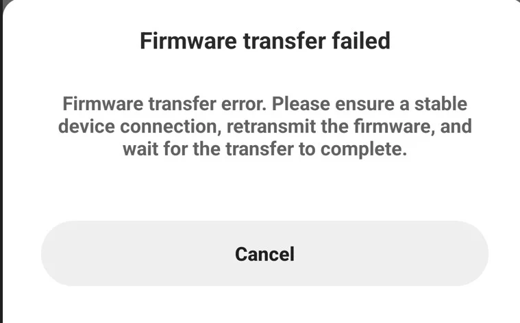

Hello all,
I have two A229 Duo dashcams. Just today I attempted to perform a firmware update (yes, a long overdue update, I know) using the OTA firmware update feature of the new VIOFO app and I couldn't get it to work.
I am using version 2.0.01 of the new VIOFO app on a Samsung Galaxy S24+ running One UI Version 8.0 and Android Version 16
I was able to connect the dashcam with the app, it detected it very easily, and the app did determine that there was a firmware update due for the dashcam.
When I went to initiate the firmware download and update, I almost immediately receive this message on the phone screen:
When I first received the error message I thought that maybe if it was trying to download the new firmware using cellular data and I was out in my driveway, the cellular signal isn't that great there (I was getting maybe 2-3 bars of service at best), so I drove up to where the closest cell tower is located that covers our entire neighborhood. You literally cannot park closer to this cell tower without trespassing on the restricted road that leads to the tower. I was now receiving a nice robust full 5G cellular signal here.
I tried again here to perform the firmware update same as before. The app connected with the dashcam, the prompt to do the firmware update came up again, but as soon as I initiate the update process, it still wouldn't work. I got the same error message as the first time back in my driveway.
Am I doing something wrong?
I know from doing some reading here that the VIOFO new app may not be always working like it should, so I don't know if there is a problem with something I'm doing or not doing, or if it is an issue with the app and no matter how correctly I do everything, it still won't work.
Does anyone here have some wisdom they can share on any ways to get this process to work for me?
I was REALLY hoping to avoid having to do the firmware update the old-fashioned way taking out SD Cards and putting them back, etc if there was a much more convenient way to do it, but if the more convenient can't or won't work, then I guess the choice is kind of taken away from me.
Thanks in advance for any advice/guidance

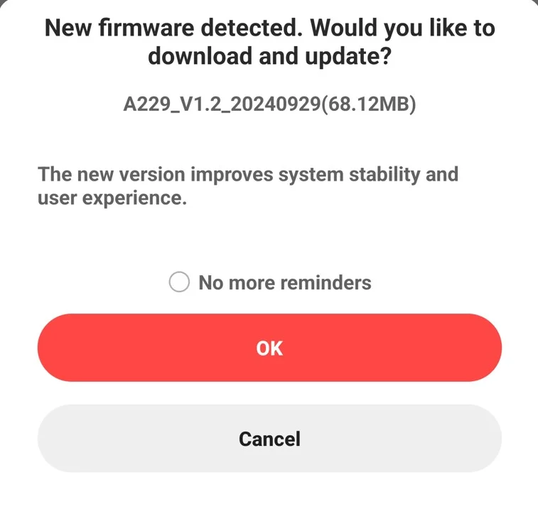

Hello all,
Your current A229 DUO firmware version likely isn't capable of OTA updates. You will need to manually update to the newest, then OTA updates should work going forward.
Your current firmware version likely isn't capable
Ok, thanks for the info.
I was hopeful I wouldn't have to do it the old way but I'll go ahead and do it.
I already have an extra 64GB SD Card that is partitioned and formatted to FAT32 here in the house that I have used for doing some firmware rollbacks on the WYZE home cameras I use around the yard that should hopefully do the trick. I'll just have to make sure it's cleared off before I load this firmware to it.
Thanks again for the swift reply, much appreciated.

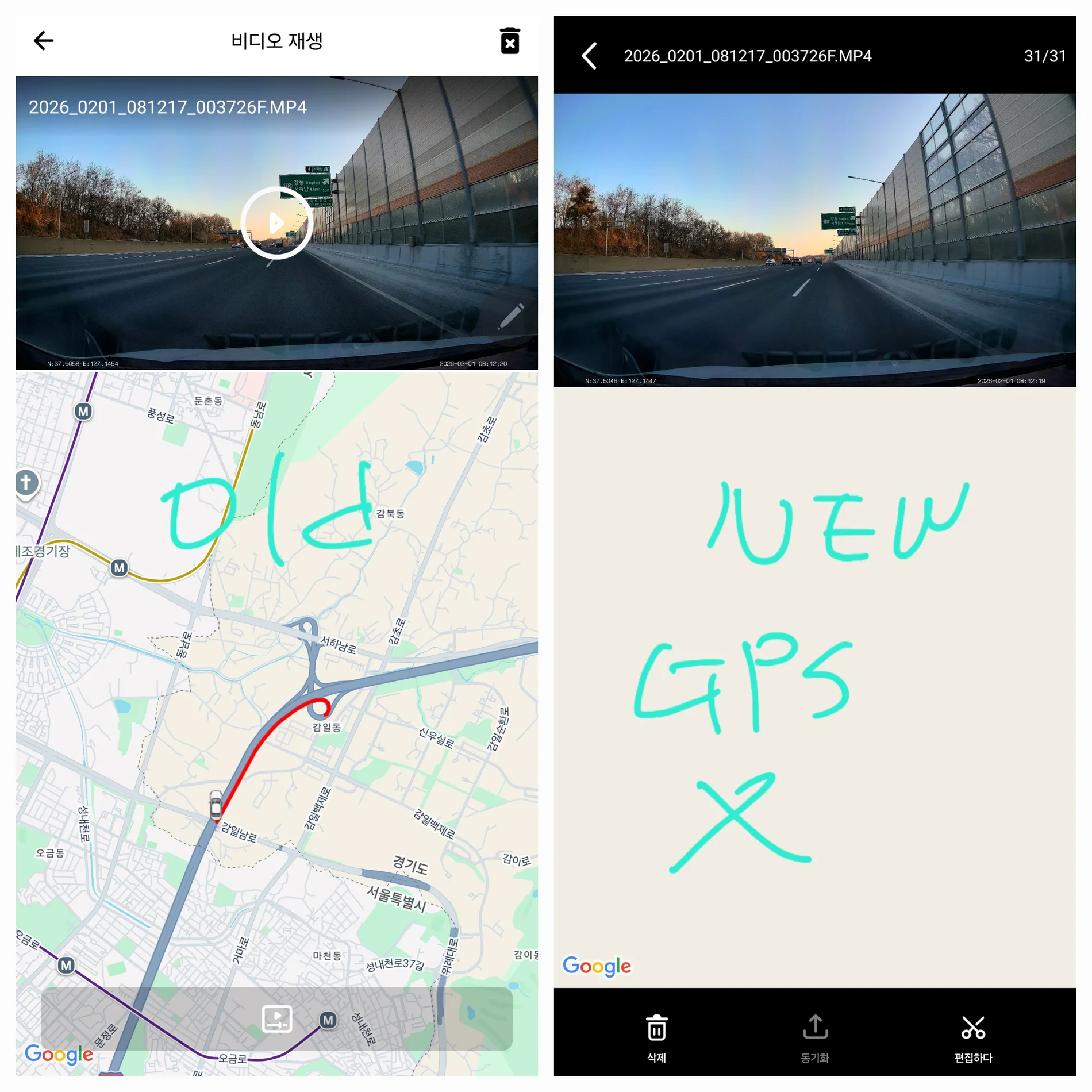

A229Pro에서 VIOFO App은 GPS가 되는데 VIOFO Dashcam App은 GPS가 안됩니다.

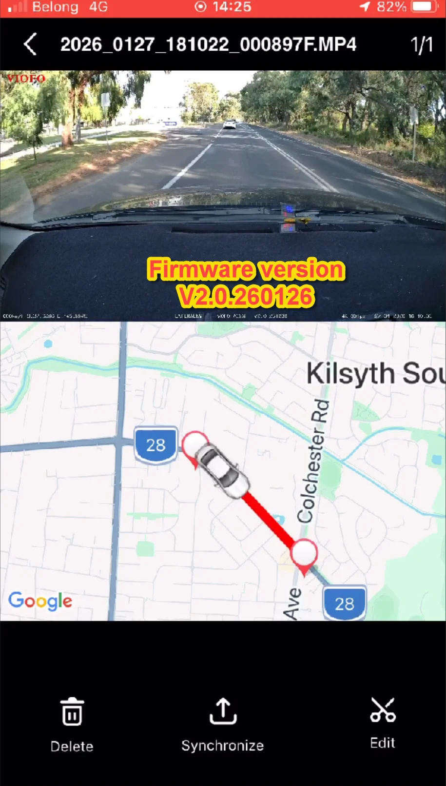

Ok did some testing and it did use the gps co-ordinate's however I only did the check after updating the firmware as it prompted me on the app.
Attempting reproduce your issue. What I found odd how I could downloaded the video that was on the sd card from another day and didn't sync it. It then dropped the wifi connection which it does often.
I was still in the app so I decided to view the file I just downloaded and it worked with gps info no problem. See image.
Once I had wifi connection again I synced the file and it prompted me for permission to download files? I had already done this without a prompt. I said yes as I figured it will probably break the app if I said no.
The firmware version I am running is 260126 (DDMMYYY)
app iphone version 1.0.4.9

감사합니다. 저는 안드로이드인데 다른 한국내 안드로이드 사용자도 문제가 동일합니다.
Thank you. I am an Android user, but other Android users in Korea have the same issue.

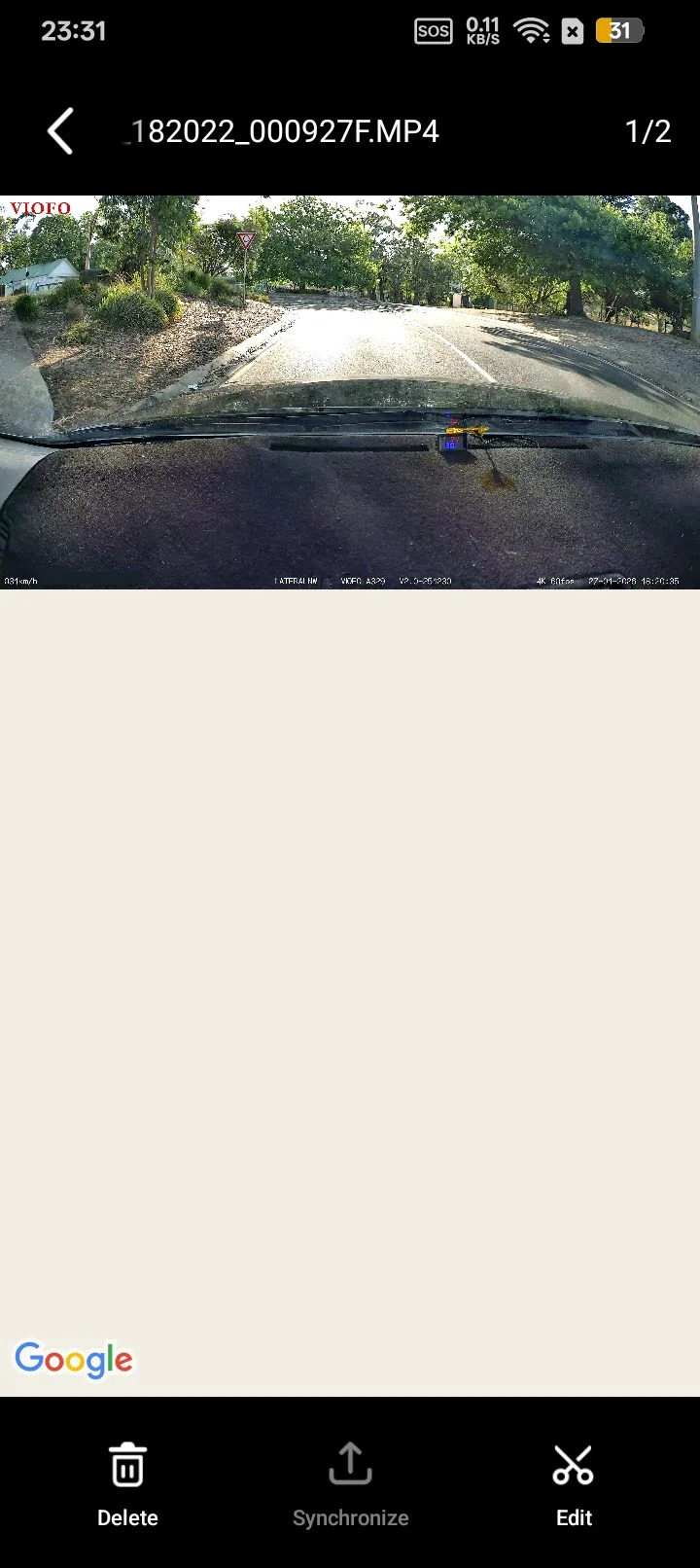

I'll check with my android.
@KR_OGU
I have just finished a test using viofo app version 2.0.01 connected to my A329hdmi model on Android.
I got exactly the same problem as you.
Once the file is downloaded and I go to my local files within the app and play that video, the video plays but the gps information is completely missing.
@VIOFO-Support
I forwarded this to our engineering team already and they are testing on this.

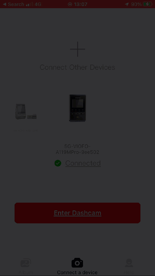

I found this oddity when attempting to connect to the A119MPro using the new app.
While it shows it can connect and it does once connected it won't display the live screen.
If I go into the 4G settings and turn the phone into airplane and go back to the app
the screen works almost straight away as seen in the video below.
Now if I go back and turn on 4G and return to the app it will keep working!
ie I haven't left the app just altered the state of the 4G connection. Weird.
@VIOFO-Support
Preliminary assessment indicates that the video stream connection failure is due to a network protocol/IPv6 compatibility issue with the SIM card being used. The developers have identified this issue and are actively investigating and resolving it.

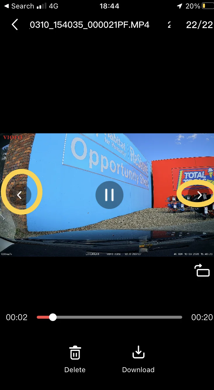

Ok latest ios app and latest firmware.
While parked with the engine running i connect to the A329hdmi unit and enter the app.
I playback a parking file.
I attempt to play back the next one but the app don't respond to my press.
I exit the parking section and then enter the parking section and it will allow me to play another video but only one.
I have to exit the parking mode folder and enter it to be able to select another video.
An interesting feature is while playing back a video i can press the arrows that pop up when the screen is touched and i can watch the next video or the previous video which is a great feature.
While playing back the video the A329H decides to turn off wifi and go to parking mode!
This stops the play back obviously.
It won't respond to the verbal commands to turn on wifi probably because it is in parking mode.
After manually forcing it into wifi mode by pressing the wifi button on the unit i resume my video play backs.
After approx 4 minutes it drops wifi again.
Another test and ~4 minutes in and it again drops wifi.
I doubt the A329H and the app are actually handshaking to keep the connection alive and a hard coded timer tells it to dump the wifi and resume recording.
