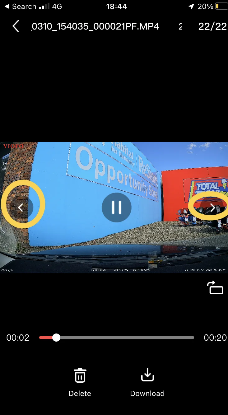

An interesting feature is while playing back a video i can press the arrows that pop up when the screen is touched and i can watch the next video or the previous video which is a great feature.

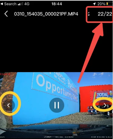

The next video cannot be played by pressing the arrow because it is the last video already:
There should be a reminding message when you press the icon to play back the next one?

The image i posted was a poor example because as you pointed out it is the last file.

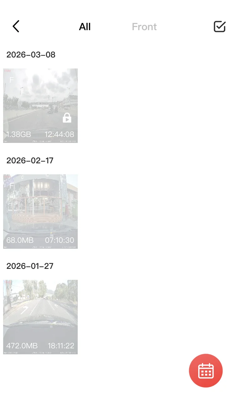

The problem is when in this screen in the new app
1. Notice all images are greyed (which is a seperate issue)
2. Even though they are greyed out i can still play the file i press on however when i return to this screen to play the next file it doesn't respond to my press.
Item 2 is what i am talking about. You are unable to press for the next video to watch after a video has been played.
The work around i have used is to exit that screen and then return to the screen and it will then respond to pressing on the video you want to play. This workaround has to be done for each video you want to play

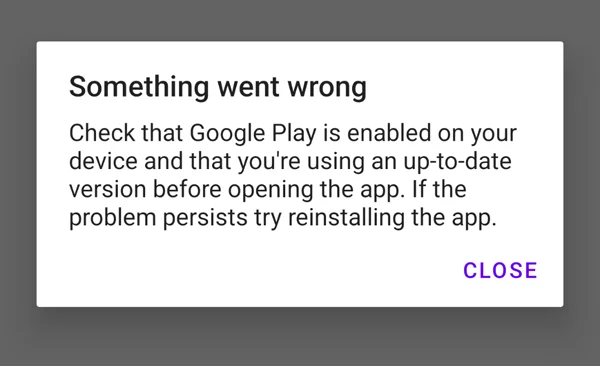

When opening the app.
Something did go wrong, but it has nothing to do with Google Play or the internet connection, everything is up to date & reinstalling this app doesn't stop it happening again.
No other apps are affected.
No pattern to it so replicating isn't possible, but every so often the same thing occurs, so it needs more than a suggestion to reinstall.
A second opening & it works.
OK it's not major, just that it should happen.

There is no access to send you a PM. Would you mind downloading a log for analysis when the issue occurrs again? You can press and hold "about VIOFO" for two times to download a log.

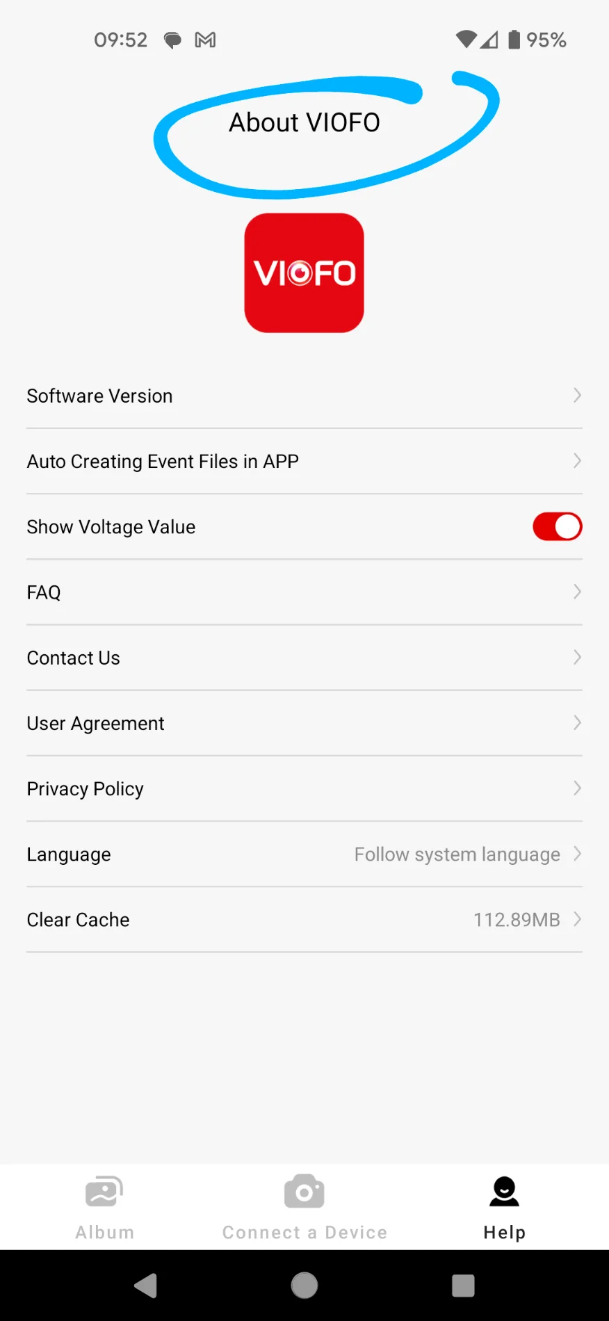

In the VIOFO app go to the Help tab, then press the "About VIOFO" text at the top of the screen for about two seconds. This will generate a log file.

If @TonyM method doesn't work try this.
Tap on the "About Viofo" 5 times and you will be prompted to save text document.
It works this way with an iPhone 8 and the new version of Viofo 1.0.5.10
If you are using android with the new Viofo app version 2.0.02 TonyM's method will work.
Thanks to @TonyM & @LateralNW.
I'm using Android v 2.0.02 and it seems a combo of both methods worked for me.
I first held the "About VIOFO" for up to 5 seconds but nothing so, starting again, I tried tapping 5 times but again nothing. Around a minute elapsed between tries.
I then tapped 5 times and held, voila! The zip file appeared 🙂
Got there in the end.
