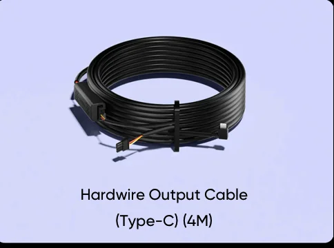

I think the best solution with the BP100 and a Viofo camera is to use this cable that comes with the BP100. All it does is regulate 12V input to 5V output. There is no cutoff voltage switch.
