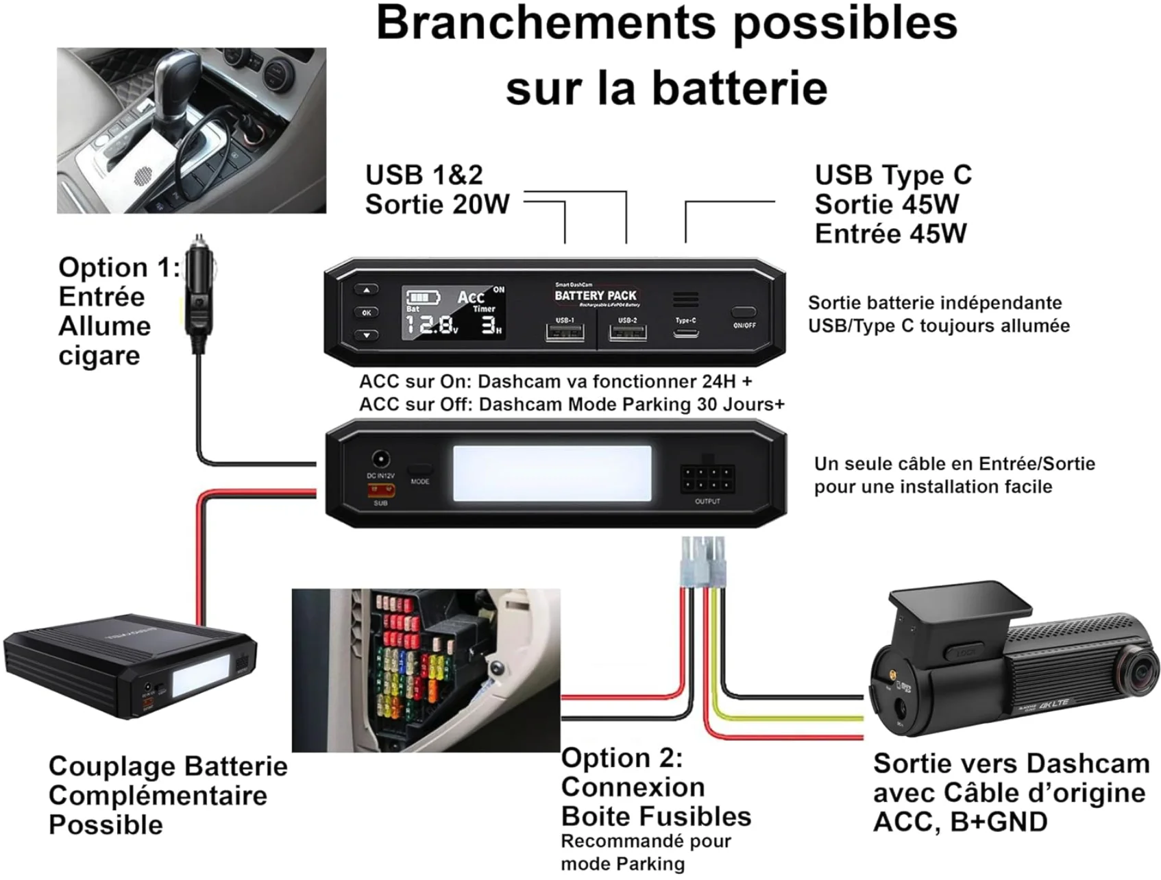

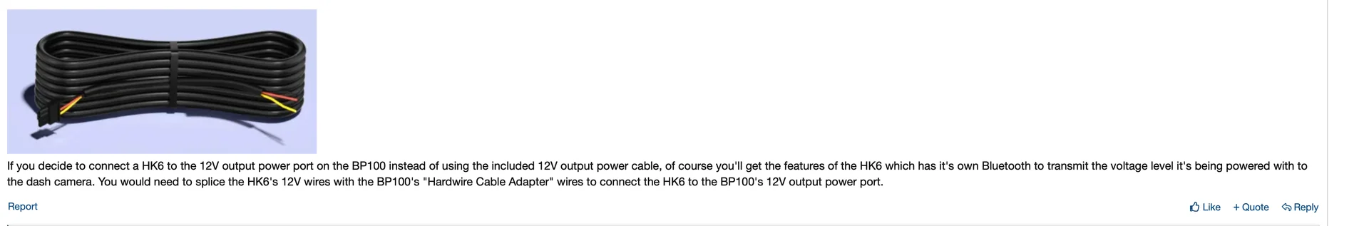

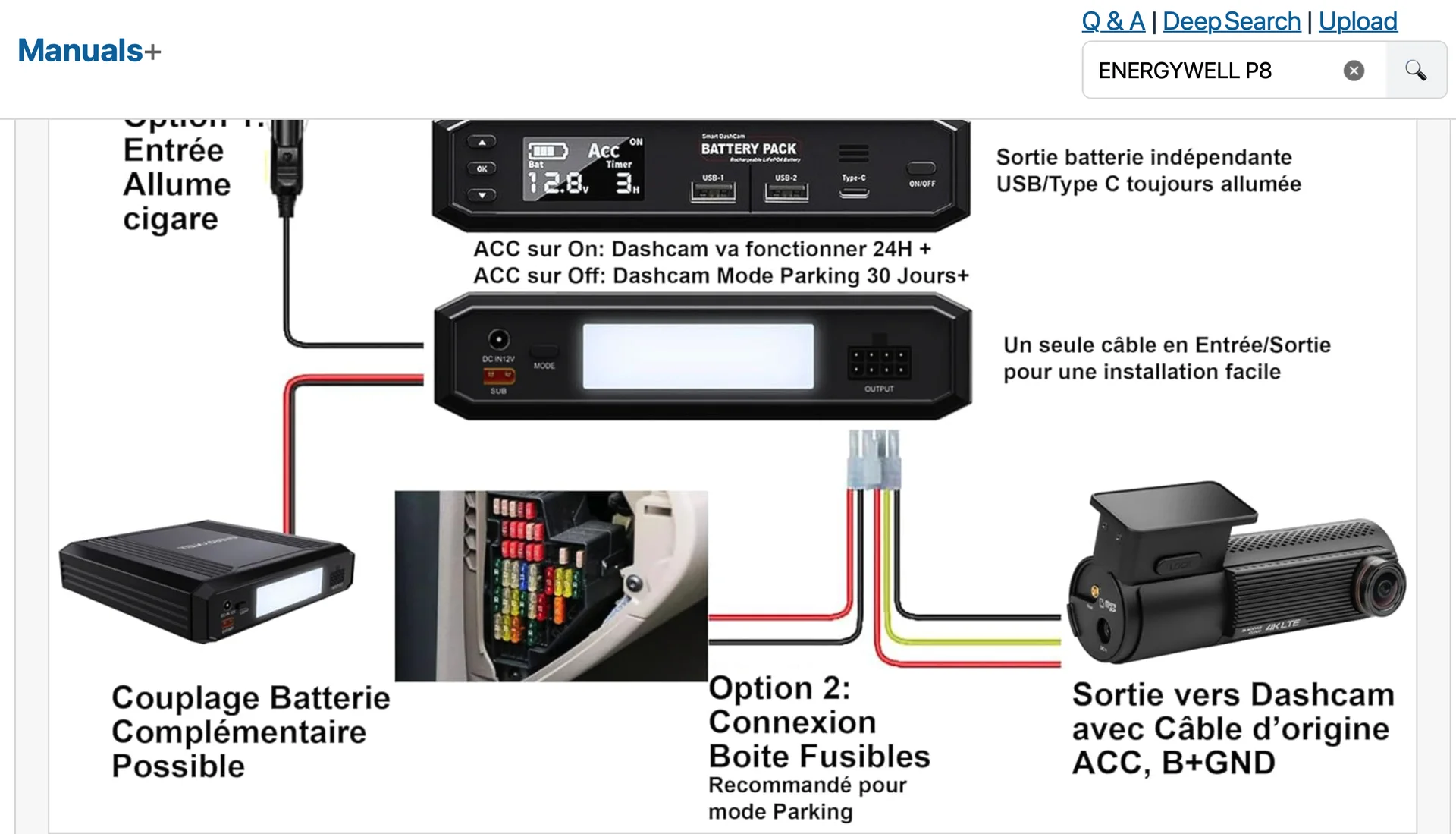

The photo below shows you would need to splice the dashcam's power cable into the P8's output cable (see lower right side of photo). Not a big deal but it's not a "plug and play" connection.

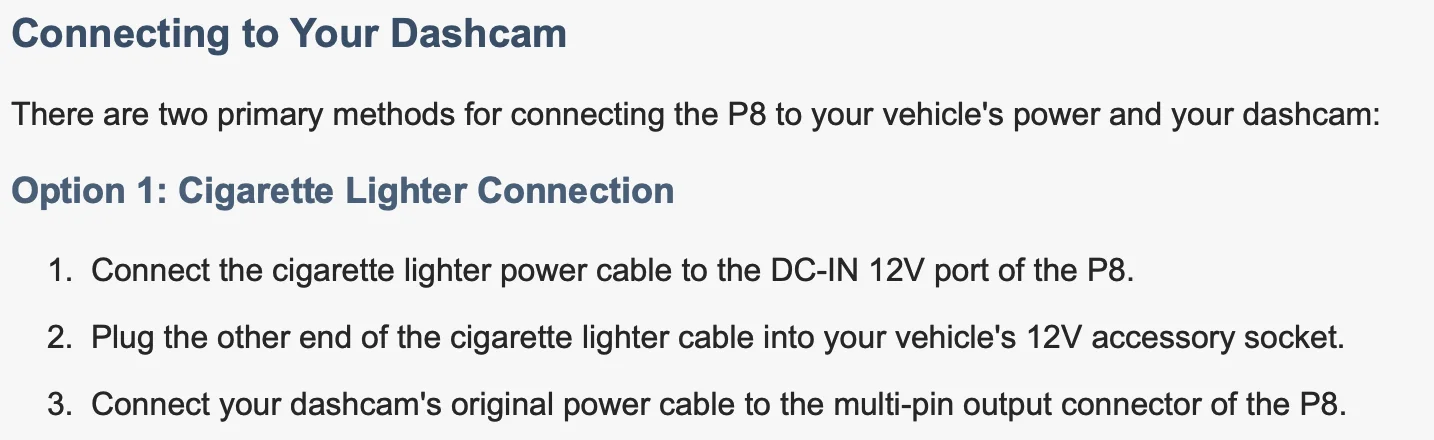

But I find the instructions for connecting to the vehicle +12V for charging the unit VERY confusing.
The photo shows red and black wires from the right side connector labelled "output" going to the car's fuse box. This makes sense. But the Option 2 instructions indicate there should be three wires where it states: "Using the provided ACC power cable, connect the appropriate wires to your vehicle's fuse box. Typically, this involves connecting to a constant power source (B+) and an accessory power source (ACC) that turns on/off with the ignition, as well as a ground wire (GND). "

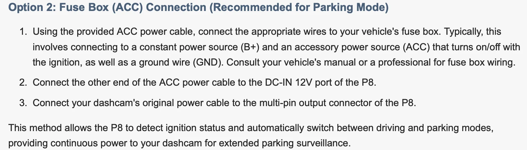

So why are there only two wires shown in the photo (red and black) and why does step 2 state "Connect the other end of the ACC power cable to the DC-IN 12V port of the P8"? The DC-IN 12V connection is shown as using a completely separate and single cable in the photo.
Why would you need to use the DC-IN 12V port of the P8 if you are hardwiring with the connector labelled "Output" ? And why is this Connector called an output when it's clearly used for both DC input and camera output power?
I question if parking mode even works if you use the CLC (Option 1) since the last sentence in Option 2 states "This method allows the P8 to detect ignition status and automatically switch between driving and parking modes, providing continuous power to your dashcam for extended parking surveillance." So does that mean Option 1 does not support parking mode?
