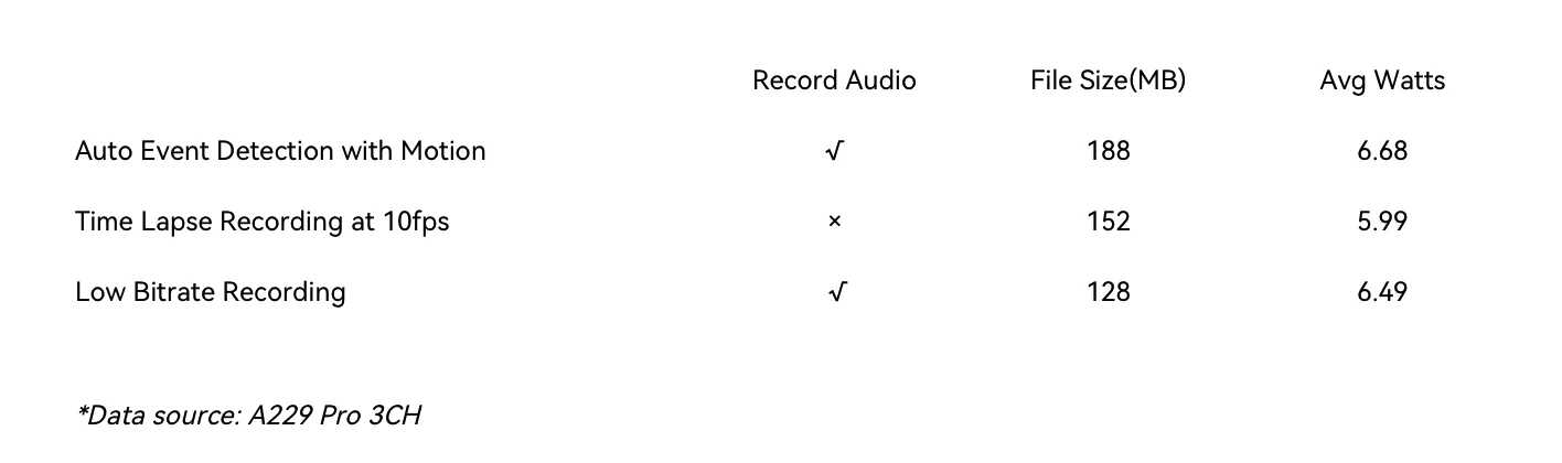

What is your reason for selecting auto event? According to Viofo testing, it can use more power than Low Bit Rate and have larger file size, depending of course on the level of motion activity.
So your primary parking mode is motion detection (auto event) prior to entering hybrid impact ?
My primary, basically daily, is auto event detection and then occasionally I use hybrid when parked somewhere for a long time. As for the reason why I use auto event is I like the video quality of auto event and I like how it saves any motion that happened around my car into clips. I know it uses more power and larger file size. Also, I am running a 2TB SSD. I am trying find out how much more runtime I can get running the custom HK6 with no cutoff vs the regular HK6, trying to find out if I should get a custom HK6
