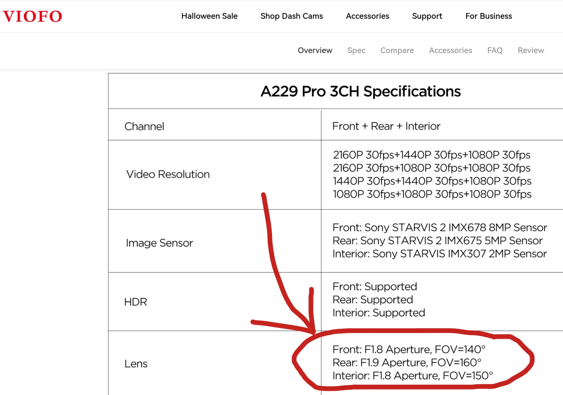

If you look up the specifications for any M12 dashcam lens, it will be given as an angle and described as FoV, which is why Viofo also use FoV.
Should it be FoV or FOV?
Or FV in the USoA?
I also use FOV because that’s what Viofo uses. ...
VIOFO is wrong (but I'll cut them a little slack as it could be a matter of translation from their suppliers specifications) - no different than if they said the sun rose in the west and set in the east. Echoing them just perpetuates the incorrect usage.
If you insist on using FOV instead of the correct AOV then at least use the term Angular Field of View (AFOV).
Field of view (FOV) is the maximum area of a sample that a camera can image. It is related to two things, the focal length of the lens and the sensor size.
That is not the figure that Viofo give, they give the FoV of the lens, the sensor size is not taken into account.
At the end, they explain how to calculate the FoV from the Angular FoV:
FOV=AOV(d/D). Where D is the full display image dimensions (either horizontal or vertical), and d is the target dimensions (either horizontal or vertical).

The FoV given by PP is the camera FoV, not the lens FoV. It may not even be the Sensor FoV, since Viofo don't always use the full sensor area to produce the image. If you are choosing a dashcam, this is the useful value.
The FoV given by Viofo is the lens FoV, calculated without knowing the sensor size.

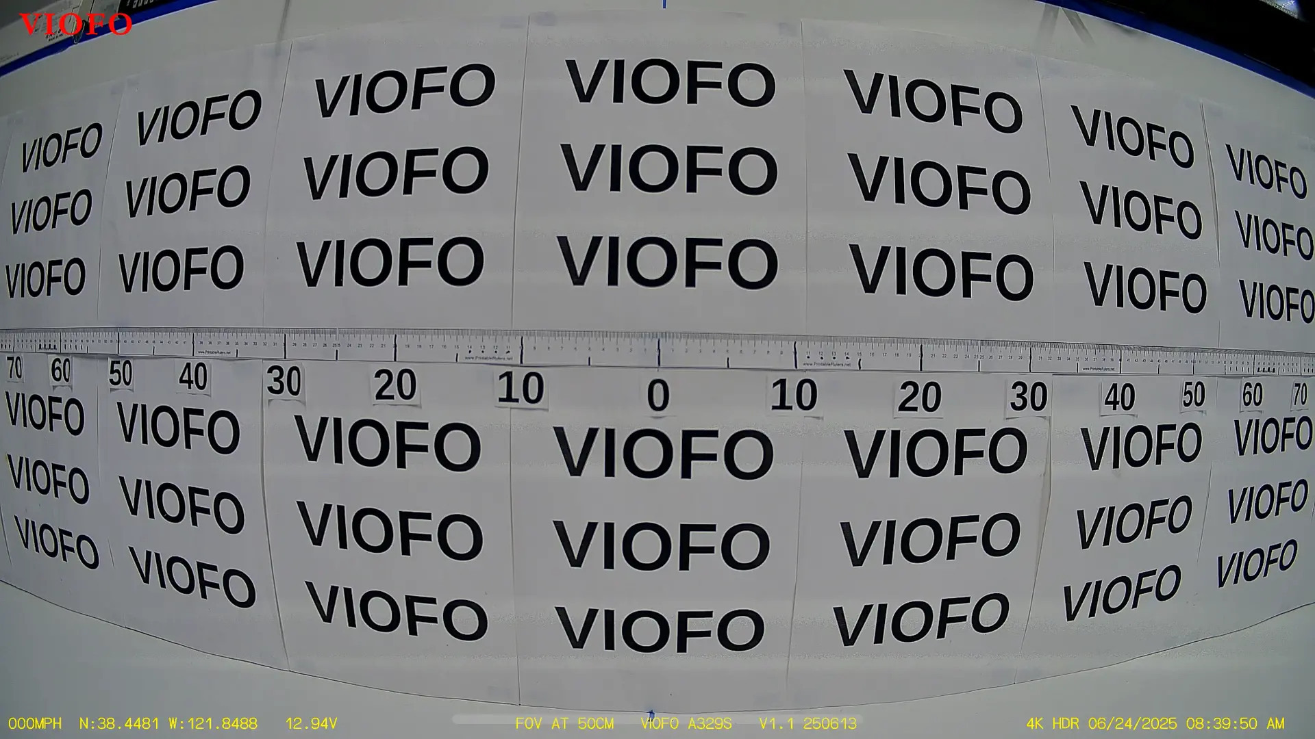

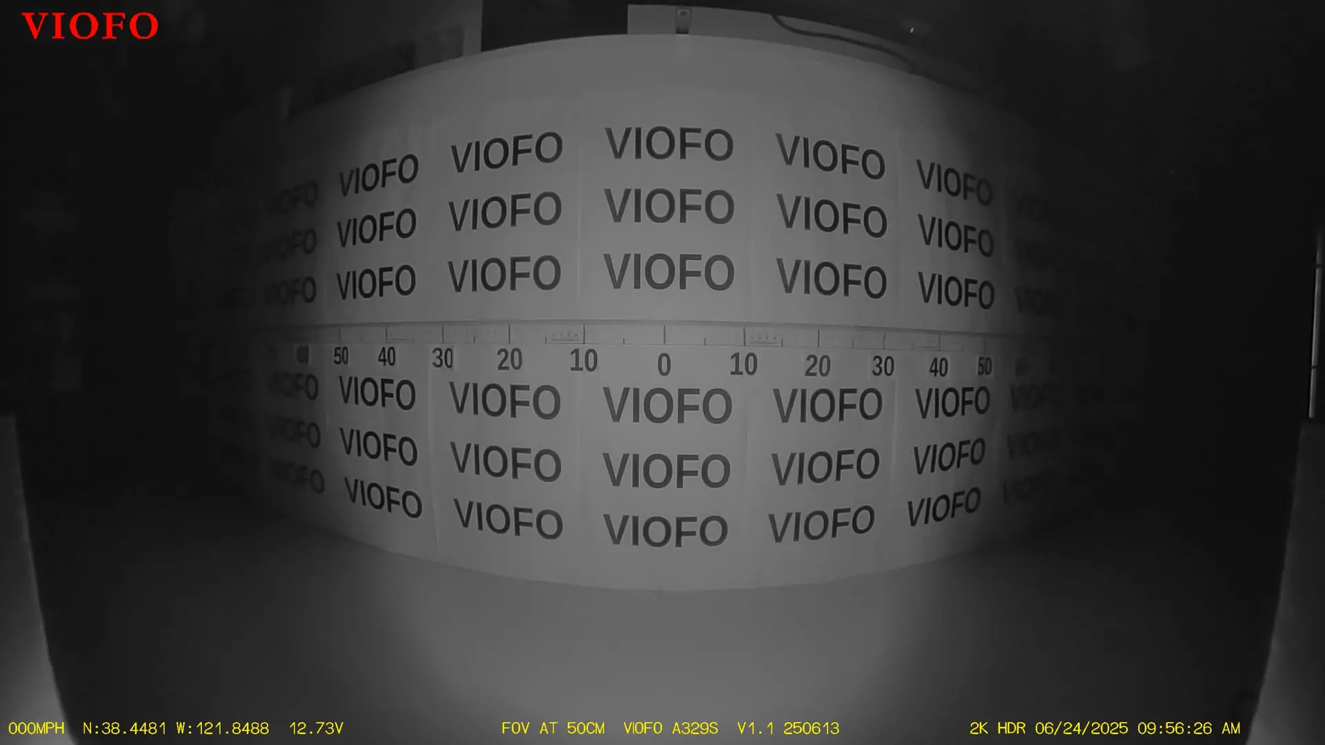

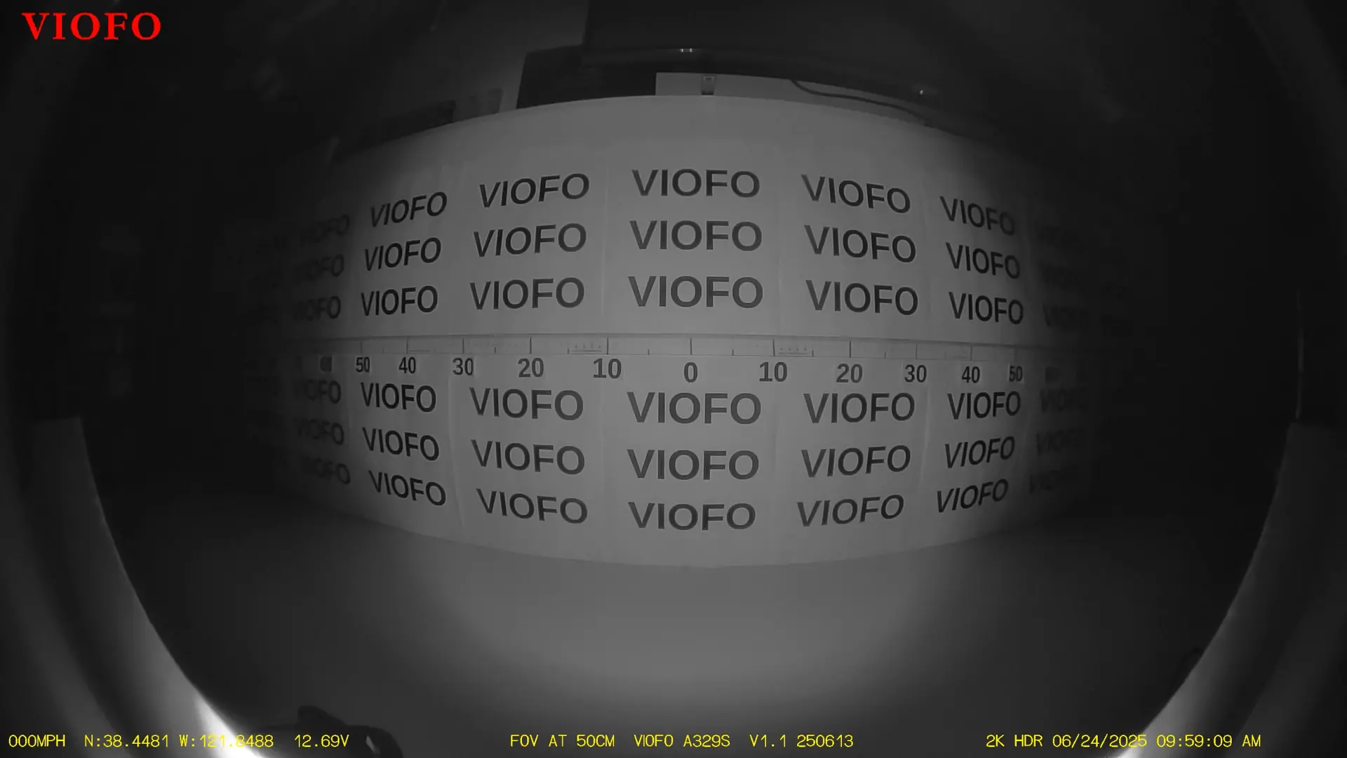

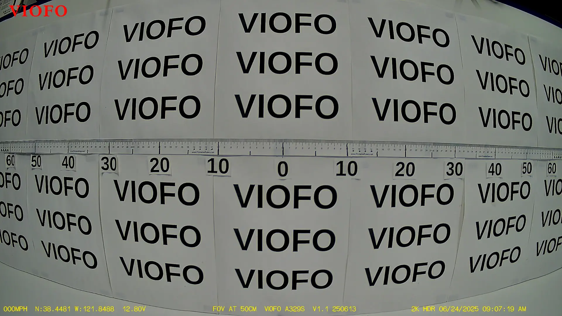

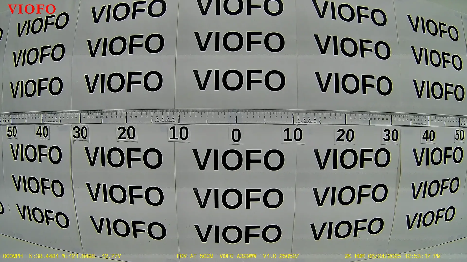

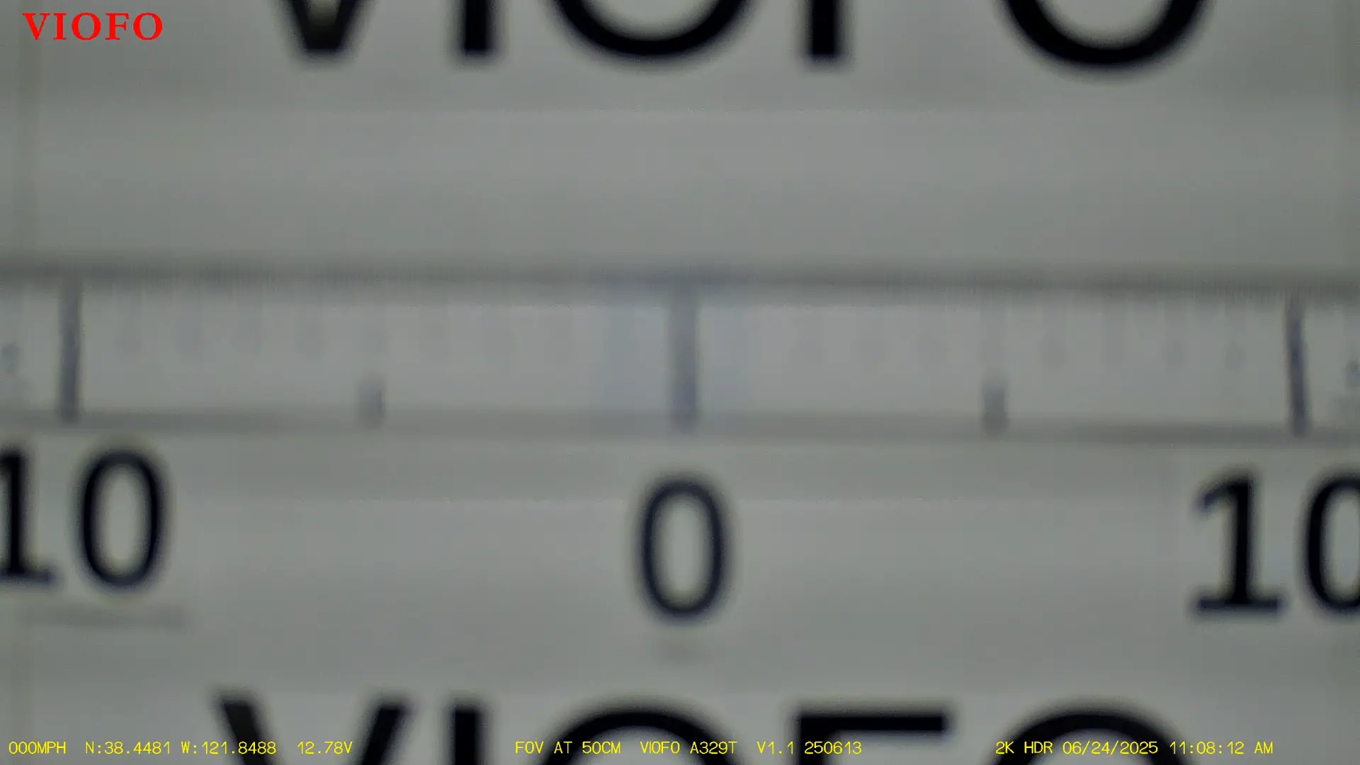

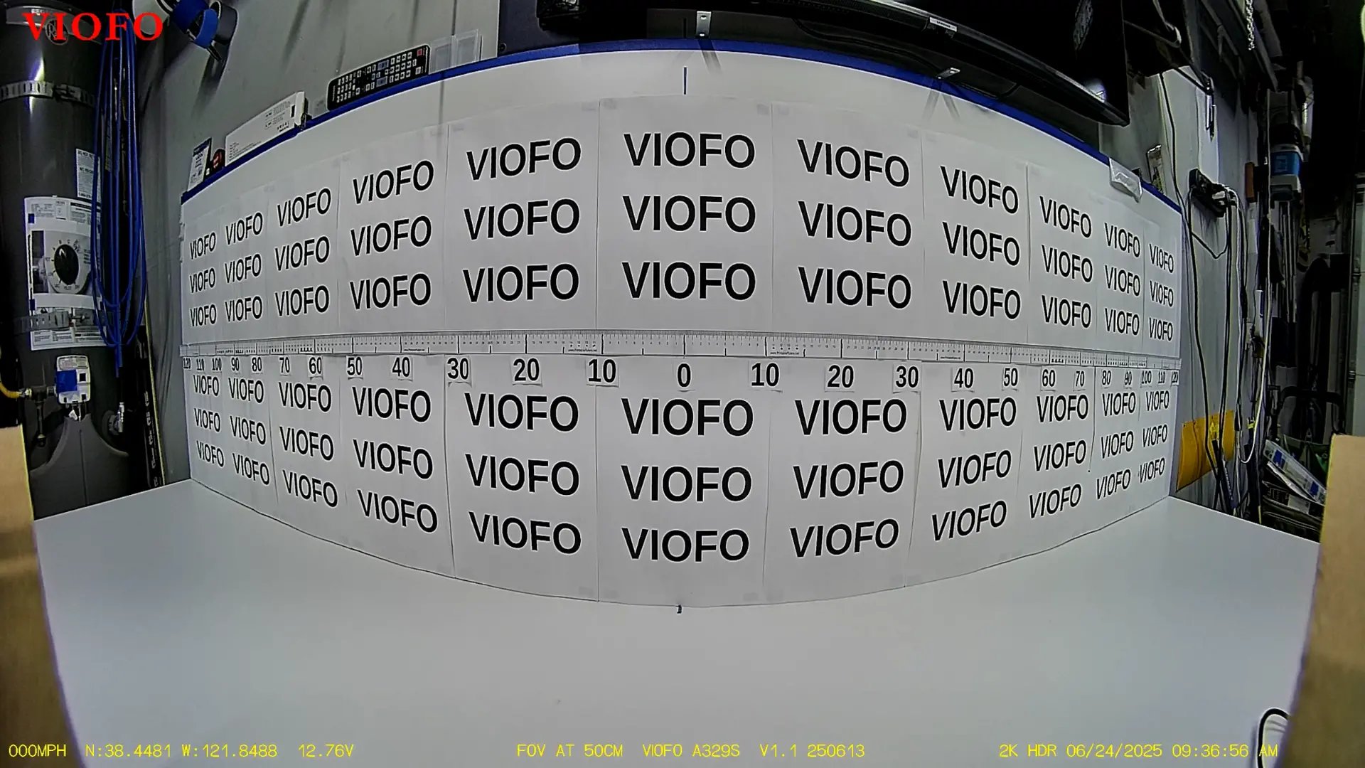

Q: What is the measured Horizontal FOV of the A329S (front & 4 remote cameras)?
A:
..25° FOV Telephoto
..94° FOV Waterproof Rear
105° FOV Rear
111° FOV Front
179° FOV IR Interior (Fisheye Mode Off)
203° FOV IR Interior (Fisheye Mode On)
105° FOV IR Interior (Fisheye Mode Off) LED’s On
105° FOV IR Interior (Fisheye Mode On) LED’s On
Front
Rear

Telephoto
Interior - Fisheye Mode Off
Interior - Fisheye Mode On

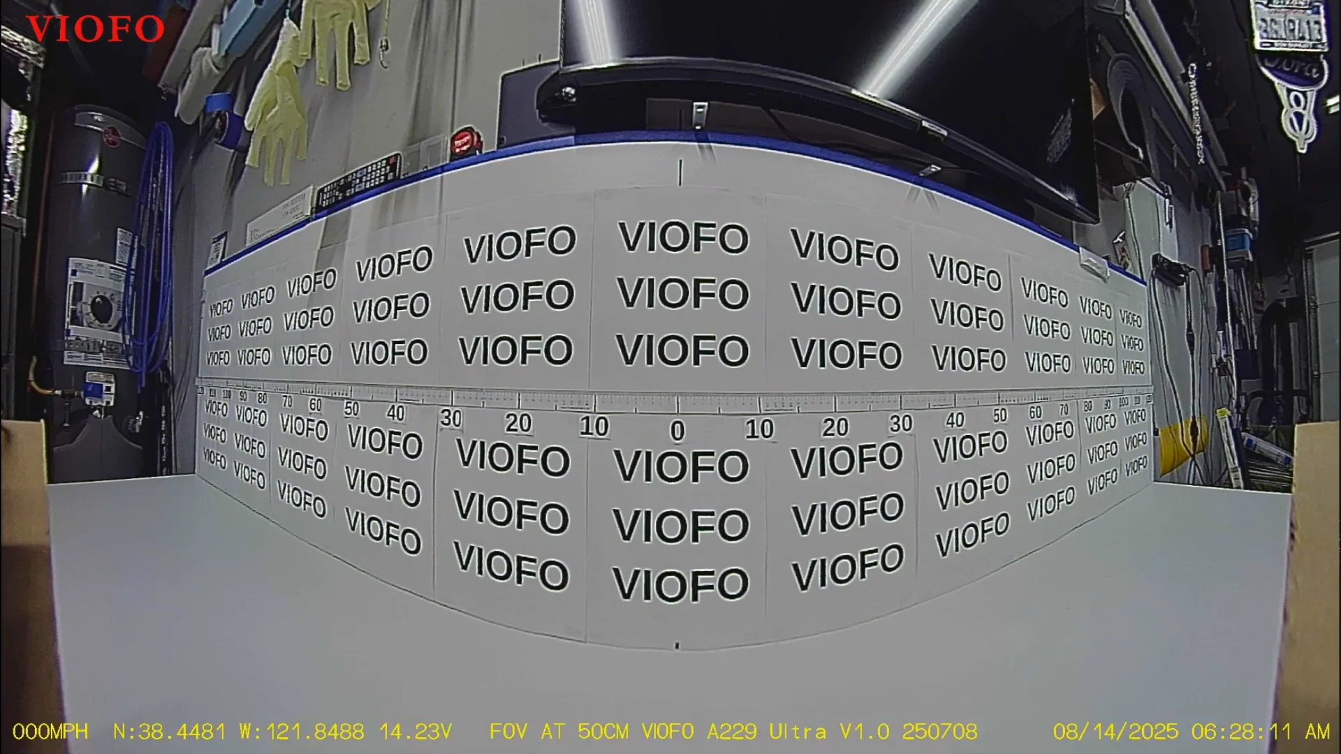

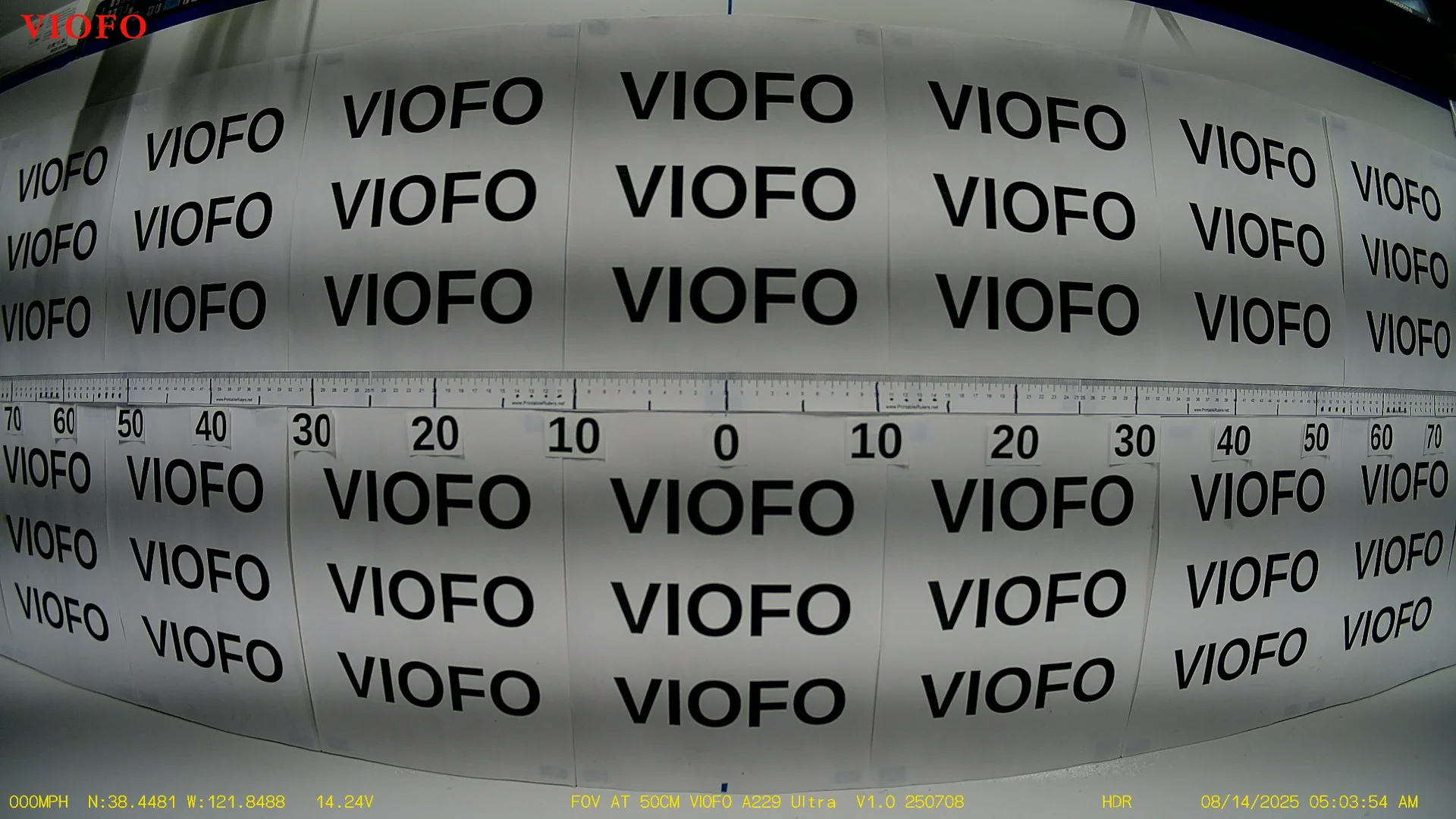

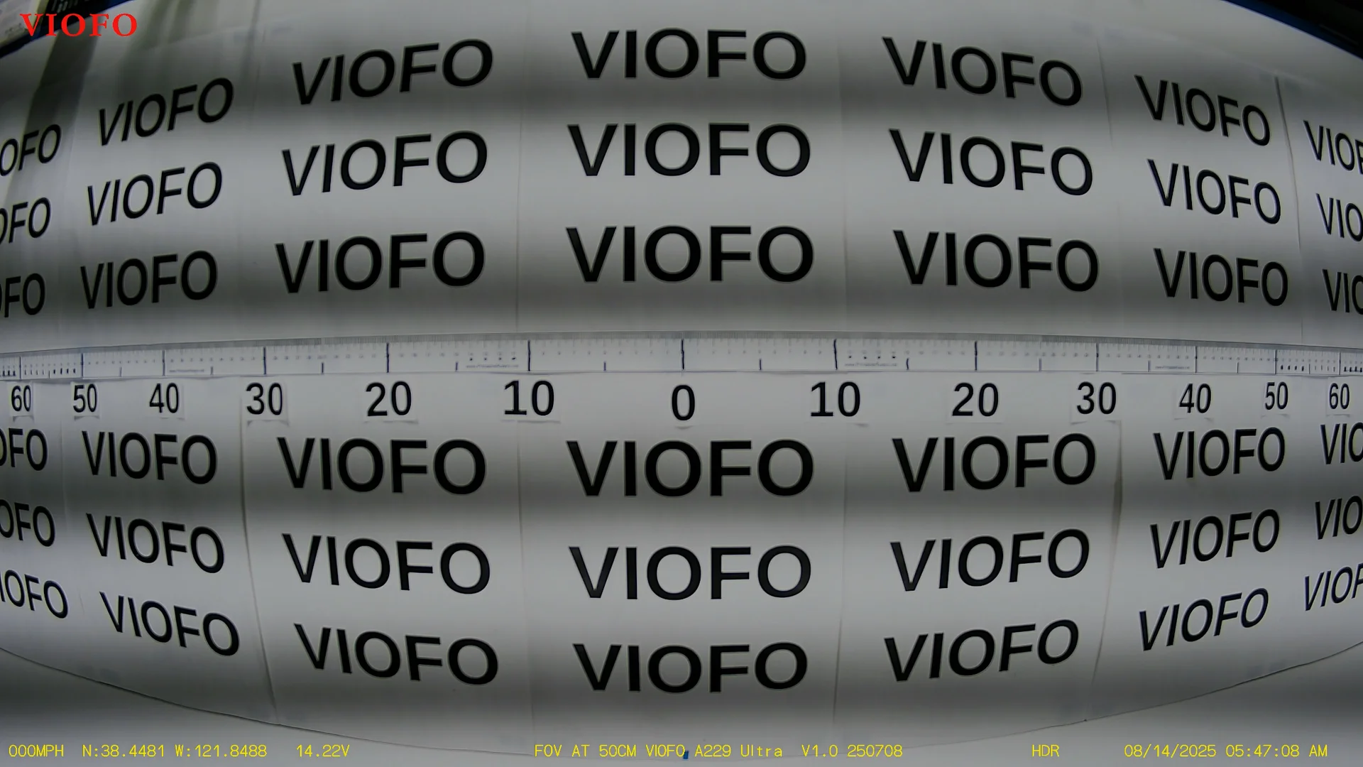

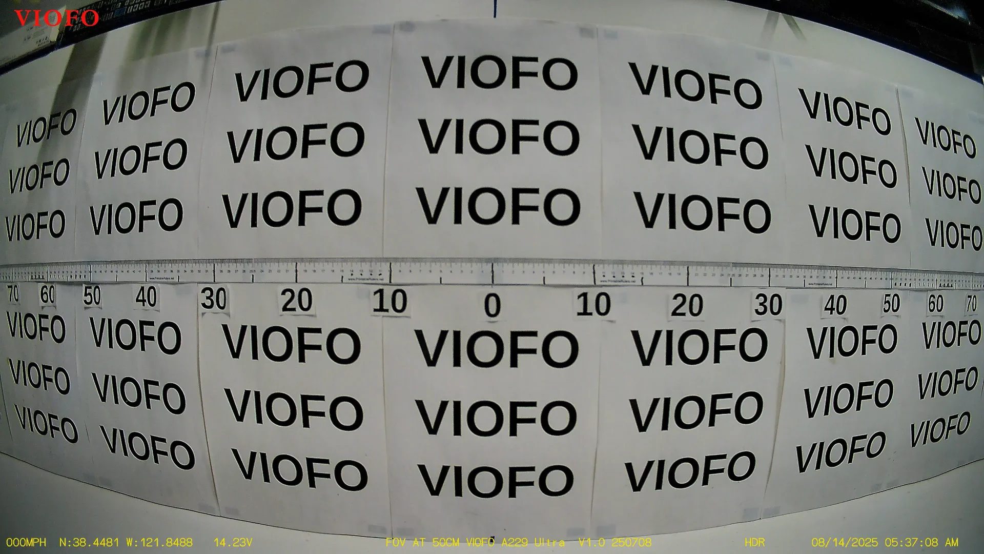

Q: What is the measured Horizontal FOV of A229 Ultra, and all its remote cameras?
A:
112° Horizontal FOV Front
112° Horizontal FOV Rear
104° Horizontal FOV Waterproof Rear
194° Horizontal FOV IR Interior Fisheye
108° Horizontal FOV IR Interior Fisheye (LED’s on in darkness)

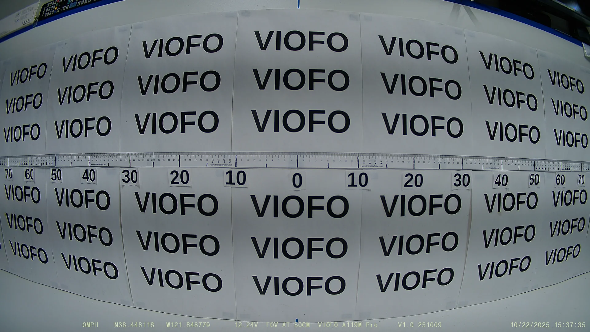

A119M Pro (received 8/12/25)
112.26° FOV

That was a real job making that chart your 45 degree mark needs to be 20.71 cm from the center. And the 90 degree mark at 50 cm from center. But each progressive degree mark must be ever so slightly more distance than the one before. Great job.
Field of view equals the width of what you are seeing at a set distance.
Binoculars might have a FOV of 365 feet at 1000 yards as example.
A rifle scope might have a FOV of 35 feet at 100 yards as example.
Your Angle of View results are probably very accurate as long as your markings measure out correctly.
