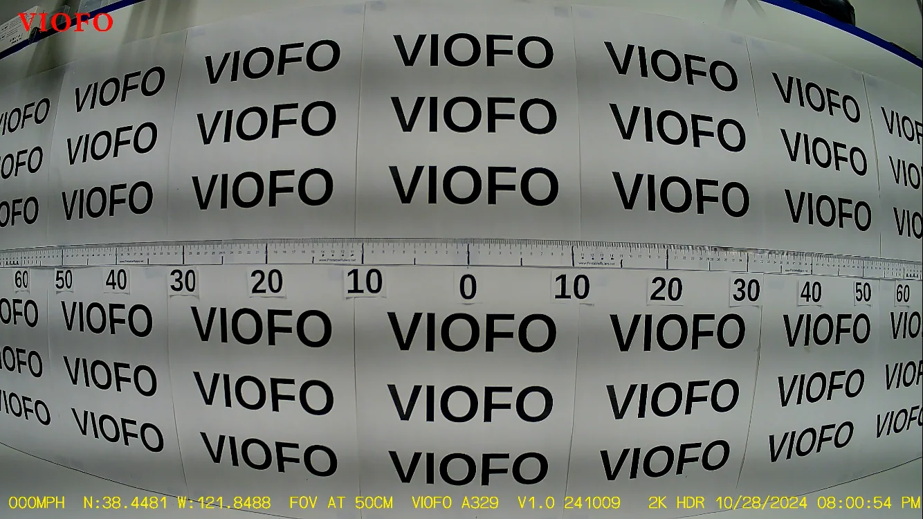

Q: What is the Horizontal FOV of the A329 2-CH, and how does it compare to past Viofo models?
A:
A329 Pro
111° FOV Front
106° FOV Rear

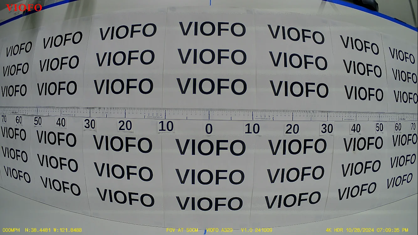

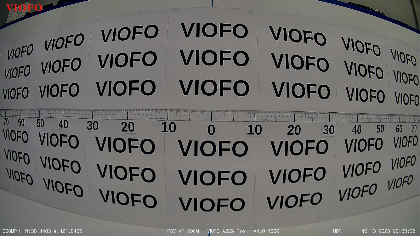

Do you think that the A229 Pro actually gives an extra degree, or is the difference just measurement error or maybe variation between samples?
Looking at your images, it appears to me that the A229 Pro was positioned a little further from the target, thus could see a little wider on the ruler. I think your camera mount is separate to your ruler, so maybe when you set it up, you didn't measure the distance between A229 Pro image sensor and target with the same precision as the others?
The A329 and A139 Pro look like the same lens design to me.
I think the A229 Pro is also the same lens design, just a little further from the ruler.
Same lens design doesn't mean the same lens quality, they may have improved the precision or lens coatings.
I'm not sure what accuracy you should expect to get with these measurements, the A329-A139 Pro comparison images are remarkably close, maybe an error of 1° should be expected.
Interesting, your A329 lens has a warped area on the right side, below centre at the 50 position, not a problem really, but it is warped:
It took me 10 times to get the lens exactly 50cm from the wall, just like I did for all other cameras.
I appreciate your skepticism of margin of error to keep me on my toes.
I make every effort to maintain accuracy of the smallest detail in my testing.
Details are everything.
I stand by my measurement.
I am curious as to the reason for the extra degree, when they appear to be the same lens, clearly there is a difference somewhere. I assume you are measuring to the glass front of the lens, not to the plastic?
It’s not the HDR, it is on for both, but there is a difference somewhere.

Yes, I think if you did make a mistake then it was with the A229 Pro, just remeasuring that one would do. But if the result remains the same, the cause will probably remain a puzzle!

First (just my opinion):
It should be AOV (angle of view), not FOV.
FOV without corresponding depth of field (DOF) is meaningless to me.
FOV should be measured in meters, feet, yards….., and with reference to respective DOV.
The AOV is measured in degrees (°) and is not dependent on distance/depth.
On test results and argument over 1° difference:
Everything has some (±) tolerance, nothing is perfect, i.e. if you take 10 A229 Pros, they will all have slightly different AOV, within the design tolerance, maybe say ±2°, just guessing.
With all due respect to @PP, the tests are also not perfectly identical, even things like slight differences in DVR or ambient temperature can introduce some deviation.
Finally, the test results should be used to draw informed conclusions, such as:
Based on the test results above, all of the following dash cams have the same AOV of 111°±2°:
A139 Pro
A329
A229 Pro
