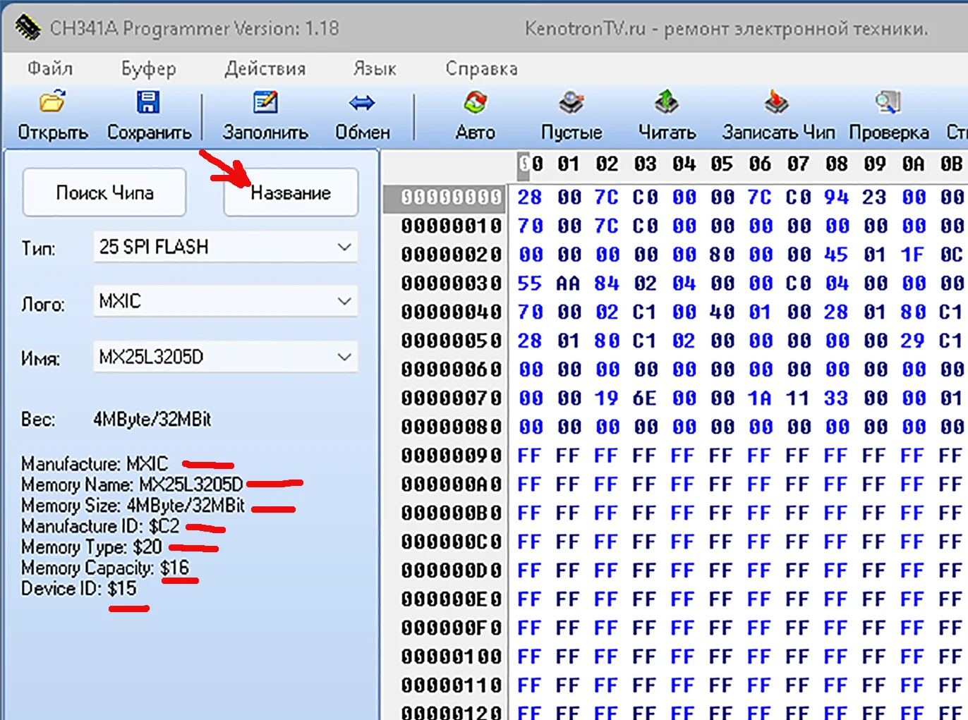

I restored the external camera, flashed it with the programmer !!
Now everything works, thanks to VIOFO for your participation !! 👍
What is the name of CH341 module that you use? Also do you have the pin connection on the camera side?
Thanks,
I do not understand the question!!
Sorry about that. My rear camera broken from the last firmware update and I want to load the firmware to camera like your. So my question are:
What is the module that you was use? I think any CH341 programming module will work but need to be sure.
The pin connections order, but I think I can found the order by looking the chip model on your picture.
Thanks,
module - do you mean the chip name?
There, in CH341, everything is automatically found !!
Press the Name button and everything is OK, the main thing is to connect exactly to the chip pins so that such inscriptions appear red in the photo!!
