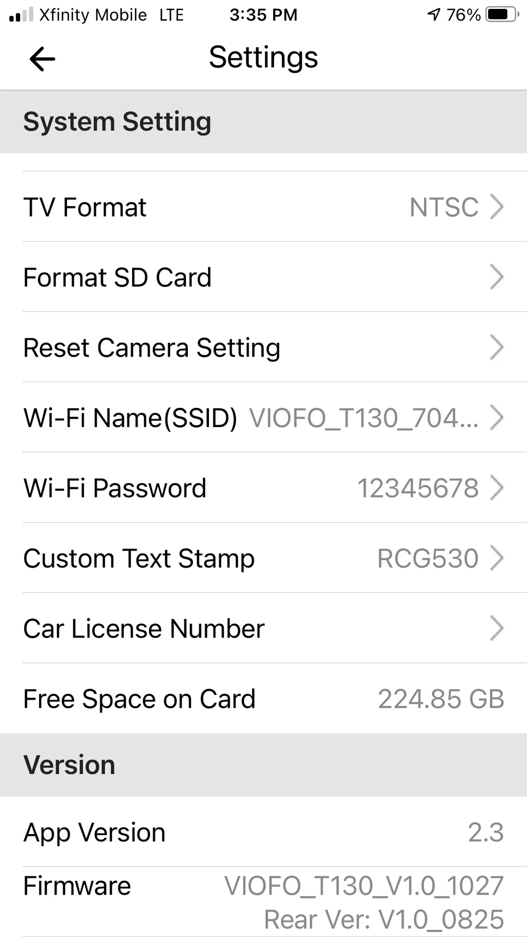

My T130 wasn't shipped by VIOFO until early November 2021. It arrived with the initial production firmware versions for the front / rear cameras of "VIOFO_T130_V1.0_1027" and "Rear Ver: V1.0_0825".
Maybe it is best to verify that with VIOFO, so you are 100% sure it is indeed a retail version.
It is likely a retail version, BUT!, the fact it came with an updated fW version doesn't necessarily mean the camera was fresh from the oven as firmware could be loaded into any old stock device prior shipping.
Would 0906 for the rear be a newer release than 0825? If that is correct then you didn't get the latest. However, my understanding was that the rear camera was being replaced with a different Sony Sensor so it might be the latest for the newer rear sensor.
Did Viofo tell you if you got a later model of rear camera?
Vee-o-fo support told me. (working on relearning the way Viofo pronounce it!)
