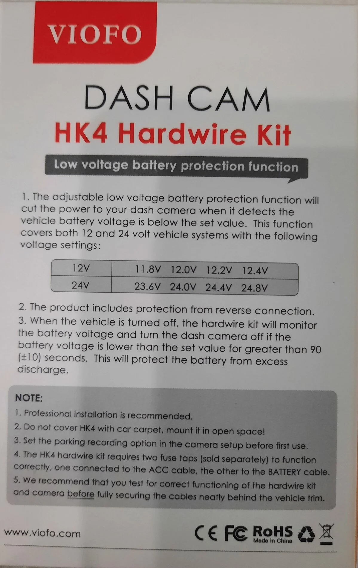

How is the T130 doing in parking mode? Are you experiencing overheating and freezing? I had a bad experience with the A129 plus duo. In hot summer months, when the car interior heats up from 50 to 60С , the A 129 plus duo hung in parking mode, in cool seasons there were no freezes. For this reason, I did not plan to buy A139 at all due to overheating. From the А129 plus duo, I also had to give up, because it is the parking mode that is needed. At the moment I am using two А 119V3 simultaneously. Now I'm interested in T130, so I'm interested in how the camera behaves for heating in parking mode.
It is very very possible that you had problems during summer because you mounted the HK3 in a non ventilated space, the HK3 was covered with some car carpet.
If you will mount the HK4 in the same way you will have the same problems.
I think that Viofo discovered that the incorrect placement of HK3 was the problem for some users with their dashcams during summer. So they added a note on the HK4 gift box hoping people will read it.
I completely agree with that warning from the gift box because it's impossible that just few users to have problems because of heat and the others 99% don't.
If it was a heat problem with a product then all buyers should complain about the same problem.

I had artifacts on the display and the camera did not respond to button presses. jerking the power plug brought the camera to life. if it was in hk3, then I think the camera did not start, while hk3 itself did not de-energize. hk3 is installed behind the dashboard, there is a lot of space and is not covered by anything. When driving for a long time, there are no problems with freezing, although the car was moving in the open sun, the freezes were in parking mode about an hour after being idle. also if you turn off the rear camera, then there was no freeze.
My HW kits are Zip tied to a brace under the dashboard in the driver foot well, i would assume the kits have plenty of berating space, they are mounted so the ventilation holes are not obstructed.
CUZ to me that make sense, if there is ventilation holes in something,,,,,, better not block them.
Never contemplated the HW kits could be the reason for untimely shut downs during parking guard, but thinking about it, that is also a spot for problems.
TBH, I had not thought about it either. I suppose I just saw the voltage cut-off switch as part of the cabling to tidy away. As it happens, in my car the kit is exposed so I can access the switch and see the internal red LED.
