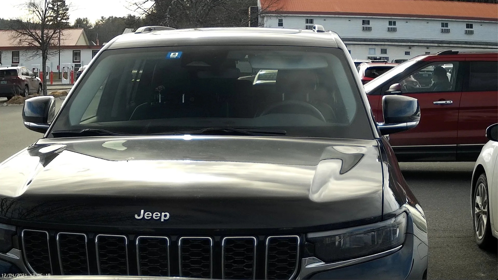

I don't have a lot of time right now because of work so I merely grabbed a convenient (but not the best) example from an archive, but here is an example of a telephoto image where I am parked nose to nose with another vehicle in a parking lot with a telephoto lens - far closer than the 5 meters you claim should be blurry, yet it is tack sharp. Note too that even the Tesla charging stations in the distance on the left side of the image are relatively sharp and in focus.

1080P
The trees in the top left far distance are quite blurry in that image, having them blurry allows for a closer focus than if they were sharper.
I would hope that the Viofo RTC300 would be focused so that the far distance is only soft rather than blurry. There is no need to focus sharply at 1 meter, the standard front camera can read any non-motion blurred plate at less than 5 meters.
The fact is the depth of field can vary due to a number of factors, such as lens design, hyper-focal distance and aperture.
Lens design does not affect depth of field, unless you count choosing the focal length and aperture as lens design,
Hyper-focal distance does not affect depth of field.

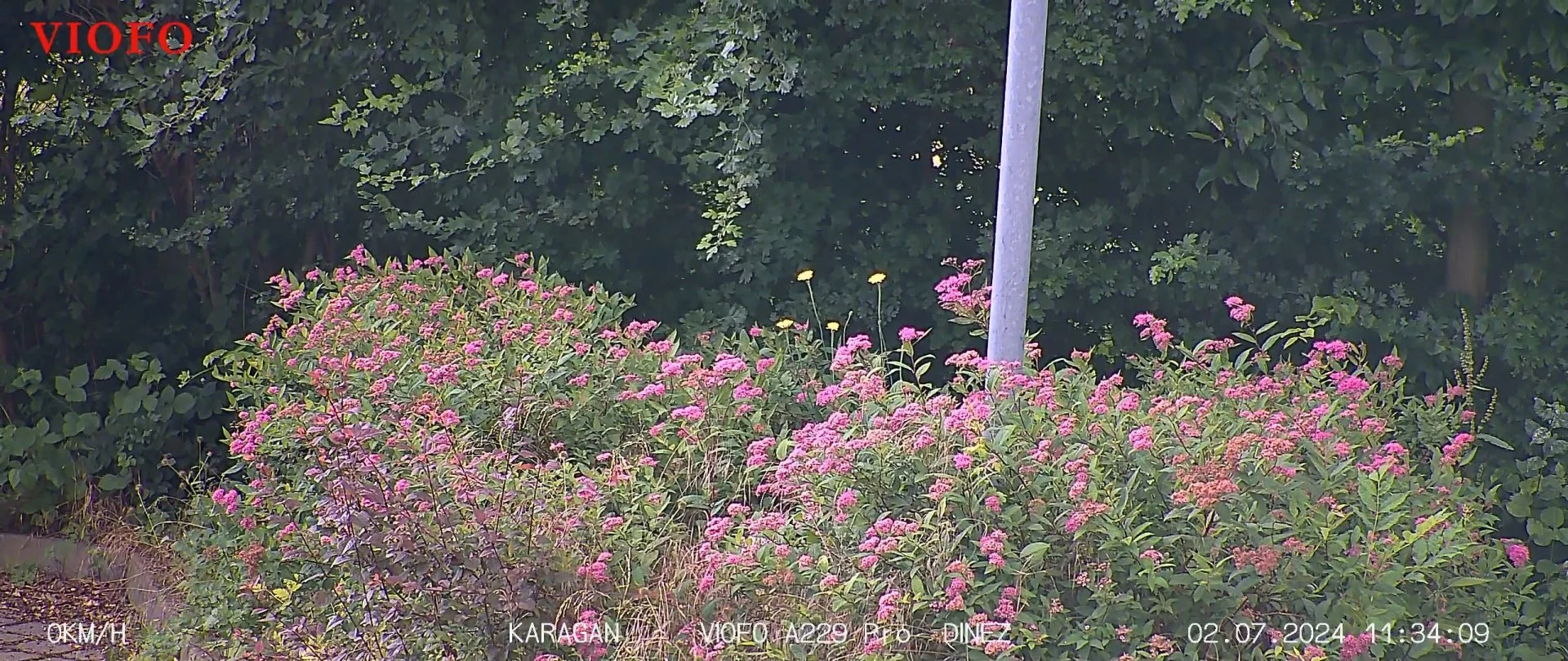

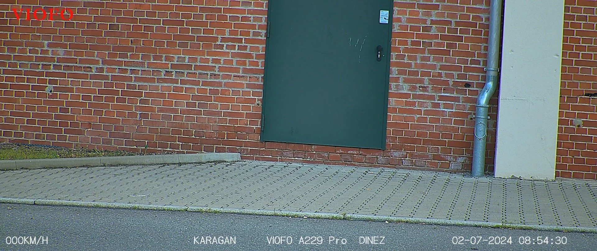

Your image is so clear.
Perhaps there is something wrong with my lens...
Although if you look at the wall everything seems fine.
You're right, that doesn't look so great. Even the brick wall could be a bit sharper in my opinion.
In the image with the flowers the exposure looks off and it's almost as if the sharpening and other parameters set in the firmware need adjusting. On the other hand is it possible that the flowers and leaves are just quivering in the breeze but the brick wall is solid and fixed? I suggest continuing with your testing for now.
My sample image was done with a 1080p Mobius with a 5 Megepixel ƒ/1.6 varifocal lens, from which I generally get excellent results. The thing with the Mobius platforn and the reason I love it so much is that you configure the camera via a Windows based PC GUI that provides the user with a broad range of advanced photographic controls, options and adjustments unavailable on any other dash cam. When you install an aftermarket lens, especially a telephoto you can tweak the image any way you like and often dramatically improve the IQ beyond the default settings. It is a fantasy, I know, but I would love to see a (pehaps hidden) sub-menu on traditional dash cams that would provide advanced photographic controls to those who know what they are doing and want to tune their camera to their exact imaging preferences.
