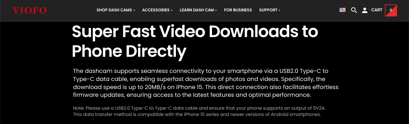

Yes, I upgraded to an iPhone 15 Plus with the USB-C 2.0 connection port.

The iPhone 15 / 15 Plus have USB-C 2.0 connection ports. The iPhone 15 Pro / Pro Max have USB-C 3.2 Gen 2 connection ports. The cable included with the all iPhone 15 phones is only capable of USB-C 2.0 transfer speeds.

Once they get it ironed out I expect Viofo to replace the included 50cm USB Type-A to Type-C data cable with the aforementioned Type-C to Type-C cable.
Such cable should be good also for powering the Viofo dashcam from the USB-C port of the car. After so many problems with dashcams because Skoda had permanent power on their cigarette lighter socket, they decided to put USB-C port at the mirror (as optional). I am sure other manufacturers even american ones are doing this. But right now it is a problem at least with the Skoda mirror USB-C port when using a standard USB-C to USB-C cable for powering a Viofo dashcam. It is still needed and USB-C to USB-A adapter and then the standard Viofo data cable. Maybe such adapter is not needed but only if short USB-C to USB-C short cables exist, but only for charging. But even with that the PD charging is creating problems.
For Viofo I consider this problem to be more important for the new cable.

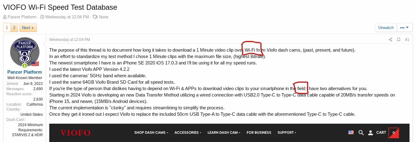

Hereโ€™s a brief summary of Wi-Fi transfer speeds, see each cameraโ€™s dedicated post for detailed information;
13.5MB/s (433MB) 32 Seconds A129 Pro (2019)
11.8MB/s (437MB) 37 Seconds A139 Pro (2022)
10.9MB/s (219MB) 20 Seconds A119 Mini 2 (2023)
10.8MB/s (226MB) 21 Seconds A229 Duo (2022)
10.7MB/s (192MB) 18 Seconds A119 Mini (2022)
9.8MB/s (430MB) 44 Seconds A229 Pro (2023)
8.7MB/s (208MB) 24 Seconds A229 Plus (2023)
2.8MB/s (200MB) 72 Seconds WM1 (2023)
Coming Soon: A129 Plus (2020)
Coming Soon: VS1 (2024)
Hereโ€™s the transfer speeds using the SD Card Reader downloading the same clips, (it's basically twice as fast) or 7X as fast for the WM1;
19.7MB/s (433MB) 22 Seconds A129 Pro (2019)
19.0MB/s (437MB) 23 Seconds A139 Pro (2022)
19.9MB/s (219MB) 11 Seconds A119 Mini 2 (2023)
18.8MB/s (226MB) 12 Seconds A229 Duo (2022)
19.2MB/s (192MB) 10 Seconds A119 Mini (2022)
18.7MB/s (430MB) 23 Seconds A229 Pro (2023)
18.9MB/s (208MB) 11 Seconds A229 Plus (2023)
18.2MB/s (200MB) 11 Seconds WM1 (2023)
