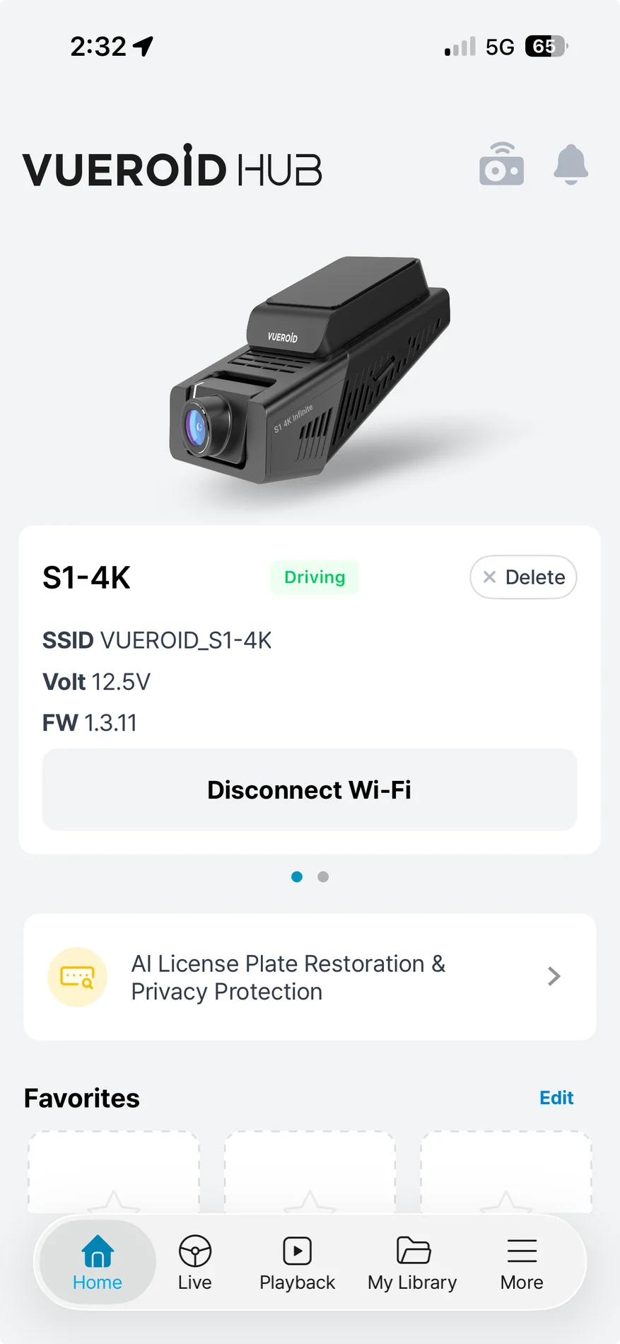

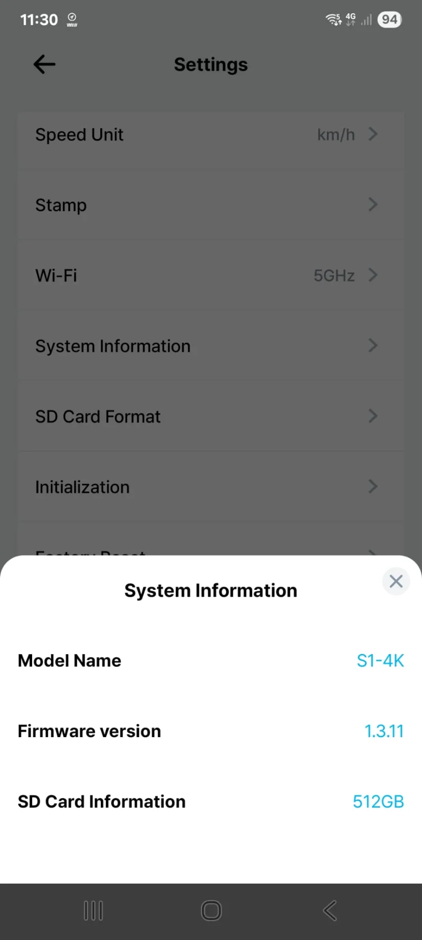

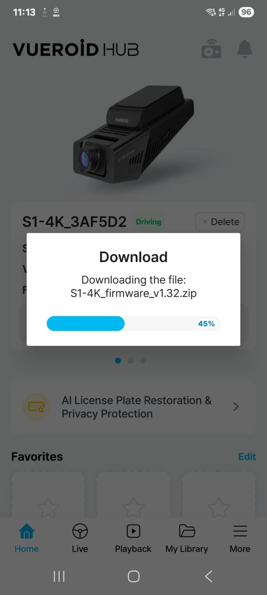

When connecting the app to the S1-4K, a new firmware is downloaded: V1.32
For some reason, after updating the firmware, the menu shows: V1.3.11
Before the update, the firmware was: V1.31
The V1.32 firmware download is actually V1.3.11. The units with the older V1.09 firmware could not understand the longer version number string for 1.3.11, so VUEROID made it available as 1.3.2 so the older units can upgrade to 1.3.11 as well.
