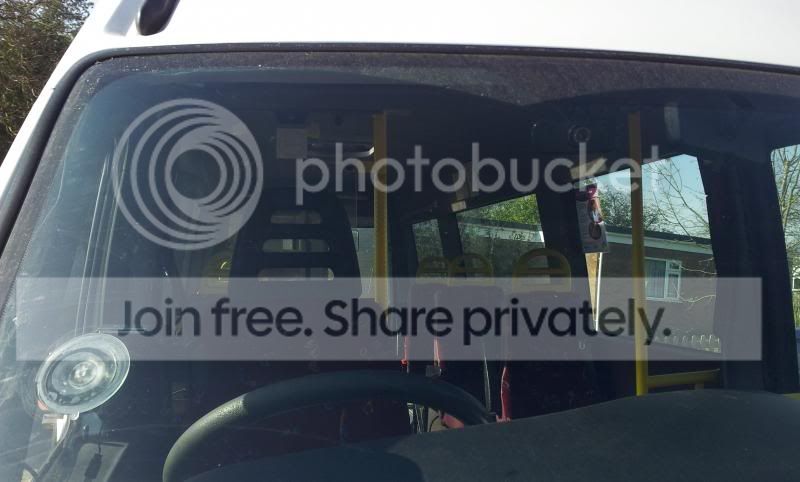

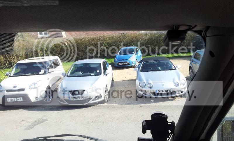

OK, back on topic. Just bought a Mobius to give it a run.
Mounted on a metal strip (meccano), with one end fixed under the sunvisor mounting point (so fixed solid to the roof).
The tripod mount of the Mobius was secured using a plastic number plate screw, trimmed to length.
I used a blob of blu-tac to stop the cam vibrating.
The Mobius is high up on the left, my G1W can just be seen to the left of the mirror.

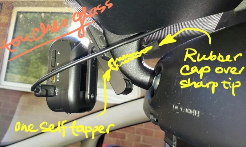

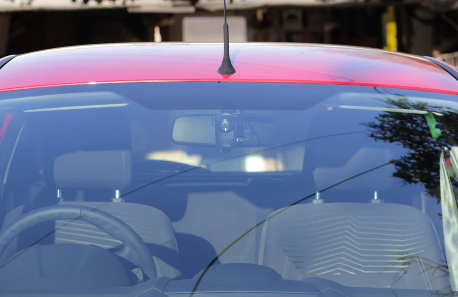

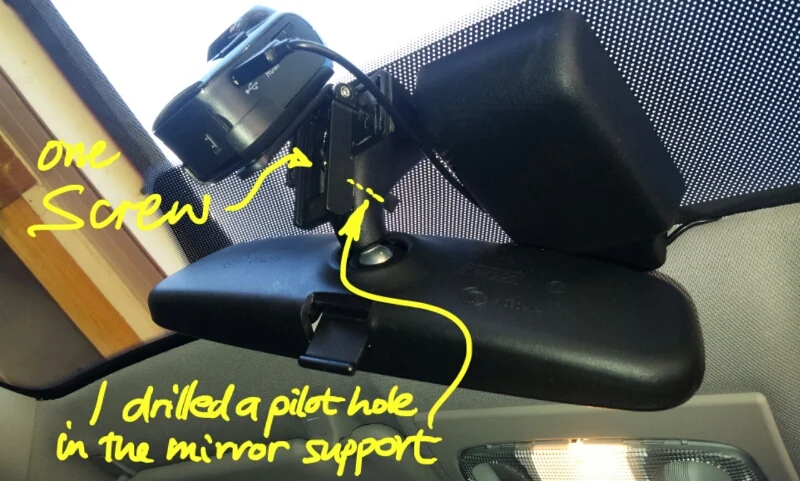

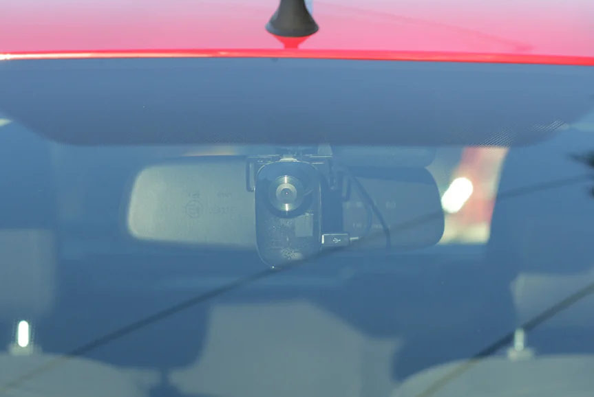

I've had dash-cams before now suckered onto the inside of the windscreen but there are a few problems. They're always pretty visible from outside the car, they're never fitted on the centreline of the car so the films are always a bit lop-sided, and they tend to vibrate on the mount however tight you do up all the knobs.
Ah, but I've found the perfect solution. I've attached the camera to the rear-view mirror support. It's on the car's centreline, it's rock solid so there's no vibration to spoil my movies and it's almost invisible from outside because there's no give-away circular suction-cup showing. It's a total 'what's not to like?' solution as far as I'm concerned.
