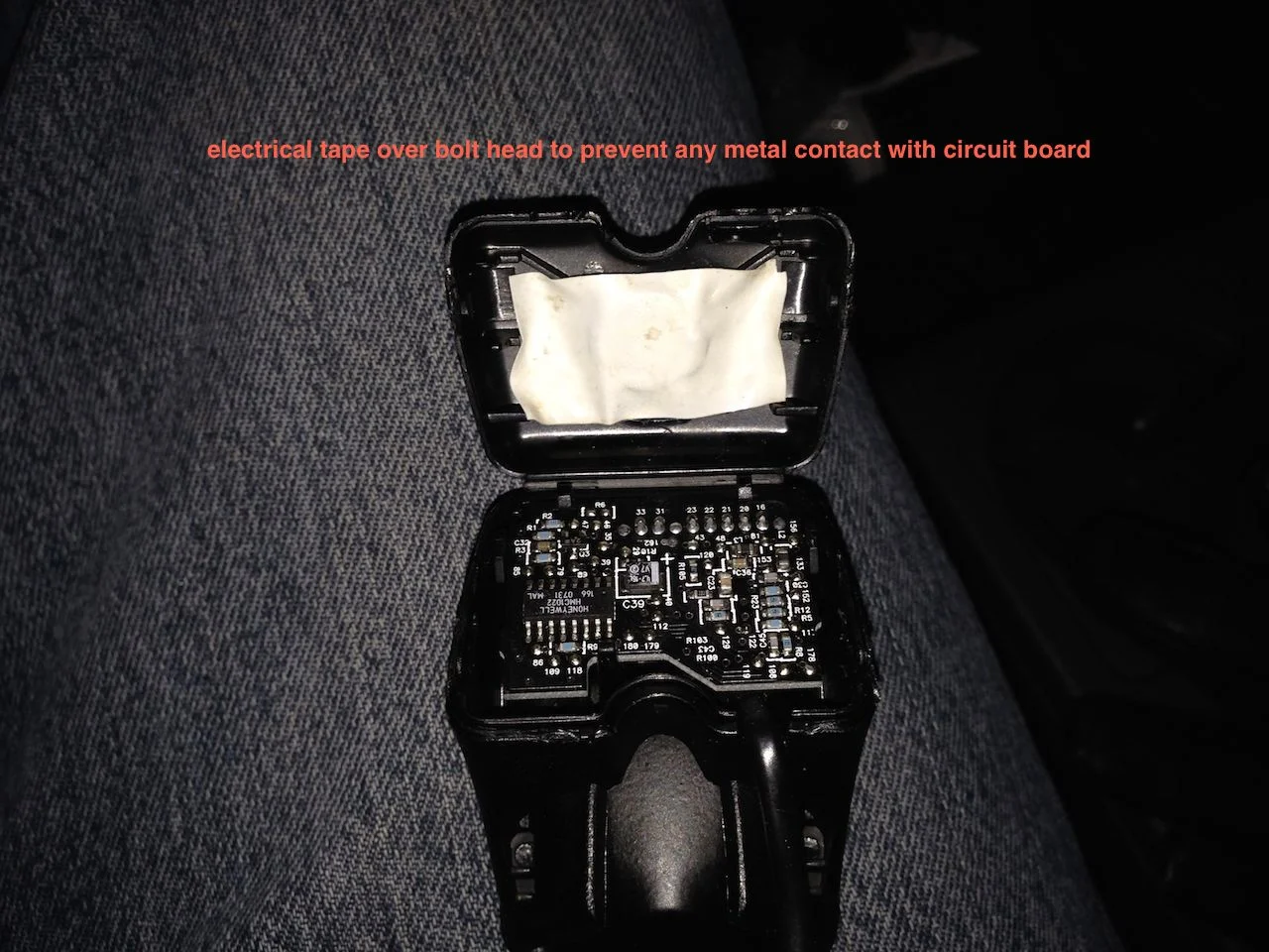

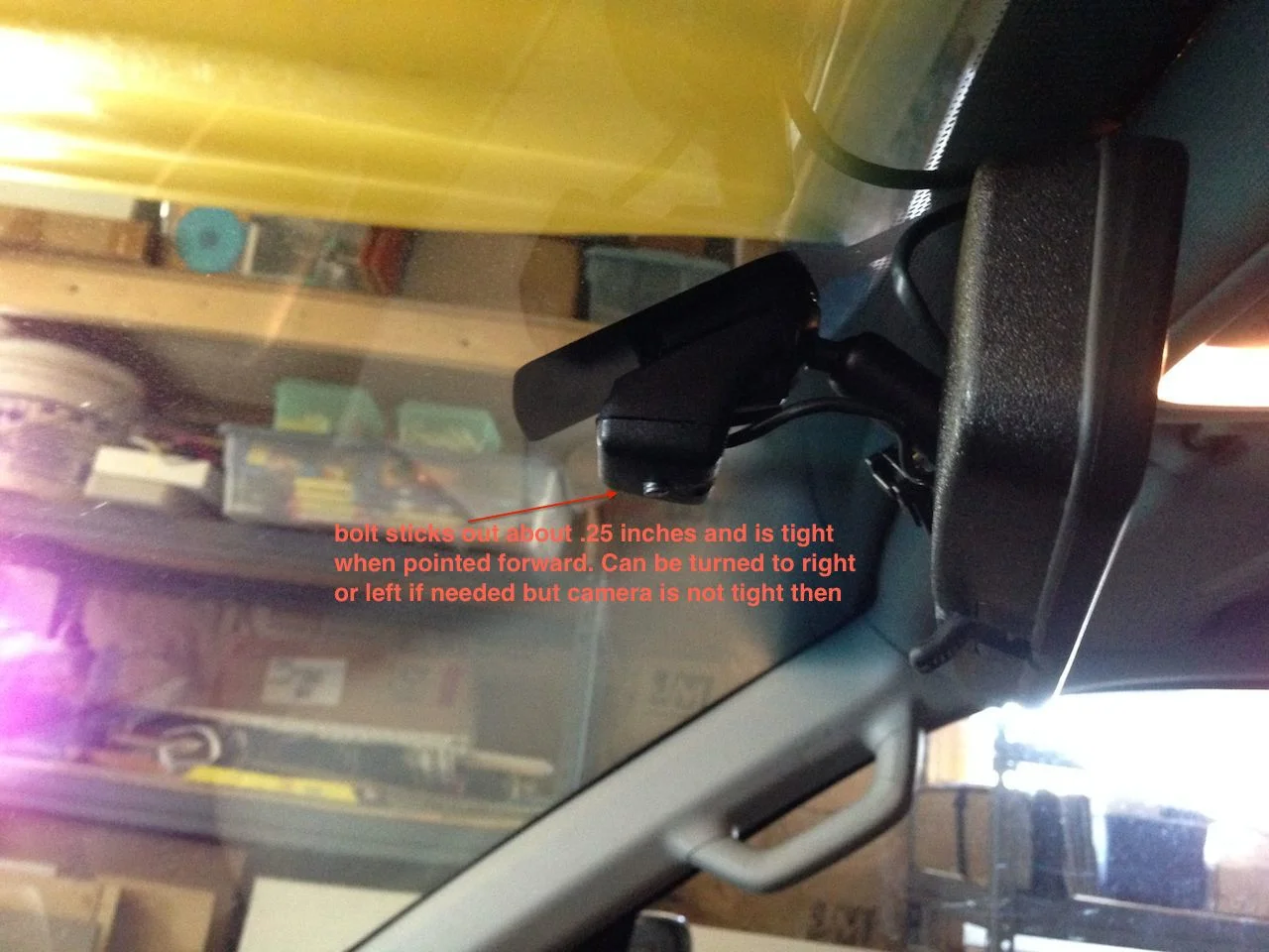

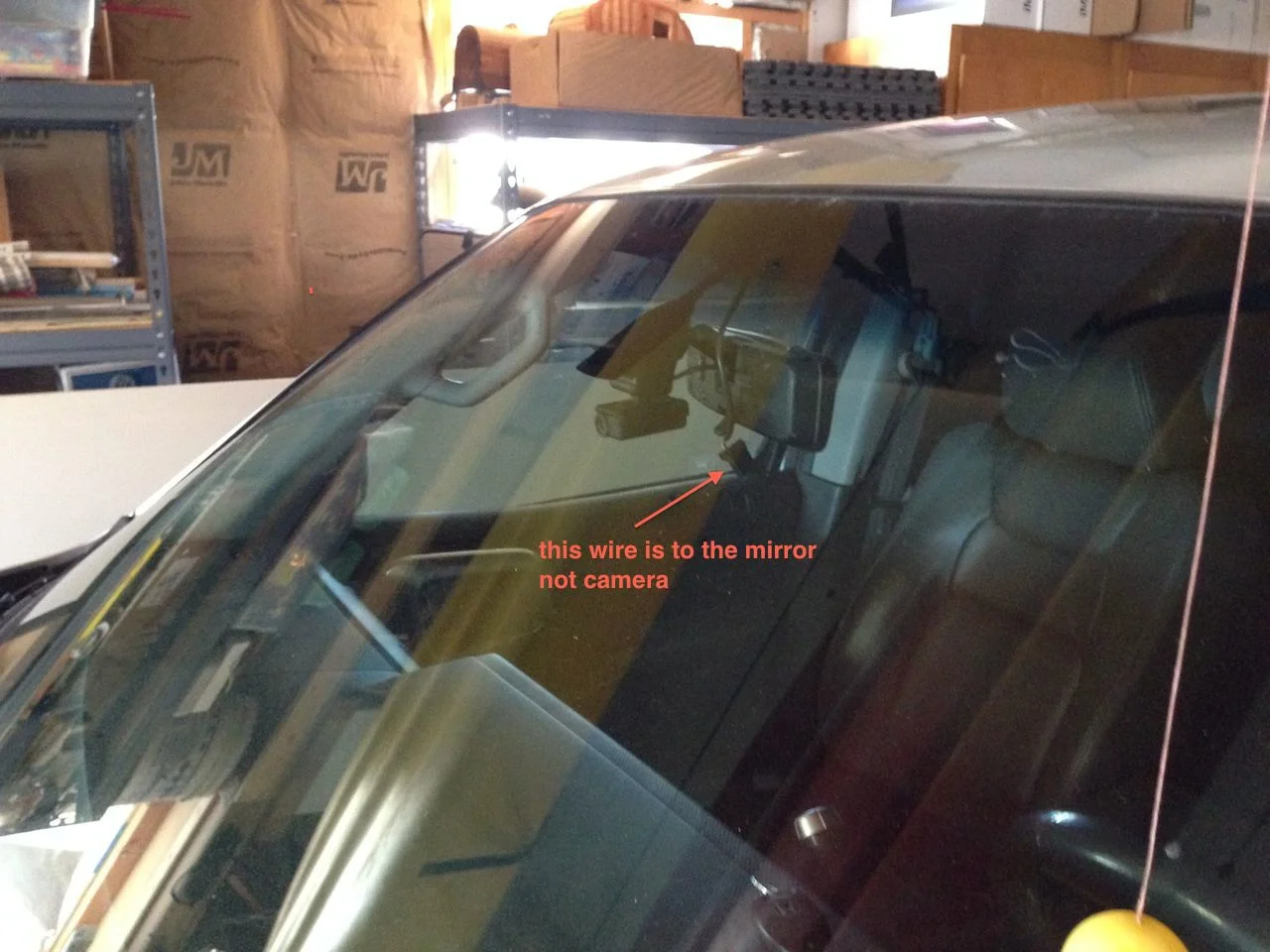

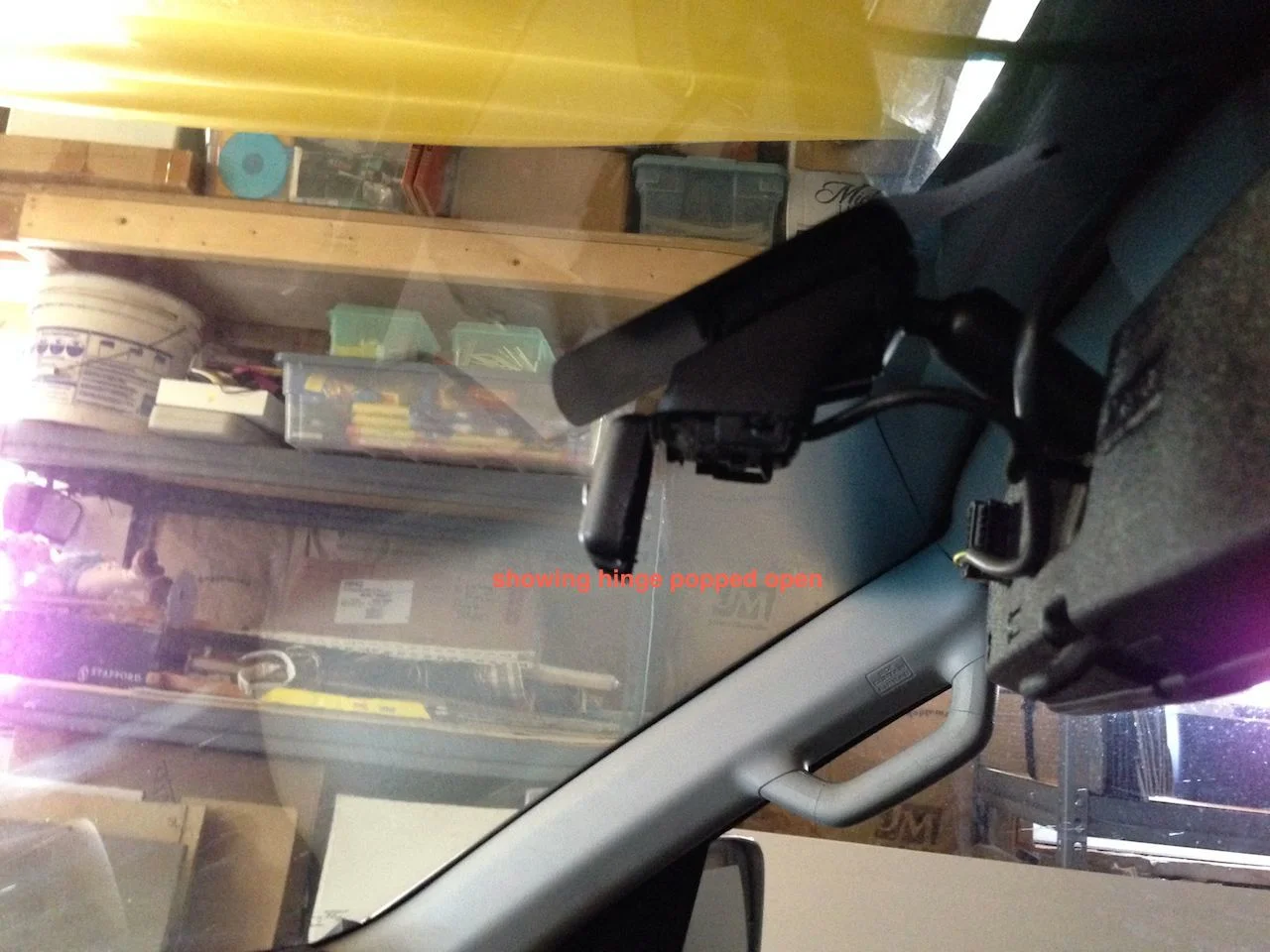

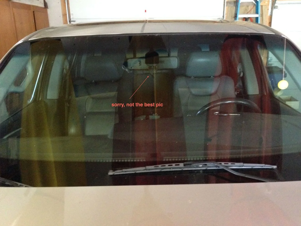

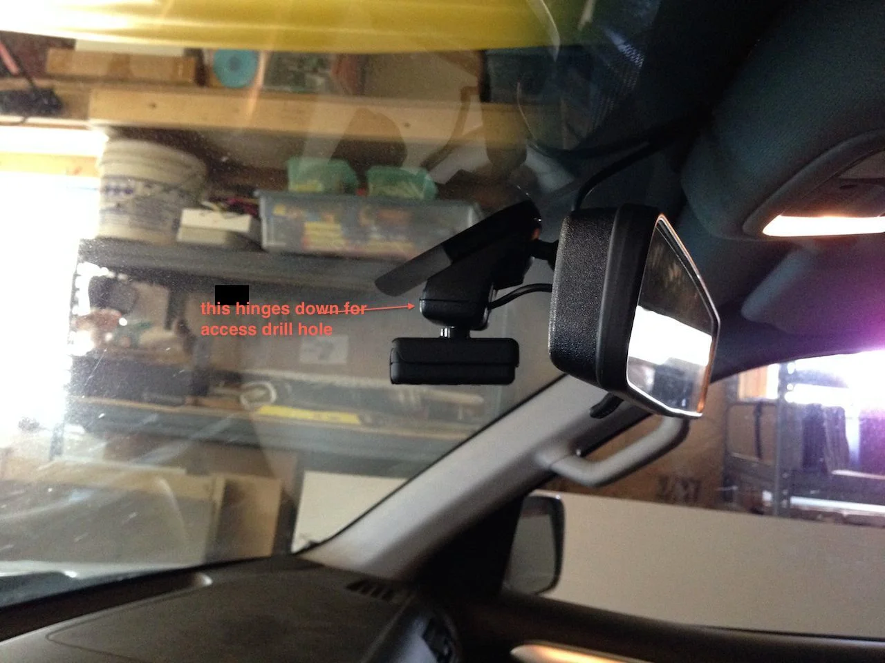

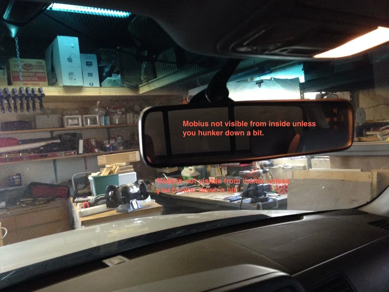

New Mobius owner here. I have a 2007 Honda Ridgeline and mounted my Mobius behind the mirror with just a half inch bolt down off the plastic housing that hinges open for access to a circuit board. Seems very solid. Drove on a badly wash-boarded dirt road yesterday and the video looked great. First time posting pictures so I hope I get it right.

Nice job.
As I understand, you have to screw- and un-screw Mobius every time you want attach-detach it ?
I guess within some period of use there will be some lose connection allowing wobbling if you want to keep mobius to stay straight forward, or how have you resolved this future issue ? I can not see clearly from pictures exact connection, but your idea is interesting. I wish I would had similar over mirror arm surrounding "box", then for sure would try similar approach.
niko - Thanks for giving me some things to think about. In the forth picture (4639) you may notice where it's attached to the bottom of the mirror casing that there is a small gap at the front, meaning the two parts aren't square with each other. This is done on purpose to have the Mobius at the angle I want and not pointing up too high. So where the mount hits the mirror casing behind the bolt is what keeps the Mobius quite snugly aligned. One thing I can do if/when that contact area wears is to attach some very thin felt or rubber to the mirror casing and that will let it be snug again. All part of maintenance. I may work on making a magnetic mount, probably using small thin magnets from dismantled hard drives. I will also hard wire power from the roof console light harness.
great. exactly about "snugly aligned" I meant. I was experimenting 7 month ago similar idea to yours, but after some period of screwing-on, screwing-off, the snugly alignment was gone 🙁
Temporary solution is good as you said @ very thin felt or rubber.
