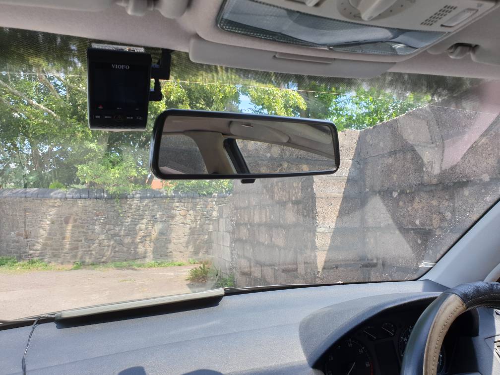

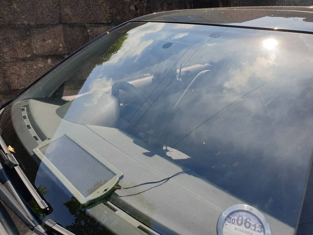

Viofo A129 duo in a Skoda Fabia Mk 1 (similar to VW Polo 9N). Was aiming for as discreet an installation as possible. Front camera not really obvious at all with sun reflecting off windscreen. The sun strip was aftermarket and I put it there years ago.
Was a bit of a challenge getting the rear usb cable through the rubber gaiter, but definitely worth it. Cut a small hole in rear tailgate trim to accommodate the cable.

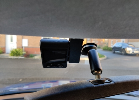

I have the ITB-100HD and in the back a DOD-GSE550.
Because the camera's i had are always black i painted the grey/white rearview mirror to black! 🙂 It wasn't easy, but the result is ok.
I put my camera at the right side of the rearview mirror because the lens it at the left of the camera and i wanted the lens to be as much in the middle of the window as possible. Also i don't want it to be in my view because I like a clean view.
I have grey/white sun visors but hardly use them.
ITB-100HD (black tape over the logo)
Click for larger version!
DOD-GSE550 in the back (went with a black marker over the brand text)

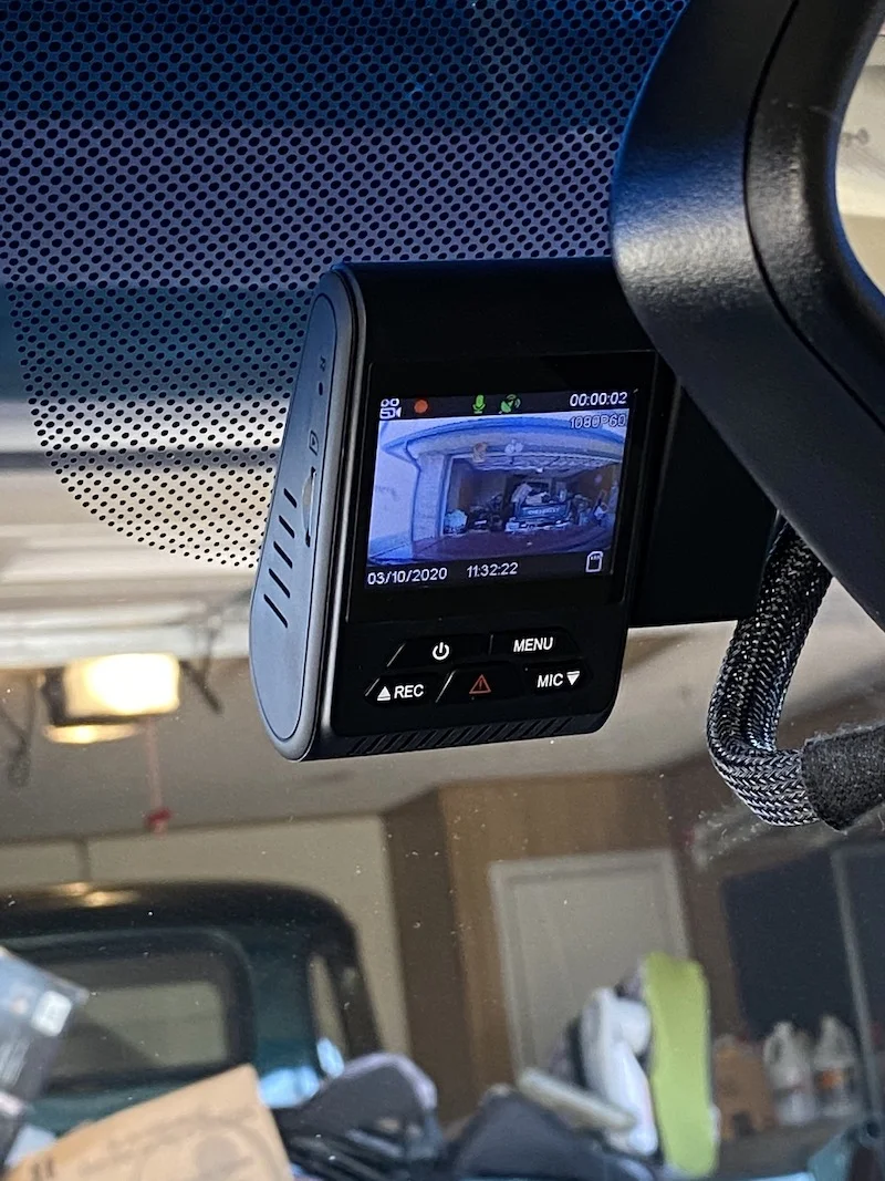

I just installed an SG9663DCPRO. It's mounted just to the left of the mirror in the black dot area with the lens just below it. The outside shot doesn't really show much, so I didn't post it. I moved the mirror so you can see the screen. With the mirror properly positioned, you really can't see the dashcam from inside the car.

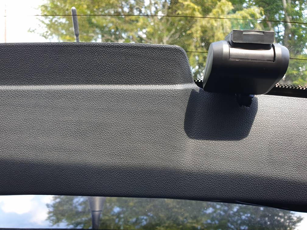

Rear cam stuck to tailgate. I would've loved to route the cable up that rubber piece on the left and out of the grommeted hole but the connector was too big to go through the tube. @jokiin is there anything special about the cables (other than shielding) or could I replace it with one I could fit through? Or use a suitable extension to feed it through and join up?
From outside it's barely noticeable. Unless you get up close of course.
Thanks to the heavily tinted glass and position the rear came is virtually invisible from outside.
I did experiment with having the rear cam mounted to the headlining using some old harddrive magnets. Looked like it would've sat really well but routing the cable wasn't too neat and kept pulling it at an odd angle.
You can see the pictures of that HERE
Still wondering myself where to mount my camera [emoji2] If is hidden behind rear view mirror, the display wouldn't be visible when driving. Also, the space between mirror and the glass is tignt and it will be a bit struggling to remove the camera every time.
If is placed left on the mirror will look a bit noticeable [emoji2]
@MedicalFlyer the cables are not standard and can't be joined, easier to use one of the cables that has a straight connector for the rear camera, it's easier to put through the factory grommet, have done that on my Suzuki, not impossible to get the right angle connector through but it's a lot more work
I thought that was the case. I'll have another play around another day. Just nice to have the camera back in action.
EDIT:
Silly me, should've used the longer cable. Was trying to get it done before it rained and the short one was the perfect length. Might be a nice little job for Christmas day while I'm at work.
Had another go getting the straight cable through. It's a tight fit but a bit of care got it there. Unfortunately due to the small amount of space to play with it meant the rear cam has ended up mounted to the glass otherwise the USB connector would interfere with the boot closing and something may break. Much tidier for the cable now though with the excess coiled up behind the rear pillar trim. It stands out in the rear view a bit but doesn't obstruct your view and is impossible to see from outside unless you really try.
