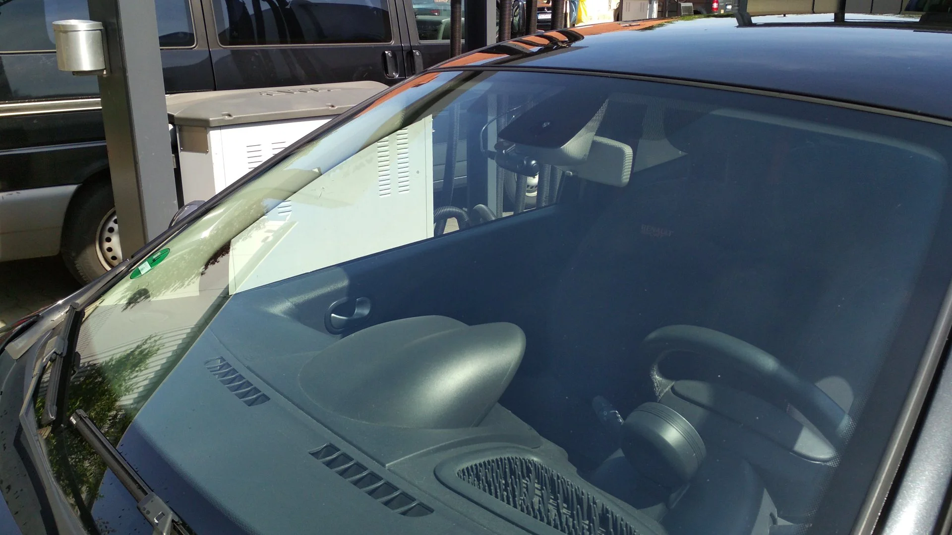

B1W in a Renault Twingo II RS
Cable fed through the front of the headliner, through the A pillar trim (no airbags in there) and door seals and down to the fuse box below the dash
