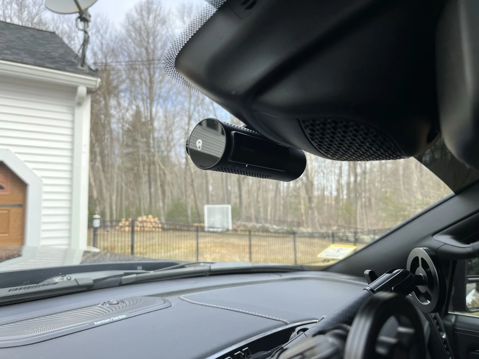

On my 2023 RAM 3500 I mounted my Blackvue 970x Plus right under the mirror on the windshield, came out nice and clean. Also ran the power right and off the center overhead console. Super easy

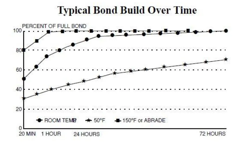

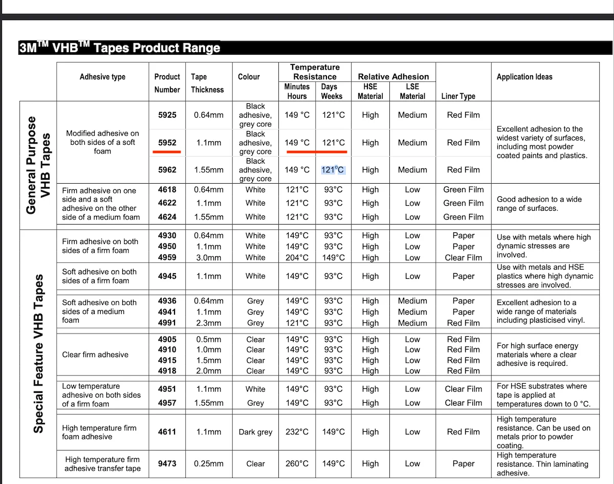

There are many types of 3M VHB (very high bond) tape available but most dash cams use type 5952. It is not uncommon to have dash cam tape fail in hot weather but in theory there is no reason this should happen.
This tape is rated to hold securely at temperatures for up to days or weeks at 121ºC and up to hours at 149 ºC.
Clean the glass very thoroughly with isopropyl alcohol or 50% alcohol and water using a lint free cloth before applying the tape.
The ideal temperature for application is between 70ºF to 100ºF (21ºC to 38ºC)
It is very important to apply the mounting tape properly when installing a camera and to let it cure (bond) for as much as 72 hours (depending on the temperature) before applying weight. (such as your camera)
Another reason dash cam tape can fail is because it has a shelf life and it is not uncommon for manufacturers to knowingly or unknowingly use out of date tape during assembly of their cameras.
After applying your new 3M double-sided tape, you might want to give it another try in hot weather and see if you get better results. You may just be surprised to have better luck this time.

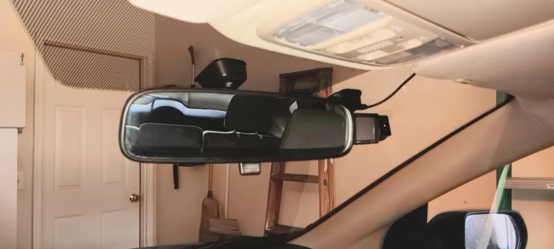

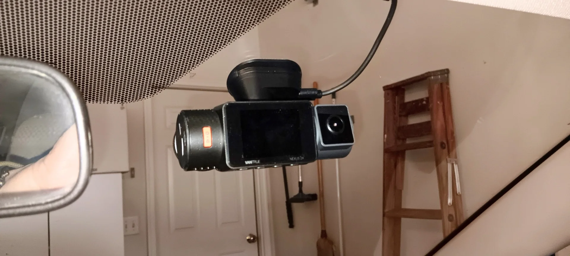

Vantrue N2X mounted in my Honda CR-V. I removed a Viofo A119v3. Because of the difference in body geometry and lens placement I had to locate the Vantrue a bit higher, and farther to the side, to avoid getting any of the fritted area of the glass in the frame. The Viofo was mounted directly to the glass because the static sheet would not reliably cling to the fritted glass. After two years the adhesive was easier to remove than I had expected.

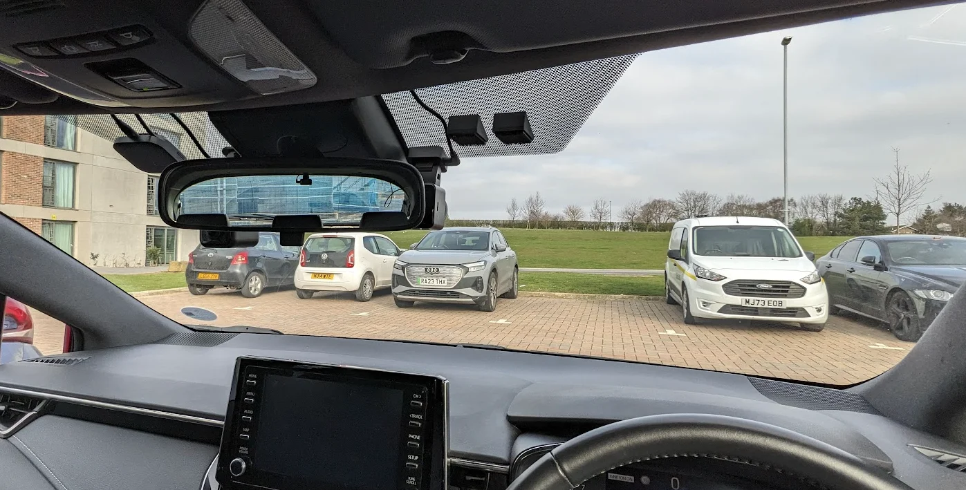

Latest test setup, from driver's viewpoint.

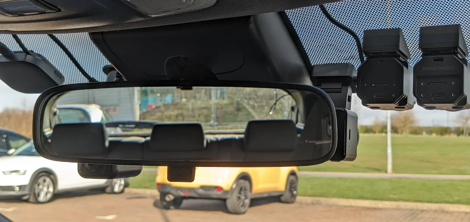

From left to right: Vantrue LT01 (LTE module), Vantrue E360, Vantrue E1 Pro, Mobius SLL, Mobius SLL
Those 3D printed wedges seen some action by now.
Yes they have. I had them made for my previous car in 2019. I was happily surprised to find that they work on my new car too 👍

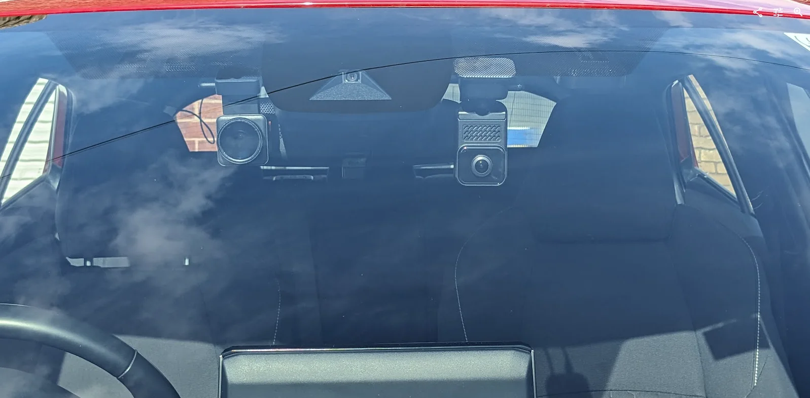

I like that the E1 is almost small enough to hide behind the rear view mirror - on the driver's side
My E1 Pro also hides neatly behind the mirror. Even with the suction cup it is nearly invisible form the drivers seat.
