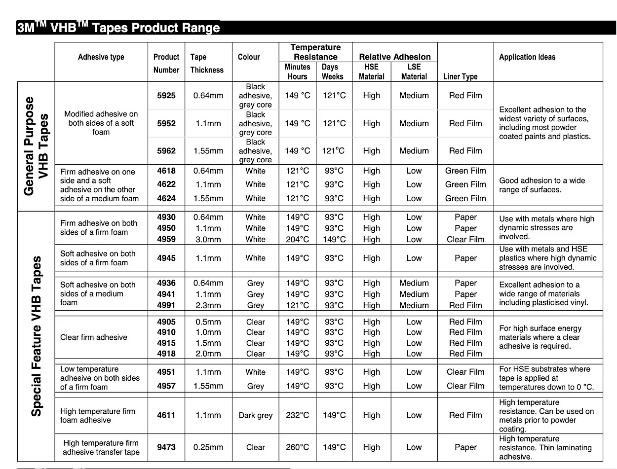

This is not necessarily true. It depends on which type of tape you use. Most dash cams come with type #5952 BLACK 3M VHB tape which can indeed be difficult to remove from some surfaces. However, 3M (Scotch) makes a wide range of different but similar tapes. I have found that 3M's GREY type #4991 VHB tape or other GREY outdoor tapes in the same #49XX family work well on automotive plastic but can be easily peeled off even after years and leave no residue.
I used long strips of this tape to mount a dash mat on my dashboard for almost 5 years but when I needed to remove it the tape peeled off fairly easily and you wouldn't even know it had been there. The black #5952 tape would have been a nighmare to remove.
Usually, for consumers these tapes are marketed under the Scotch brand instead of 3M VHB and they do not mention the product family number on the package but it is usually marketed as "Outdoor" tape or "Extreme" tape and the color will be grey.
You can also search for 3M VHB #4991 but in that form it usually comes in longer rolls for industrial purposes.

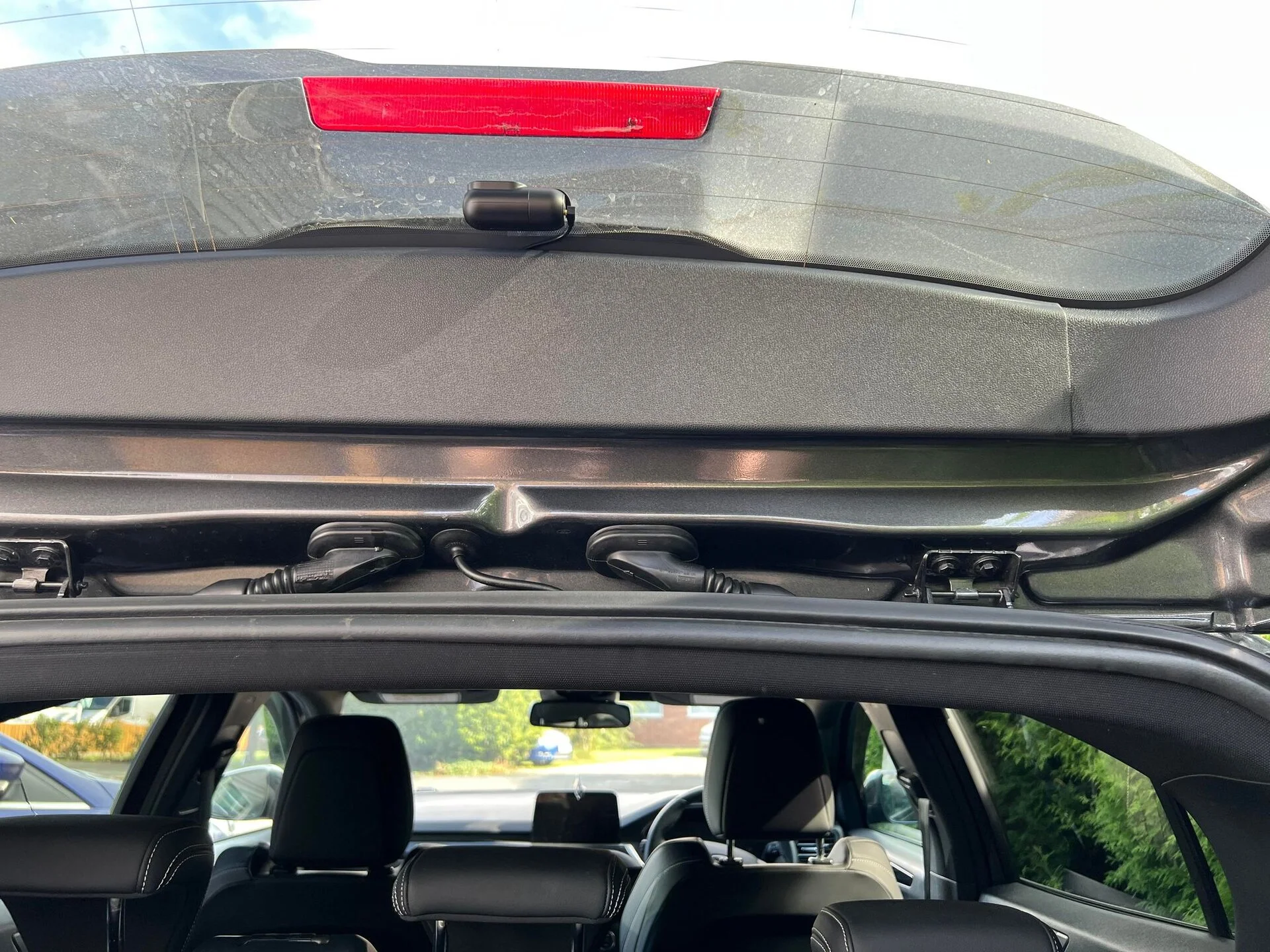

The sensor cover look nice and flat on the bottom, so you could mount there , just be aware that you might have to use another dual sided tape than the one that come with the dashcam.
Personally i would be inclined to put a camera there.
Thanks for your feedback. Why I have to use another dual sided tape? Camere cames with aonther spare one. Should I use a different one?
The tape that come with the dashcams are made for fairly smooth surfaces so it might not work on the trim plastic of the sensor housing, a lot have done that and later the dashcam come loose.
There is a reason 3M that make the tapes have so many different models of tape.
I have tried some times moving a dashcam in my car, then for some strange reason the tape will no longer work on the plastic of the mount, even if i have been very careful cleaning it and even sanding it.
Very strange. So i just put some CA glue on the 2 parts and stick them together again, then they will stick together. Just strange when i use the original tape and all.
But i would not put CA glue between the glass or car trim plastics of course, but between sticky tape and plastic mount its OK as i will not move the camera a 3 time, and even so i can still clean and sand the surface again.
That's a good point. You'll notice that on the chart I posted above, black type #5952 VHB is only 1.1mm thick and uses a different adhesive than the grey type #4991 VHB which is 2.3mm thick and uses a soft adhesive. Type #4991 VHB is also shown to have good adhesion properties with plasticized vinyl which is what a lot of car interior plastics are made of.
A thicker, softer two sided foam tape is more likely to conform and adhere well to the rough, dimpled surfaces often found on sensor housings.
Thank you. So I have to find and buy a Type #4991 VHB 3M tape and to fit between the sensors case and the camera adhesive part. I will do it like this.
Unless you want to buy a big commercial roll of #4991 VHB (on Amazon for example) it will be difficult to find it in a smaller quantity. The best thing is to look for Scotch Mount Outdoor double-sided mounting tape. I've recently learned that they changed to a new packaging that looks like the one posted here instead of the photo I posted the other day even though it is the same product.
Unfortunately, when 3M markets their products under the Scotch brand for consumers they don't give you their product designations such as #4991, so I'm not 100% certain if it is indeed #4991 but I believe it to be because it meets the description and performance. (softer-thicker-works on plasticized vinyl) It is the grey 3M VHB product that I have used on interior auto plastic with good success. I think it should work for your installation. Make sure to clean surfaces thoroughly with ispropyl alcohol before applying.
I have found only this kind of SCOTCH 3M tapes:
Both are gray colored and seems to be 2.3mm thick. No datasheet found on the internet. Could be ok to order?
Thank you.
View attachment 66237View attachment 66238
Thank you.
If you look at the photo in my post of the version of the tape I was referring to it is a light color gray. The Extreme tapes in your photo may look dark gray but that tape is actually a black color.
I think the tape you found should probably work for your purposes. If you can't find anything else I would go ahead and give it a try.
It may be that the tape will be more difficult to remove in the future than the light gray version but if it leaves some residue some rubbing alcohol should fix that.
