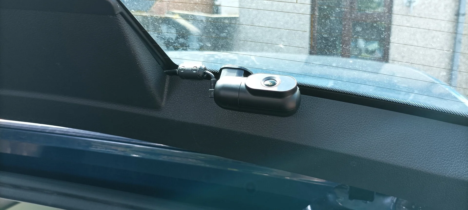

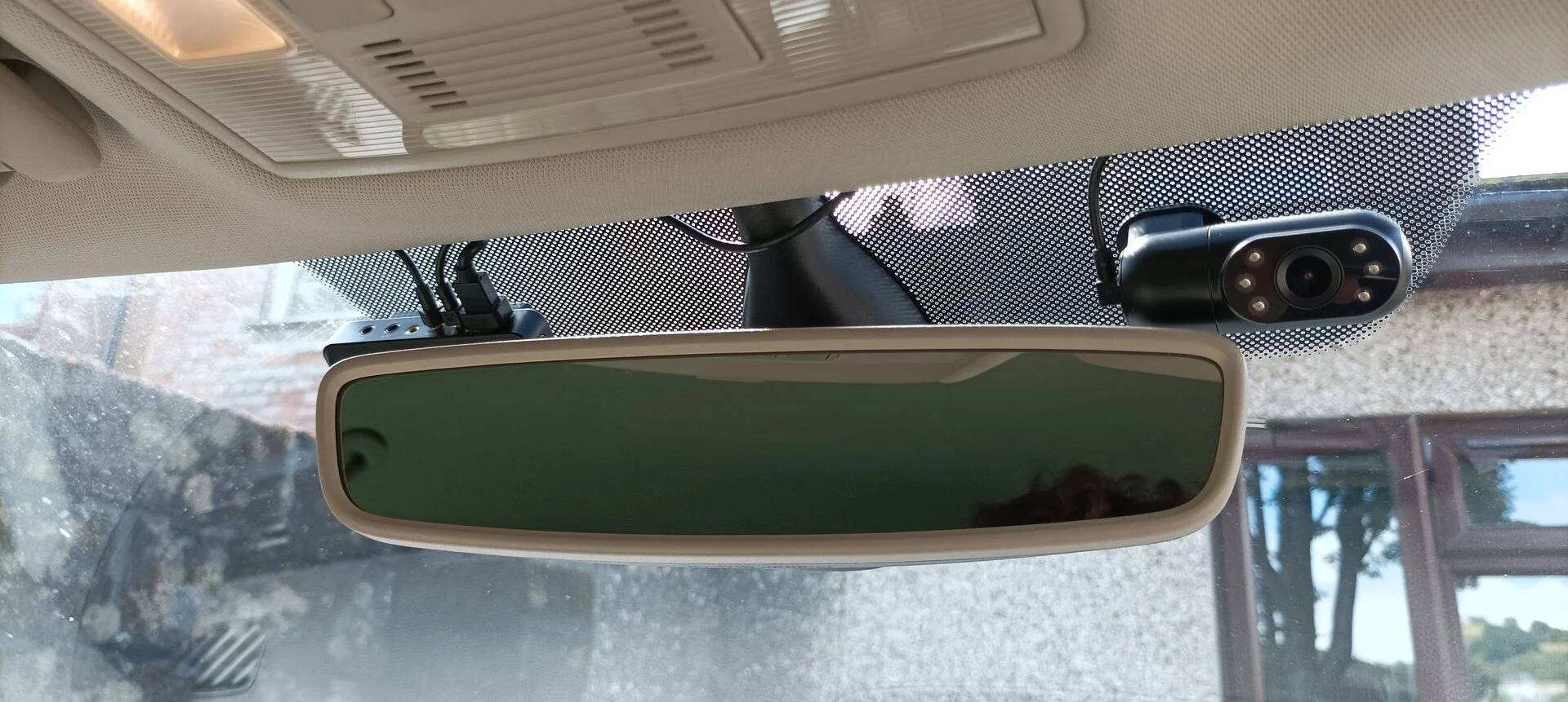

Viofo A139 3ch in a Skoda Superb mk3 hatchback.
I ended up moving the interior camera slightly to the left after taking this photo, due to view being obscured by the sun visor when that was down.
I much prefer the view the interior camera provides mounted roughly halfway down vertically on the passenger side as that gives a full interior view and a head on view of the driver's side window which might be good for sideswipes and vandalism. However that would be much less discreet than being hidden away above the mirror. I'm somewhat tempted to remove the interior camera and keep it 2ch.

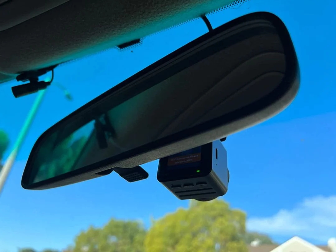

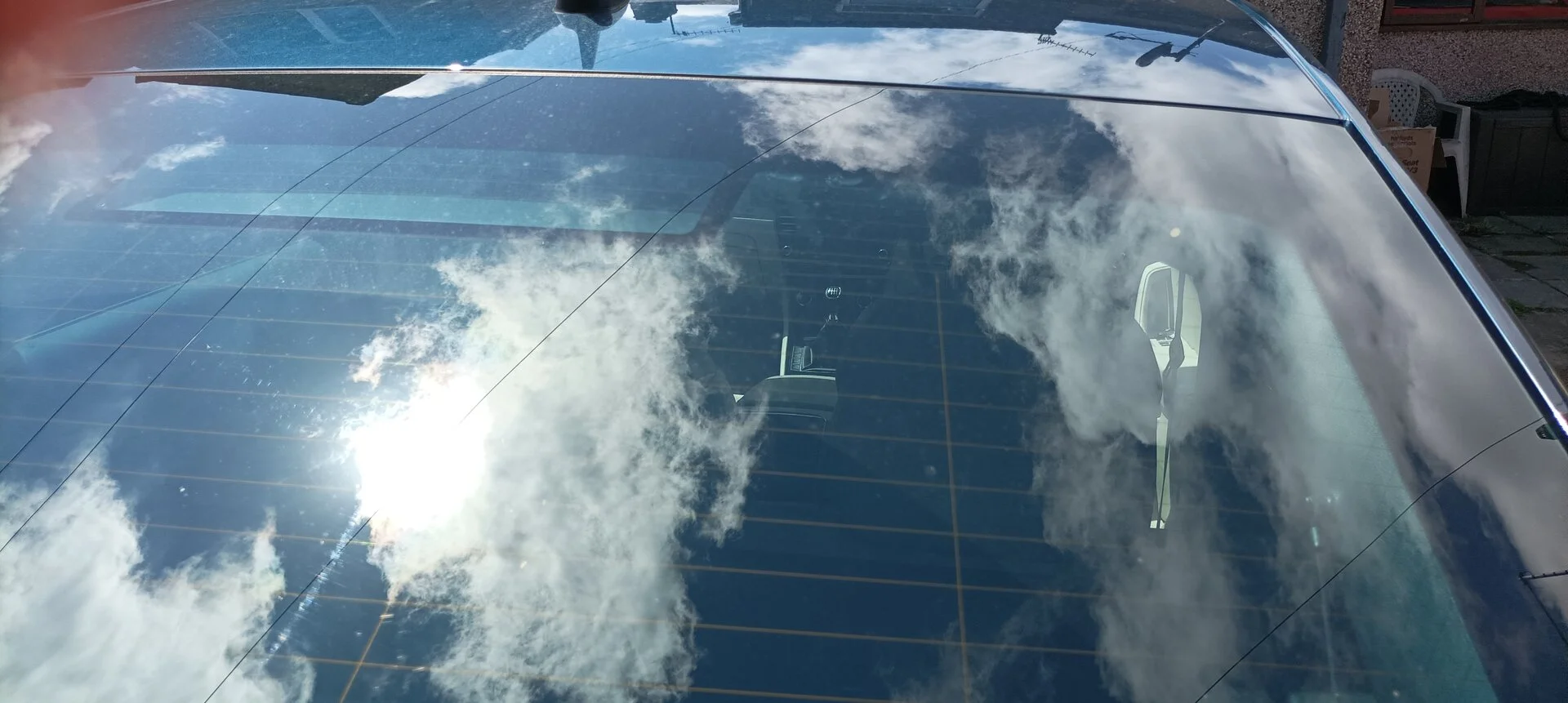

Rear camera mounted next to high level brake light. DAB radio seems more inclined to dropout after installing this. Ferrite cores helped but didn't fully cure the problem. Planning to look into metal sleeving for the cable and/or relocating the camera and cable.
I have often contemplated a cabin camera on the passenger side A pillar, down low on it, and then aimed at the driver.
This would probably not be a good place if you do any form of ride share, but as a driver logger + whatever might show up at the drivers door it would be fine.
Still i do get out of my car when i get pulled over as i dont like police or anyone else hovering above me

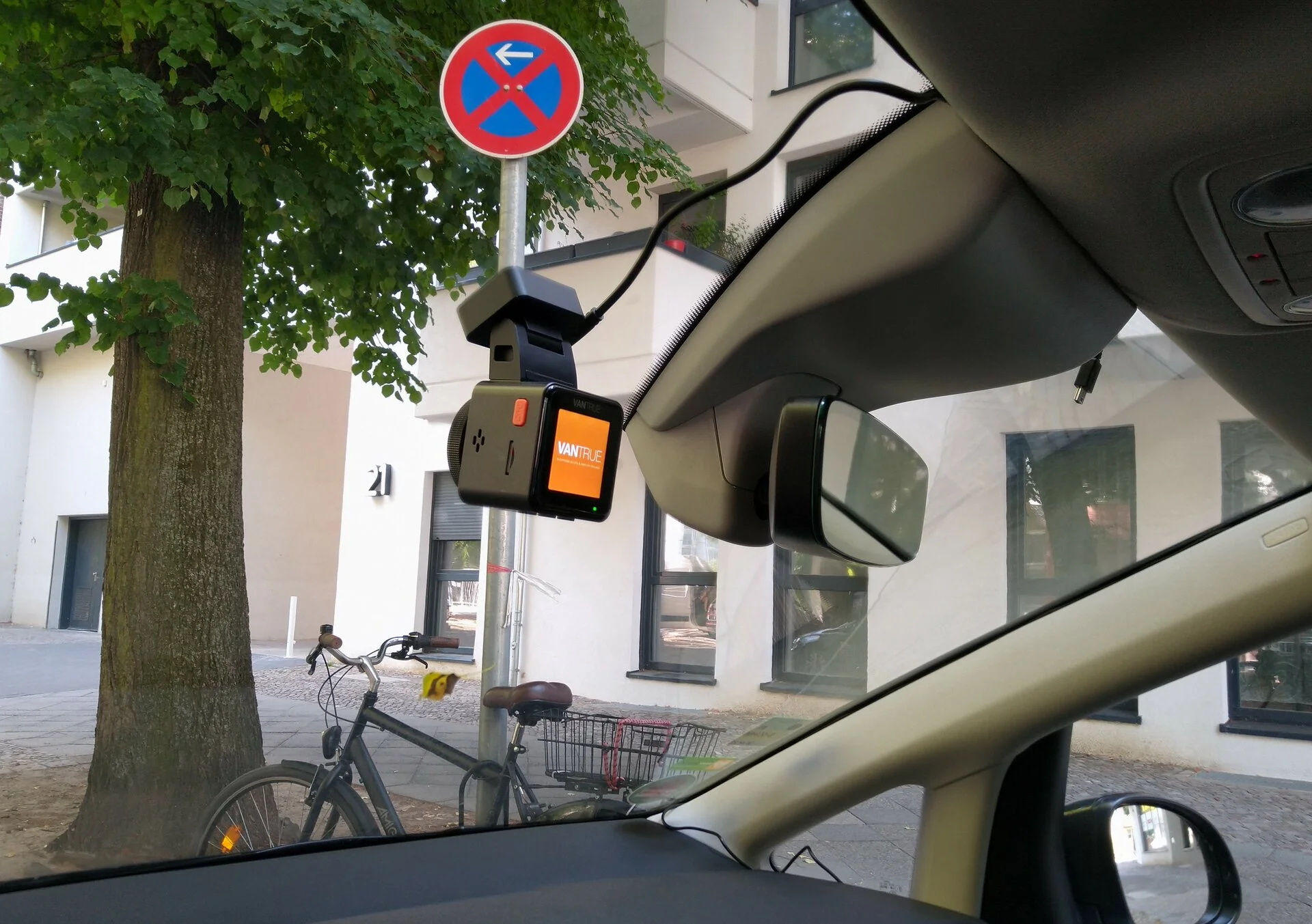

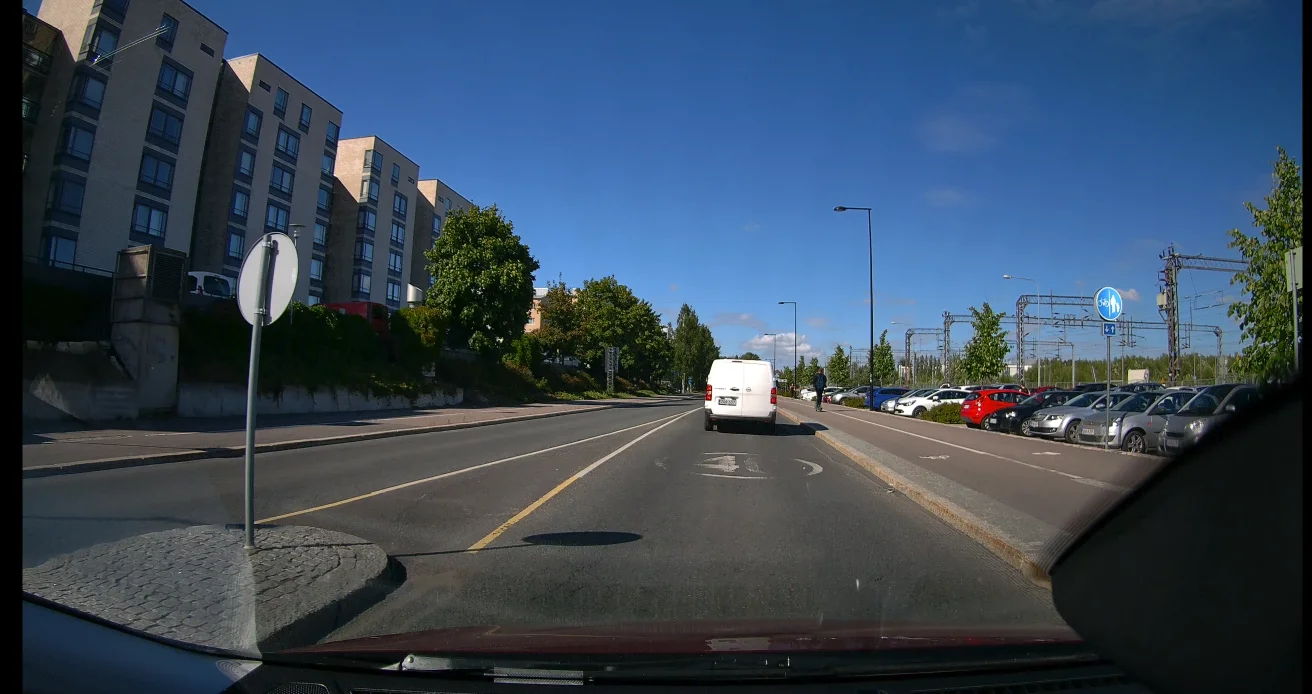

Is it possible to mount the suction pad onto the the grey shaded area behind the mirror on a Honda CRV?
Maybe.
It depend on how it is made, in my car i have a grid pattern ( seem like leftovers from the traditional dot pattern seen on other cars )
Anyway this are on the inside of the glass but are fairly smoother even if you can also feel it is uneven, so i have actually been able to put a suction cup mount there, and not have it come off every 1 - 2 weeks.
But i must admit that i do recommend against suction pad when it come to dashcams.
Dashcams today also come with a static sticker pad, you can use if you do not want to stick camera to the glass itself, but these do require clean / and even glass surface, so i have not tried those on my dotted area.
But on clean glass on the windscreen, or my living room window where i also static test cameras it work super well ( you can see this in use in the pics above #2 from the right )
I don't mind the sticky pads on the shade area even if it is a little harder to remove there, most of it you can roll off with a finger, and some solvent can take the rest if need be.
I have been sticking cameras there since 2012, and i did also in the end have to do a major cleanup there as left over residue meant cameras had a problem staying on, i used knife ( pocket ) to scrape off the worst bits, and then something called speedy 500 from the firm Kent, this is a anti glue solvent i accidentally had at hand.
Other things can of course also be used

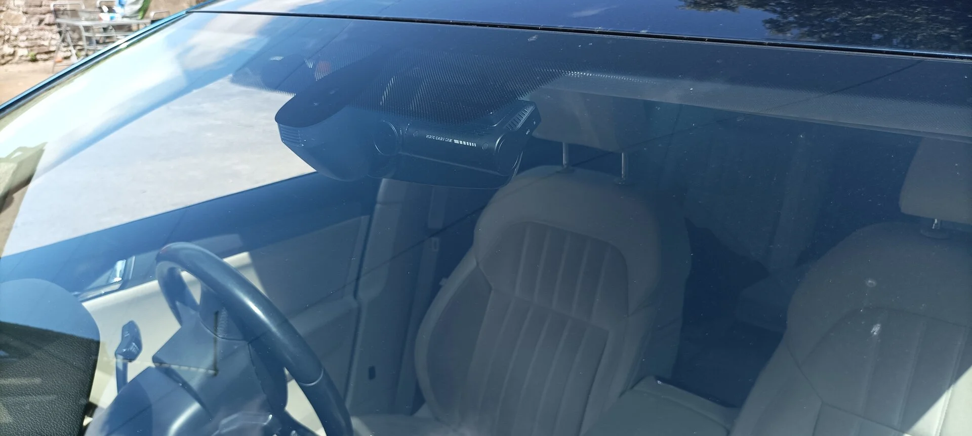

The middle of the front windshield would be the best position to mount the dash cam. Where you can get the maximum field of view, and less distraction when driving your car.

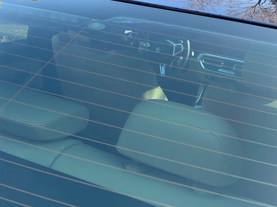

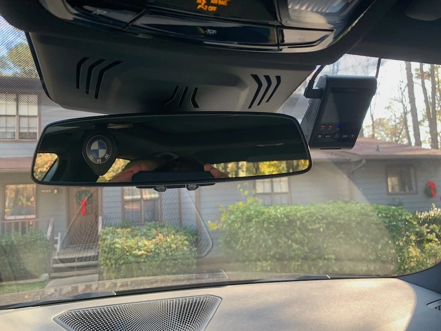

Viofo A229 Duo - Cellink Neo - 2022 BMW M340xi
This is the first dashcam I've owned or installed. The scariest and hardest part was gathering information specific to my car and trying to grasp, in the abstract, how everything would work. I'm extremely grateful to all the good folks here and at BlackBoxmyCar who patiently answered all my newbie questions. Additionally, I found information on the web specific to my car.

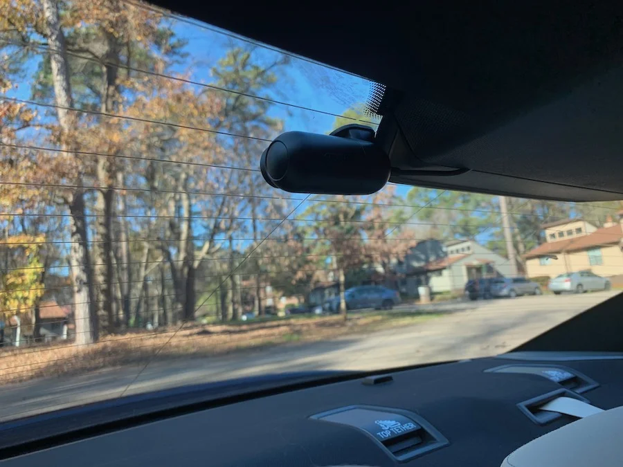

The Viofo A229 is powered by a Cellink Neo Battery located in the trunk (boot). The Cellink is charged from a connection to the fusebox, also in the trunk (boot) that powers off about 7 minutes after the car is turned off. With a power cable and a rear camera cable running on adjacent sides from the front to the rear, all cabling is 99% hidden. I was amazed that I accomplished this on my first try!

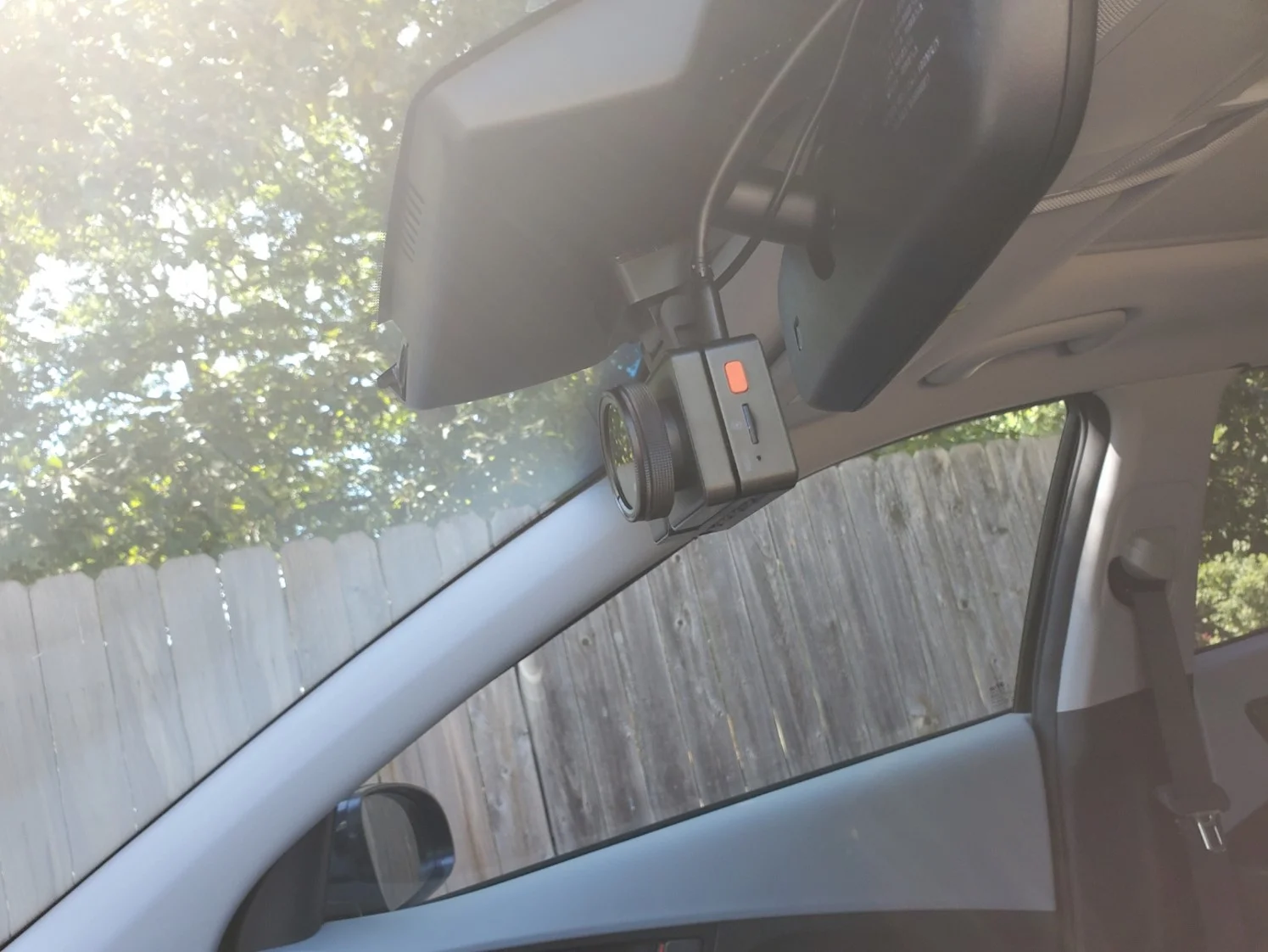

Front Camera:
I could have hidden the front camera behind the mirror, but with this location, it's much more accessible.
Rear Camera:
The rear camera was originally mounted higher (more stealthy), but I was getting an antenna wire at the top of the frame. You'll notice in the video below that there's still a fuzzy horizontal line in the frame. I could not find a location that would eliminate that.
The Viofo A229 menu, through the front camera or the wifi-connected app, is very useful for making adjustments, downloading videos, and turning parking mode on and off when it's needed and when it's not. The Cellink Neo's Bluetooth app is also very useful to check the battery status and charge level.

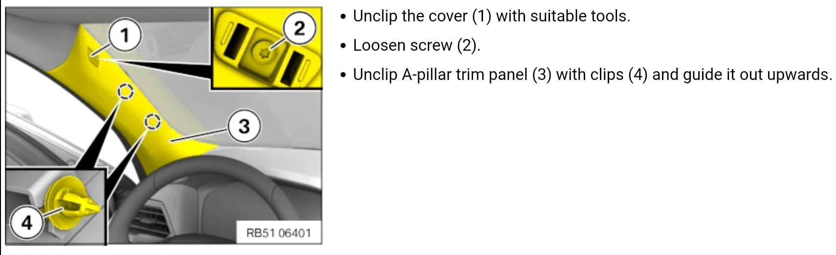

Nice installation job. Looks like a G20 BMW can you describe how you got your A Pillar off and routed the cable in back of the airbag? Thanks
Remove the clip labeled “air bag”, remove the torque screw. I didn’t completely remove the trim. I just popped it out enough to route the cable behind the trim and above the air bag.
