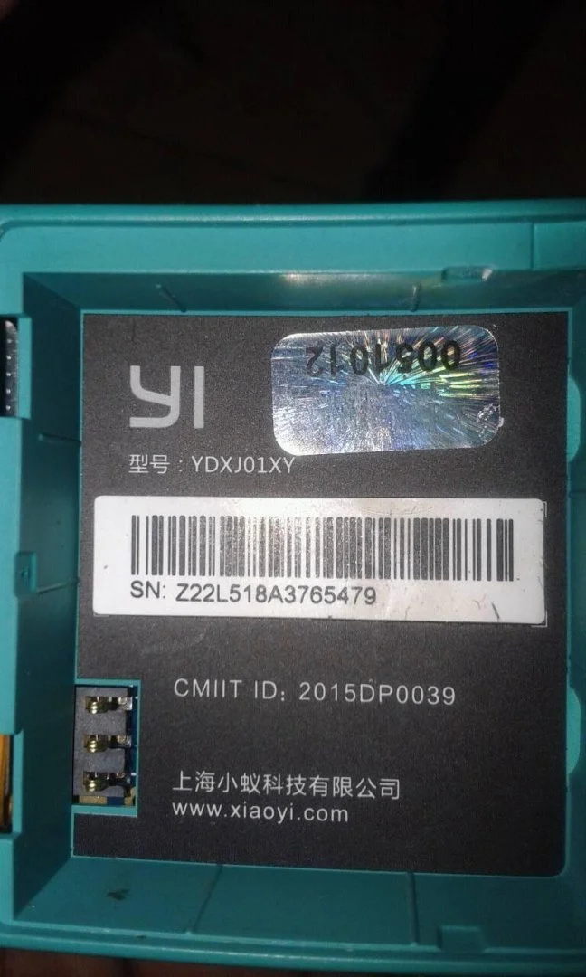

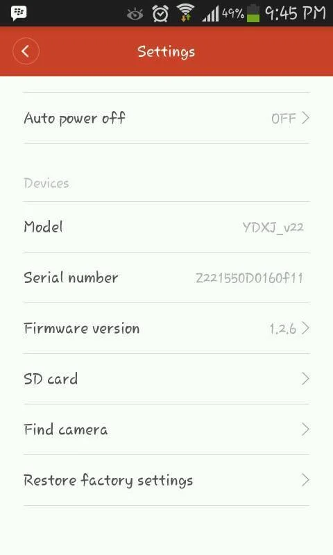

i have problem the SN in FW and behind baterai is different.
and if i use it for a few minutes suddenly brick then soundly beep beep make me crazy.
if my xiaoyi can run normally, i will donate.
AFAIK there was no 1.0.0 for L models. And all i have is on the mirror site...
This is very strange, if i were you, i would use the "ELF debrick" trick and hardflash the Z22L firmware (if you are not able to flash the L version directly).
Ofc. only if you are 100% sure you have L version, which - according to your sticker - you do.
PS: i also checked the barcode against the printed serial, it is a match...
i already do flash using directusb ambarella then elf brick like cruz post.
i download file elf fw 1.2.6 22L in cruz's post but i get sn 22.
i think it's wrong file.
do you have file elf for 22L?
