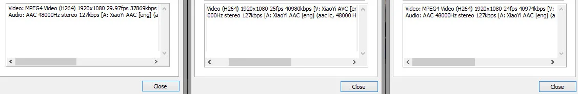

I made some tests and I can confirm that the values for NTSC are applied to PAL counterparts.
The one that influences 25P is 30P and NOT 24P (which is available in both NTSC and PAL modes correctly, being a movie format and not a tv format).
So, as an example, to raise 1920x1080@25P the right string is
C05C30D6
Curiosuly, same bitrate (here is 40) gives different values for each resolution, with 30P being the lighter as shown in the screenshot.
