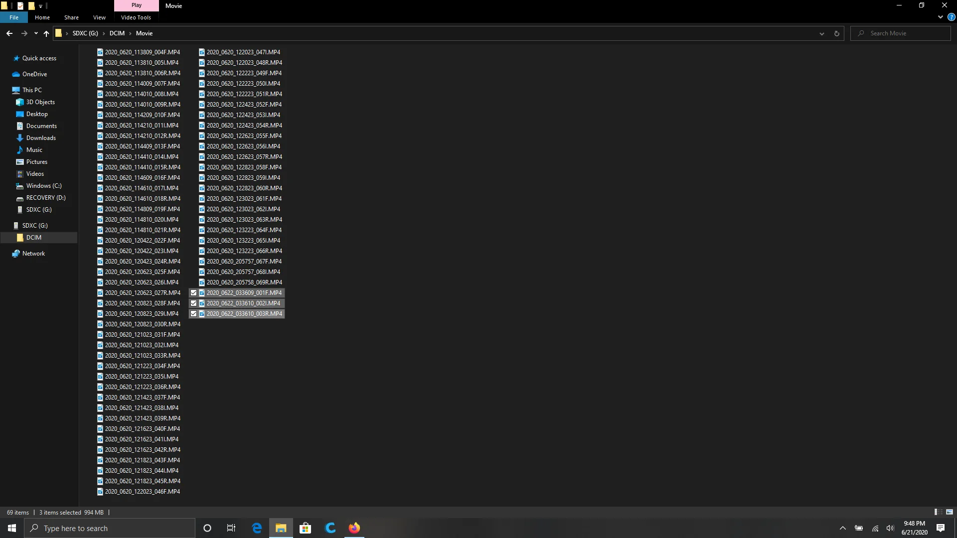

I hope I don't cause more confusion after the already confusing last two postings I made. The card was actually formatted and started clean before my last trip (initially I thought I didn't). The picture shows all the recordings of the trip I made to the store yesterday (Jun 20) but the very first 2 minute clip from each camera (the start of the driving session) are placed it the end because the error on the date and time. So the camera never stoped recording but I know it still a huge issue...
So in your case, the camera tacked on an extra 2 minutes to each file, as a result of the 2 day jump in time? Mine simply halted when it got to those files. No tacking on, simply the camera beeping, and a failure to record.
No. The first recording segment is the one that got stamped with the wrong date and time. Therefore they where moved to the end of the list.

Ok. But then the question remains, did you format the card or did you let the erroneously dated segments remain? In my case, these segments remained (didn't think to format card), causing a conflict when the actual date arrived. Meaning the camera didn't know what to do so it stopped recording since two files couldn't occupy the same name.
Card was formatted.

Card was formatted.
Ok. So that's why you didn't experience the same naming conflict I did. Under normal operating conditions, the camera never has to worry about the same day occuring twice. Unfortunately, with whatever firmware bug exists, the camera ran into that very scenario when I didn't think to reformat my card.

Date and time got corrected in the on-screen watermark stamp but the filename cannot be changed or corrected itself once it is created.
