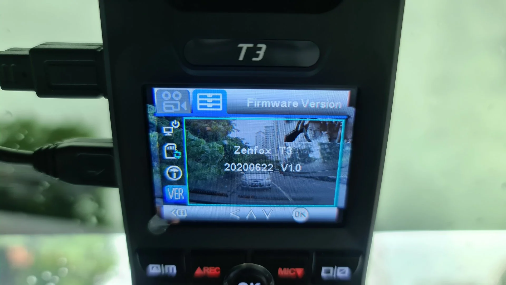

I've pretty much given up on this camera being SLIGHTLY reliable with its current iteration. At the very least, a firmware update is desperately needed in hopes of fixing the two major outstanding issues. For the second time that I've noticed, the T3 jumped ahead 2 days and stopped recording. I came out to my car to hear the camera beeping. Lo and behold, there's a huge gap between 22 June and 24 June. I also took pictures (not taking video) of the camera blinking when it stops recording. Look at time stamp on camera and you'll see it moving a few seconds and of course recording light is off.
1. Heat Issue Shutdown
2. Clock moving forward 2 days causing camera to have naming conflict or simply stop recording
View attachment 52288View attachment 52289View attachment 52290

A. I came out to the car and as pictures show, the recording button was blinking and camera auditory alarm was beeping.
B. I can't figure out if the camera stopped recording, even though the warning sound was beeping and record button flashing.
If the red buttons are flashing it should not be recording, this camera seem to have a steady LED light to indicate recording.
