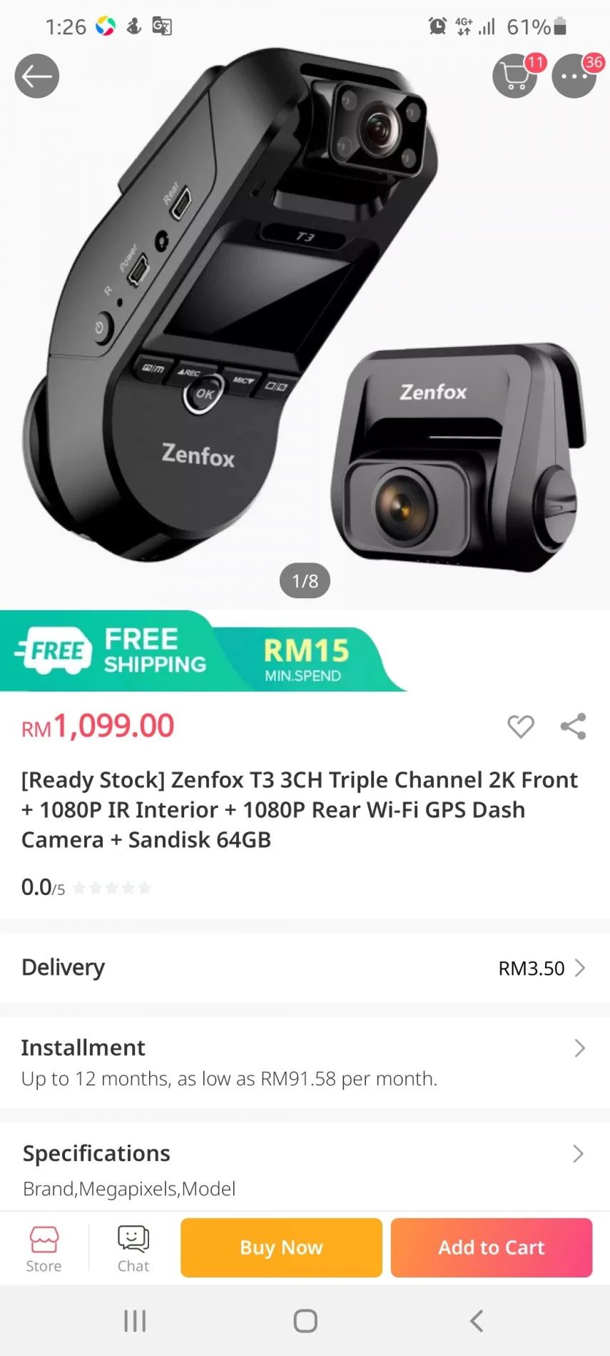

Some sellers has already brought in and selling the T3 in Malaysia
Now that's a huge problem.....The T3 isn't ready for the mainstream market, and these early Betas may leave people with the wrong impression of the ZenFox company.
