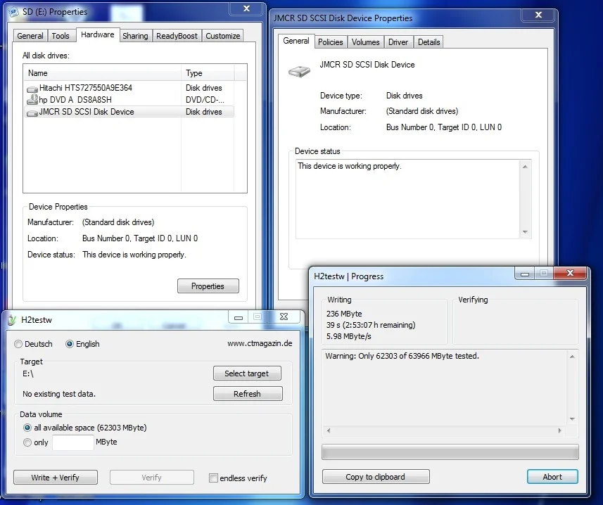

Testing on my laptop (HP Probook 6460B) with adaptor so it can go in the SD slot. Attached is a screenshot of the Kingston 64GB. Tested my 32GB SDHC Class 4 at the same time and that gets 4.8MB / sec write speeds.
What do we think, fake?

Wont know if it is fake until it starts verifying and finds that what it wrote is not where it wrote it.
The write speed is rather slow but that could be the computer.
Personally I'm thinking their fake, as mine don't have the pink band along the bottom like the one in the attached pic from Amazon direct. My 32GB card (which works fine) does have the pink band. Time will tell as the test wont complete until much later tonight so i'll check it tomorrow
