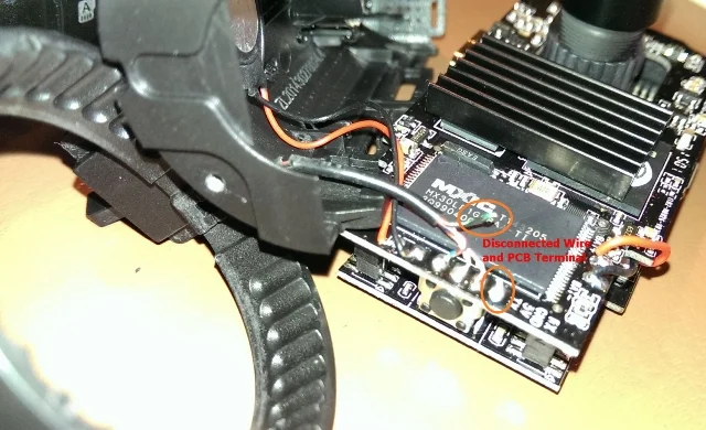

Yeah, sure it's hard and this shall not be an accusation but I will still call it "abuse" since thats not the primary purpose of the shield.
Using the shield to spread the heat is better than using no shield - I'm not even questioning this.
Btw my assumption about RX/TX from first picture was right, I got a shell:

I'm not really sure if the shield does a good job as heat sink. Heat sinks are all about spreading, the shield doesnt offer too much area for the heat so spread in comparison to a real heat sink
Also, it is never a good idea to attach one heat sink to two chips.

I'm wondering what the logic was not to use an actual heat sink as in the 0806? Perhaps you guys who did the tear-downs can say whether there is as much available room for a heat sink in the 0906 as there is in the 0806.
CPU side of the pcb is the lower inner side, so no room for a heat sink
I see, thanks for explaining. Now I'm wondering why it was located on the inner side of the pcb where there would likely be less air circulating?

I have literally no idea of circuit design but they probably had a reason to do this (without thinking about heat problems)
Maybe @Rayman.Chan can say why

Why "abuse" and not "smart" to use for two purpose?
yes it is used as EMI shield and heat sink at the sametime.
this shield is not regular Tinplate but Copper-Nickel Alloy which is more diathermanous
