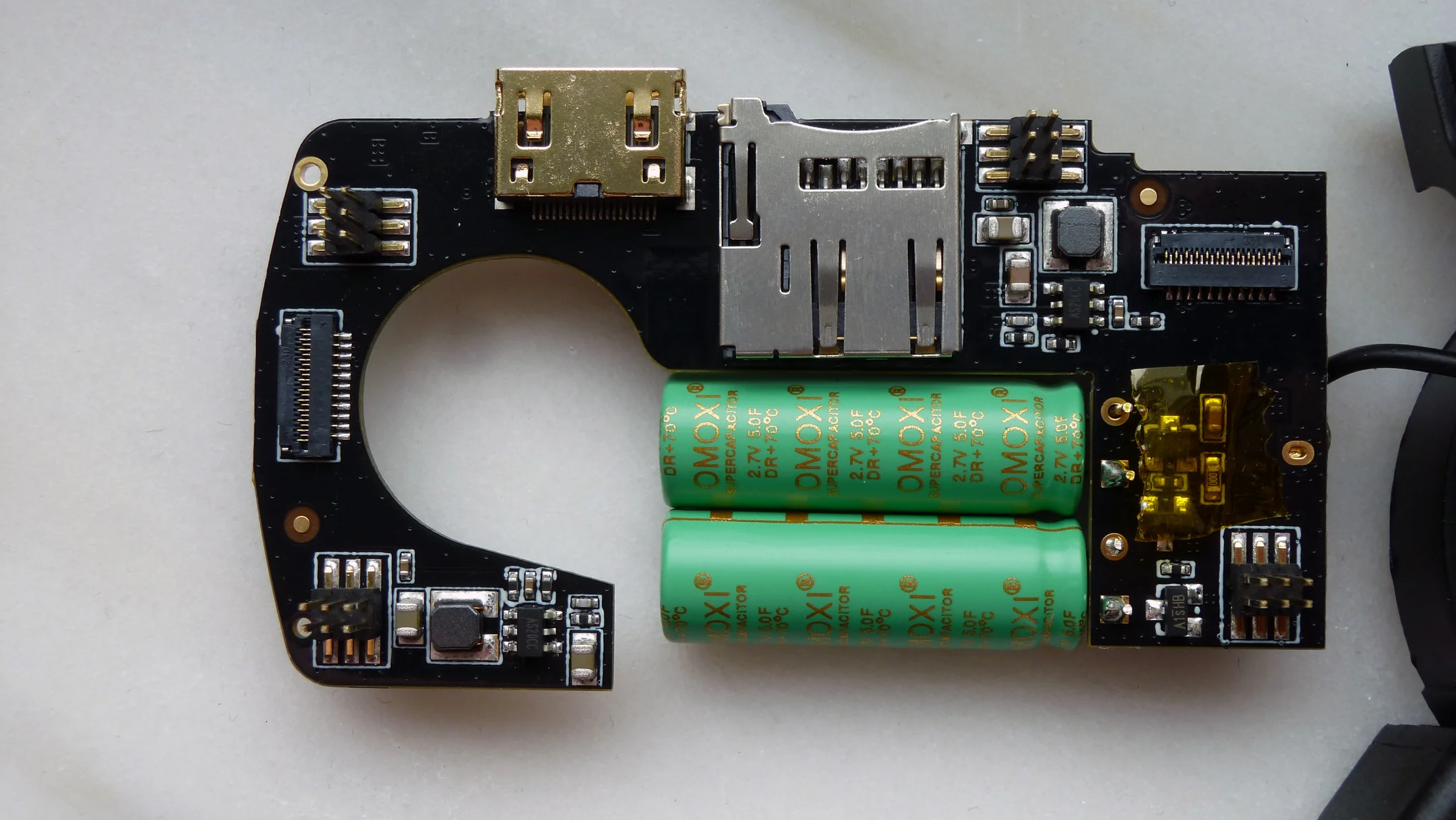

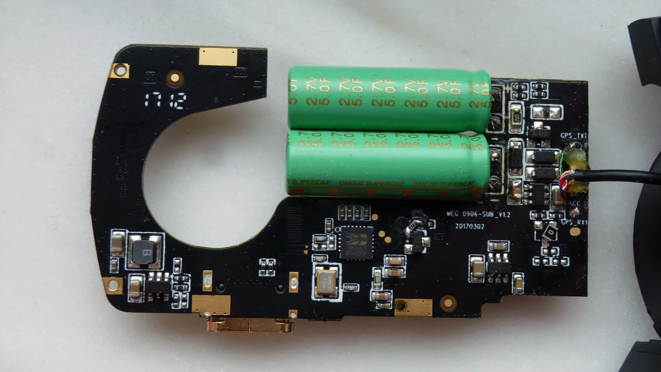

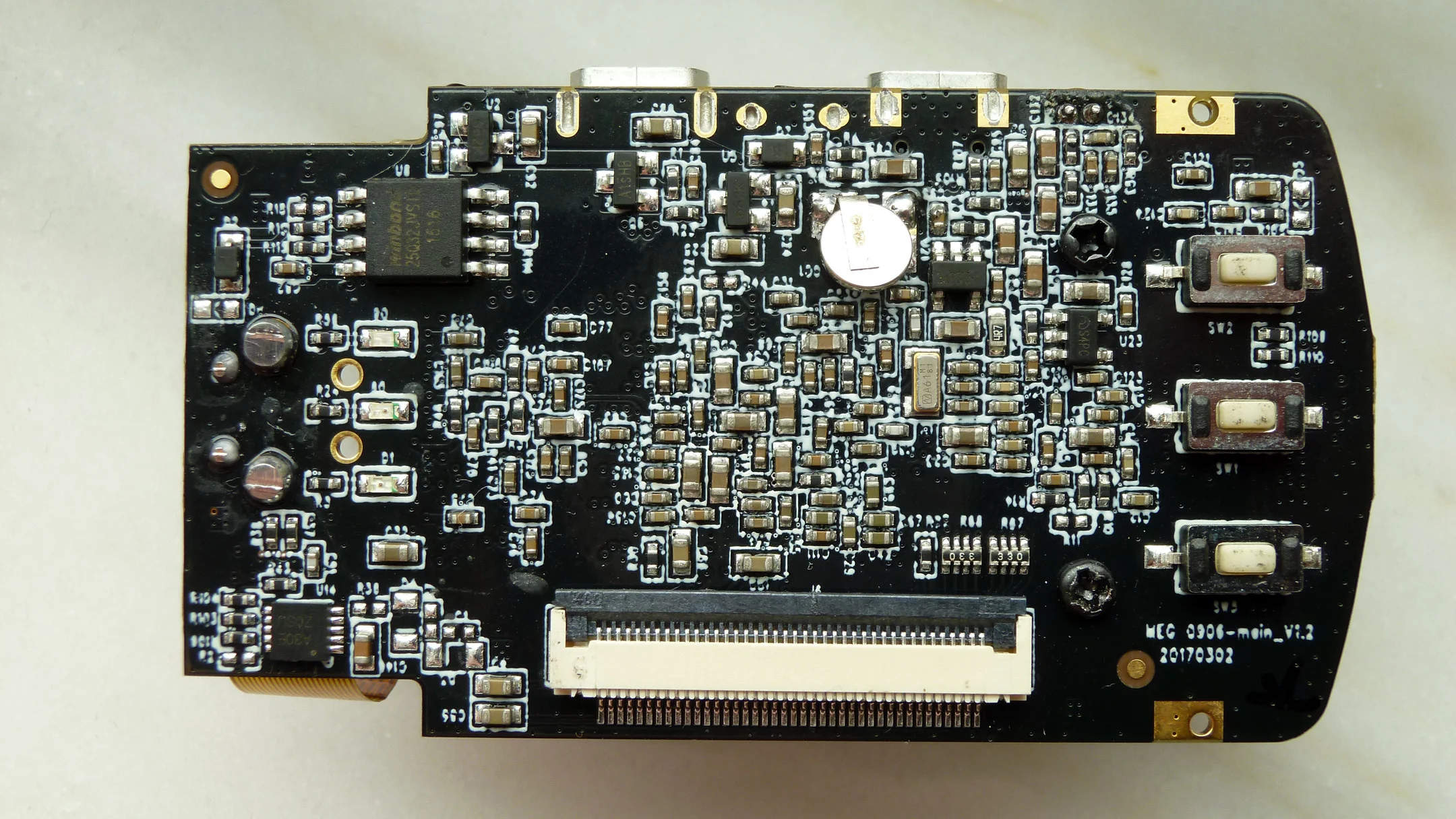

Since I'm trying to solder an uart port to the 0906 I had to disassemble the 0906.
It's considerably harder disassembling this (and tearing apart the main and hat pcb) since there are now two flexcables which interconnect the pcbs..
Couldn't verify the UART port neither, I have a guess but I'm not going to try it yet

Thanks for the photos. I am going to have to disassemble also to replace faulty microphone. Is the disassembly the same as for 0806?
For the housing, yes I think so. Separating the pcbs is a different story
Looks a bit like Tobi@s's microphone was soldered by hand? Maybe yours wasn't soldered successfully and just needs resoldering...
Or maybe they forgot it!

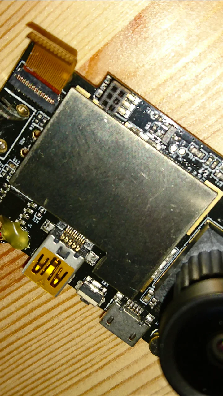

Hmm, that looks more like an EMI shield. Is it actually attached to the CPU and RAM?
Yes it is an EMI shield or something like that but I think they abuse it as a "heat sink" since there was thermal paste on RAM, CPU and the shield
Could be useful as a heat spreader so that the heat isn't concentrated at one point.
Not sure an EMI shield is really required just there.
Why "abuse" and not "smart" to use for two purpose?
I'm not really sure if the shield does a good job as heat sink. Heat sinks are all about spreading, the shield doesnt offer too much area for the heat so spread in comparison to a real heat sink
Hard to build small, with lot of space.😕
