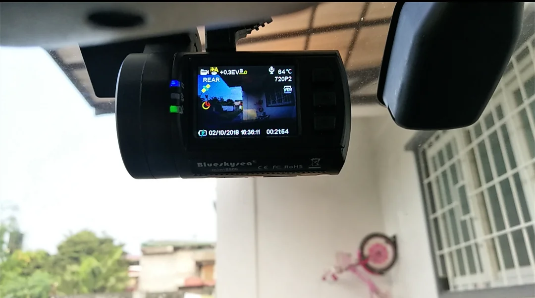

Yesterday I transferred the rear cam to the front windshield to have it act like a taxi cam. It was working properly when I checked it after the install. But today, I have something strange that came up during parking mode. The screen shows Rear but the video showing is from the front cam. The resolution is 720p2 w/c is parking mode resolution. This has happened 2x already. One is after lunch, before starting the car, and checking the cam just now. The cam returned to normal 1080p30+1080p30 after starting the engine the first time it happened.
