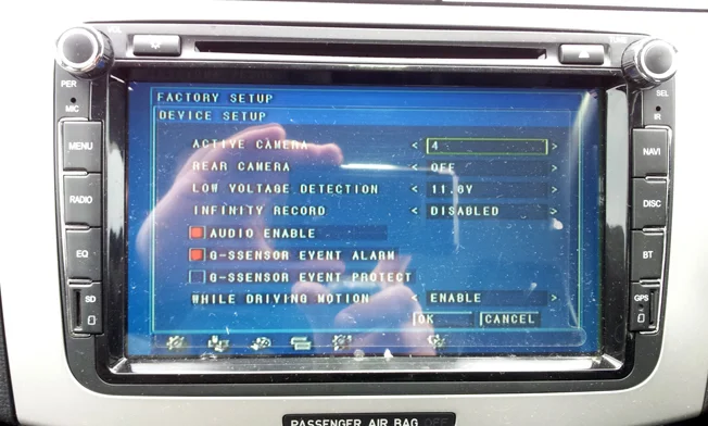

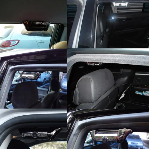

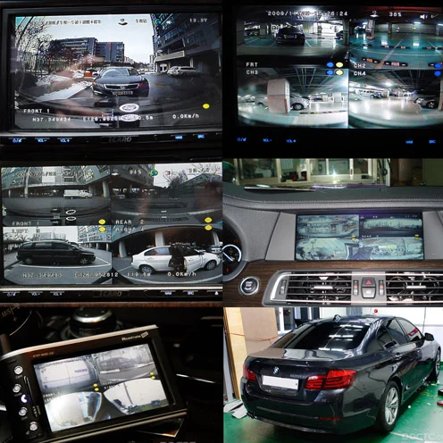

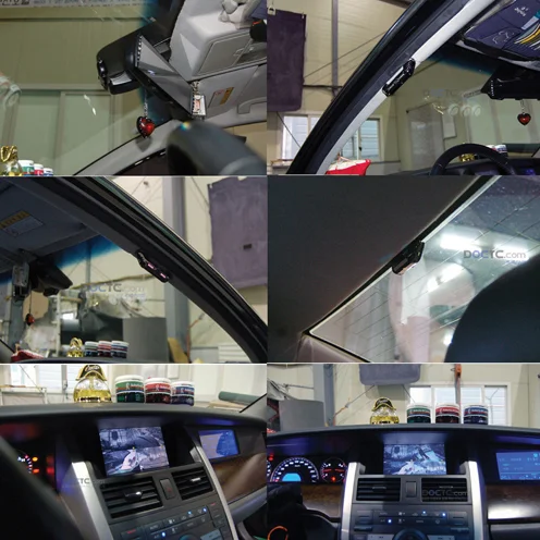

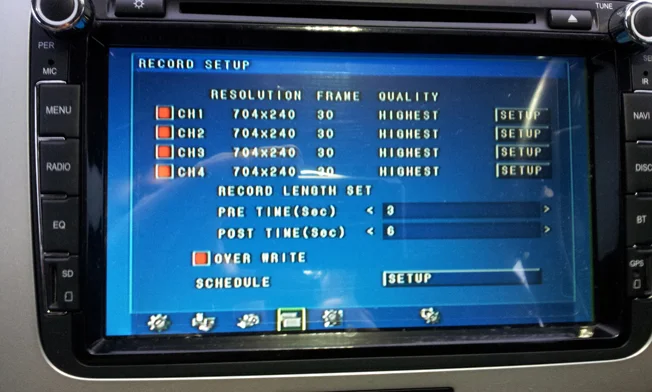

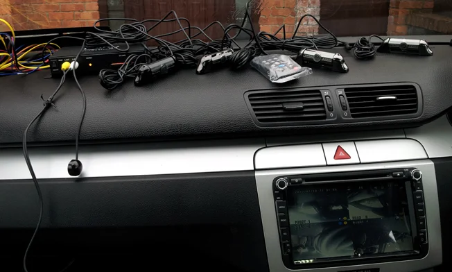

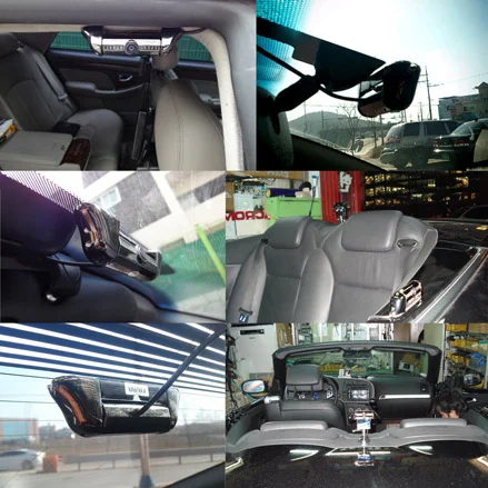

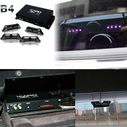

Dedicated parking panorama view 360 degree dash cam systems would not be much help for side "action" proof, especially for something like "flash-for-cash", because those camera view angle is horizontal wide, but not vertically, so you will not be able to prove that 5 metre away car was flashing you. Best cheapest DIY would be as "sludgeguts" said 4 Mobius, or even better: front / rear proper dash cams and sides use Mobius, mounted inside car, top part of the door frame.
My iCaro B4 system has very discrete solution, but as we all know, these days most 4ch systems produces VGA or or better ones D1. iCaro B4 is almost 3 years back system, back them for 4ch was state of the art. By firmware and functionality it is still one of the best from all retail available car 4ch dvr / cctv systems.
