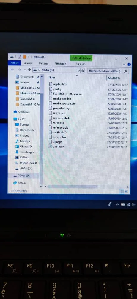

Thank you Aspide76, there is 14 files on the FW 1.0.1
When arrive to step 5. i press on the 2 bottons, but i have only the screen opening with 70mai and after it goes black screen, what i am doing wrong ??
Envoyé de mon M2007J1SC en utilisant Tapatalk
Attenzione. No format sd with PC.
Sd in fat32 format in 700mai.
Cancel files in sd and past 14 file.
Inviato dal mio SM-G973F utilizzando Tapatalk
Yes it's what I have done, first format the SD in the DVR, delete all the file once on the PC, put the 14 files, but not working......
The SD card is a Kingston 32gb, today I will receive the Samsung Evo select 128, will try again
