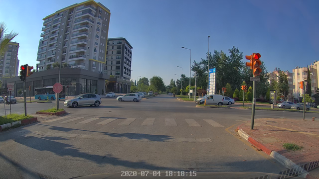

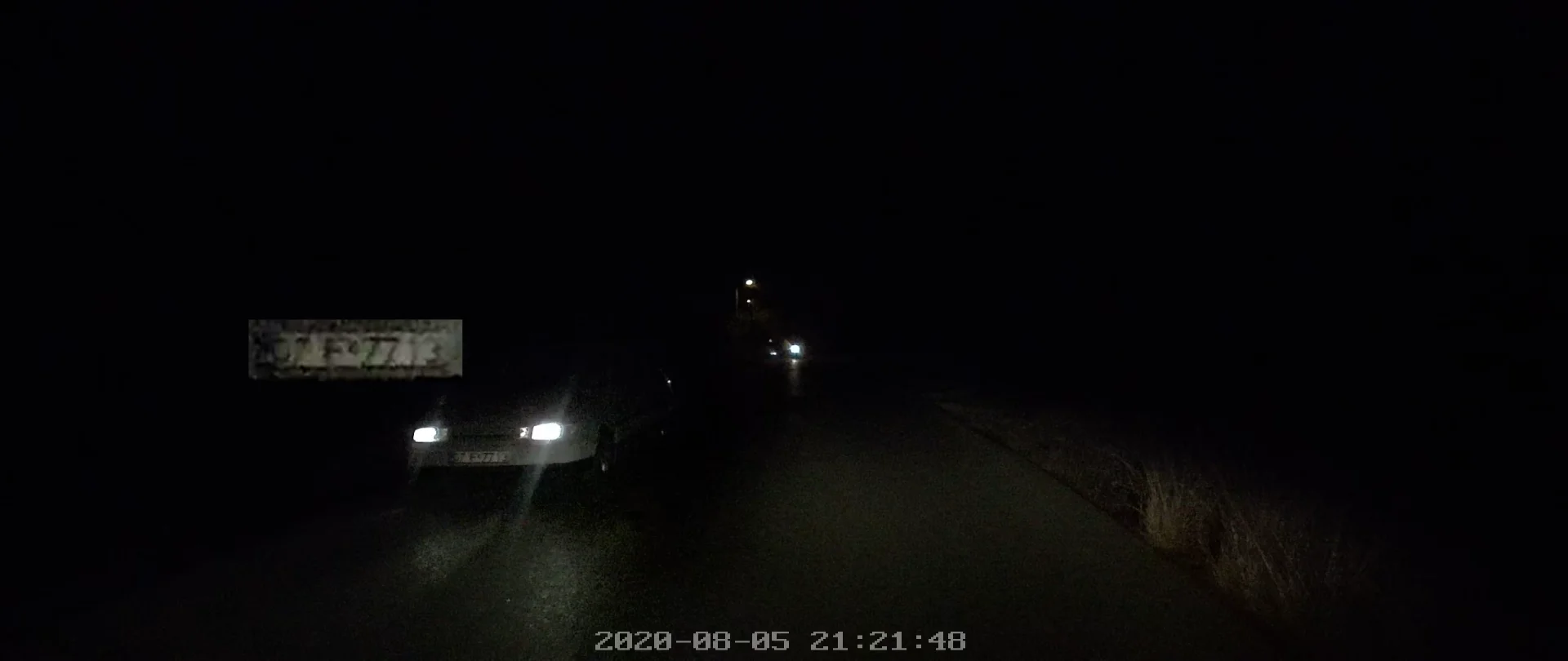

Image looks great. You have picture with night mode? Will be available for your CN translated version? Or you can port option "time-laps" from cn to en? Many thanks

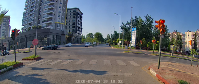

What kind of picture would you choose here? Full of art value or one with the most possible (did my best) license plates and road signs readable? My strong belief is that each and every dashcam footage should be concerned as a set of highly important data bearing stills...So best not up grade then?

I can't shoot any side-by-side videos as I've got only one cam. Any other comparisons will not be 100% unbiassed. Moreover I don't drive at nighttime.Oh typo, please share the video
It is hard to say from the images. I cannot see any differences in quality. My opinion is that the better view is in the order you have posted them in. ie the top one the better. It covers less sky in it. It does come with a small amount of distortion. I expect that is a hardware issue.What kind of picture would you choose here? Full of art value or one with the most possible (did my best) license plates and road signs readable? My strong belief is that each and every dashcam footage should be concerned as a set of highly important data bearing stills...
