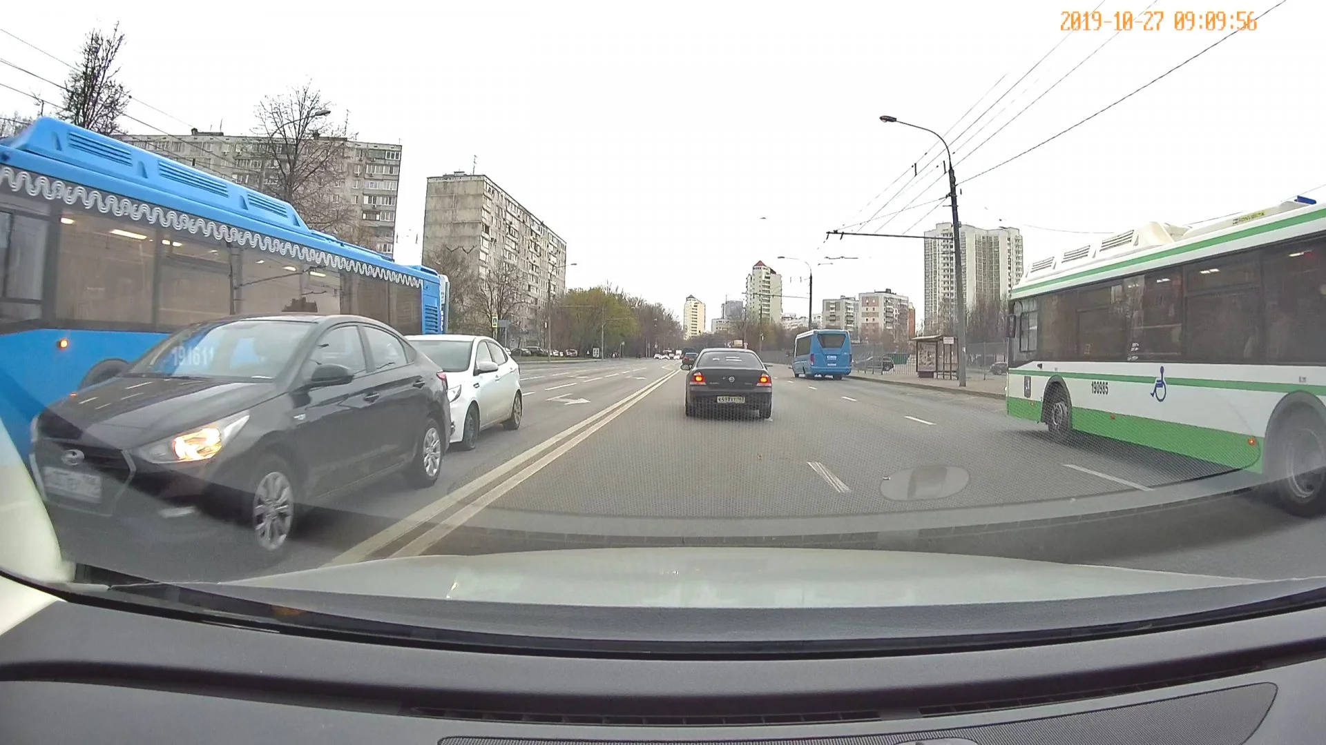

What about motion blur and license plate readability? No flicker means that exposure is 1/100s or longer...
I never noticed motion blur. Can you post a video with motion blur? However flickering is a problem for me since now it gets dark early
Take a look at the license plate of the oncoming black car on the left.
I see! it's a bit blurry but it would be very hard to get items on the ends of the wide view lens to become sharp... It has to do with the wide angle I noticed even my gopro does that.
