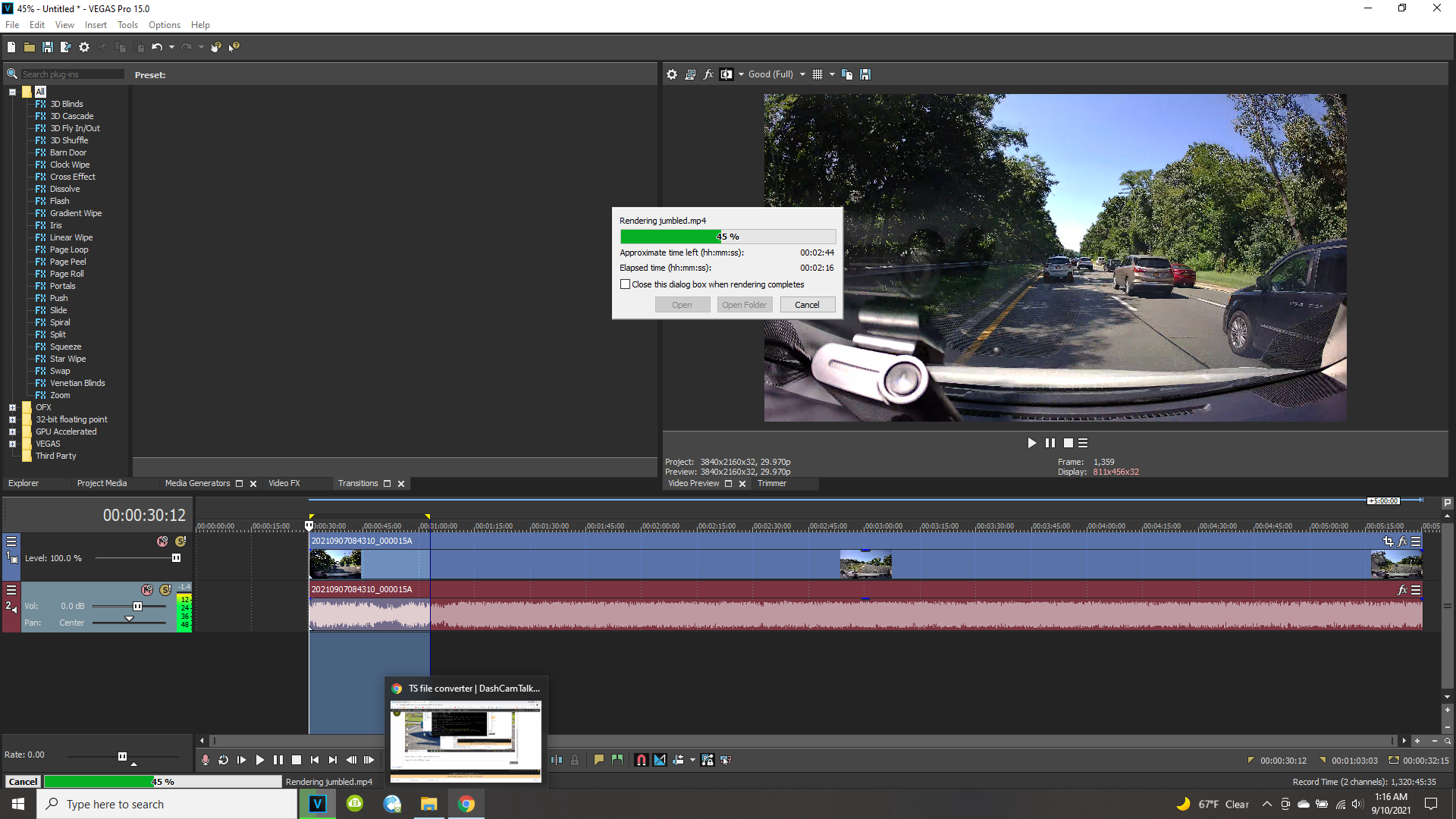

OK, with Nigel's help, we were able to get FFmpeg to work 😎
Converting the TS file to MP4 was quick and easy, however, I still have an issue.
I'm able to play the file as an MP4 using my player (WMP Classic), but when I add it to my editor's timeline (Vegas Video), the audio sounds all jumbled up
Here's what a short clip sounds like

OK, Nigel hooked me up with an updated version of ffmpeg and it now works great πŸ™‚
Makes it MUCH MUCH easier to edit the TS files, so I'm hoing to have more B4K content
I think the main issue was that the Vegas video editor couldn't cope with the mono audio, so the updated ffmpeg batch file now re-encodes the audio into stereo while just copying the video not re-encoded. So there may be some small loss of audio quality while the video is original quality, at least until Vegas starts working on it. The ffmpeg batch file also joins together all the file segments you give it so that you only need to load a single mp4 video file into the editor, and it still works pretty fast.
