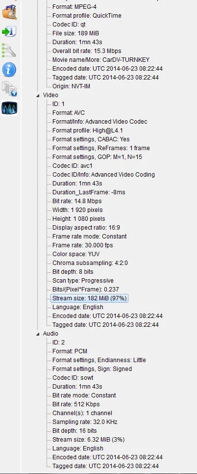

Guessing it's VBR in that case? Interesting how the second road clip is 15.25Mbps whereas the very first clip posted was 12.45Mbps in the daytime though - maybe a change of settings too or is it possible one of them has been re-encoded?
New FW B40.20140523.001 has 15Mbps bit-rate. Probably chris-s forgot to mention this ;)
here is data specs:
