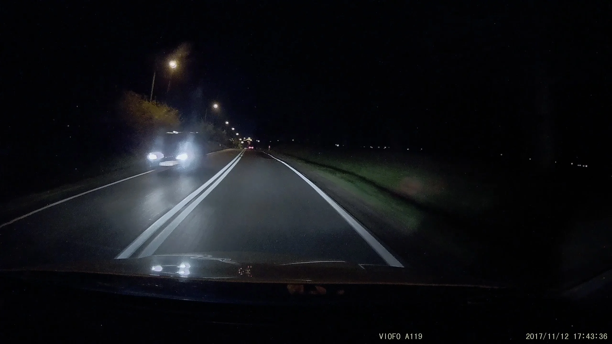

For some entertainment and a win when the A119 does exactly what I hope it would check out this video of a near head on with a Semi.
