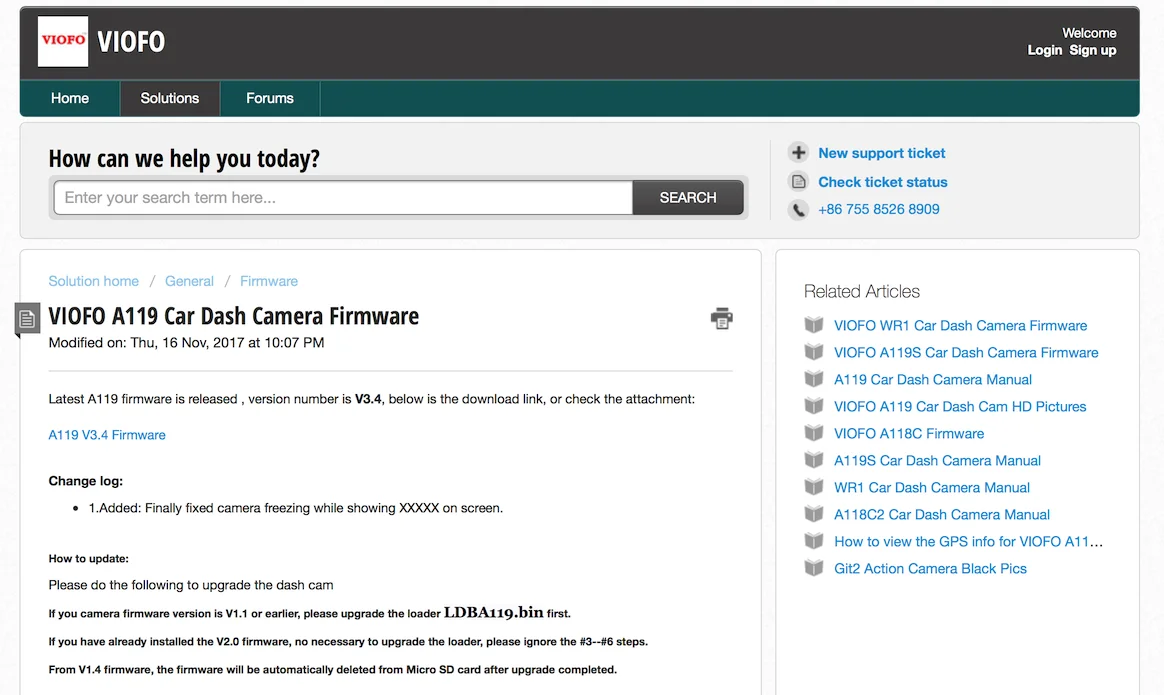

please help! i am trying to update firmware on A119v2 from v2.02 to v3.3. But after copying FW file, my camera will not power up AT ALL. Here are the steps I've taken:
1) While connected to a wall charger, i formatted the sd card (64gb lexar 633x)
2) plugged the camera into my computer & copied downloaded FW file to root of camera (upgrading from v2, so i did NOT load LD file)
3) unplugged camera for several seconds
4) when i plug the camera back in, REC button flickers VERY briefly, & then nothing else happens. no power, camera does not show in file explorer. I tried plugging it in to wall charger & same thing - will not power on. (it has been plugged in for over an hour now, & still nothing happening)

Will the camera power on without a memory card inserted?
I am using the cords that came with the camera. Everything worked fine before I loaded the new firmware.
So you have tried both cables? With and without a memory card inserted? With a known good USB wall charger?
I would format the card again using the Viofo GUI Format tool found HERE. Then copy the .bin file to the card again using a card reader. Double check you have the correct firmware file. Then place the card back in the camera and power it on. Be sure to use a USB wall charger during the update (not your computers USB port). Update should take less than one minute.
Sounds like your first attempt failed for whatever reason.
I did everything you said, formatting with the Viofo GUI tool, using a card reader, plugged the camera back into a good Samsung wall charger. I'm loading what is now v3.4 from the Viofo website. It still won't power up. I found a 16GB card I had laying around, tried everything with that one as well. Nothing. So I'm pretty sure it's not the memory card. I only bought the camera in May (it's a v2), now wondering if i need to see about replacement??? Or is there a way to try to reload FW v2 back to it to see if that works? (I don't know how to "downgrade")
Downgrading is the same as updating. You just need to download the older firmware.
